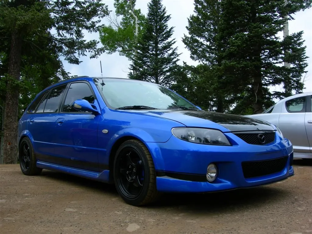

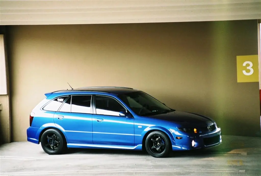

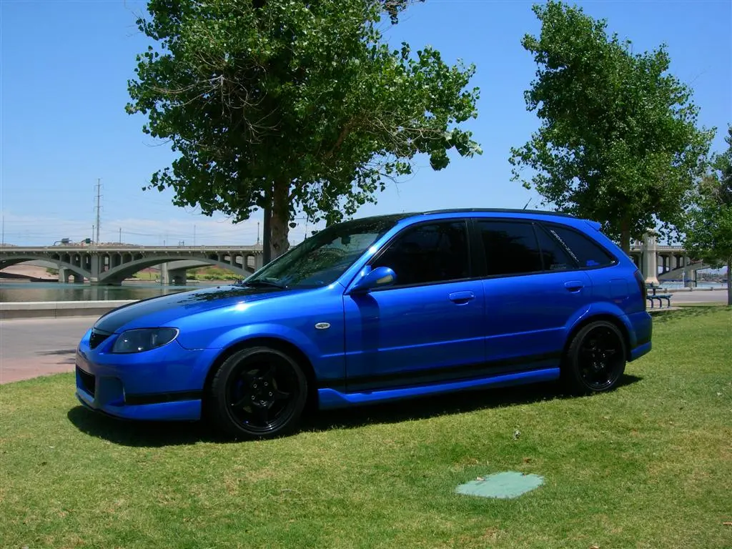

There is a difference in the bumpers.
The MP3 and the MSP (03 & 03.5) share the same bumper. It doesn't have any side markers. The MP3 and the 2003 MSP have the exact bumper with the windsplitter. The 03.5 MSP was a mid year refresh eliminating the fogs and adding a lower lip and deleating the windsplitter.
In the attached pictures you can see the side marker in the P5 bumper and without the sidemarker on the MSP bumper.
My front end is a 2003 MSP bumper and windsplitter.
