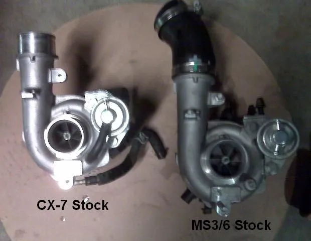

Very bad picture is attached for reference....it is hard to tell the but the MS3/6 turbo on the right is slightly bigger!

EDIT: that picture is kind of leading, as the turbos are at different angles, making the CX7 turbo look smaller from the outside. This is not the case. The difference lies on the Compressor wheel and housing inlet.
