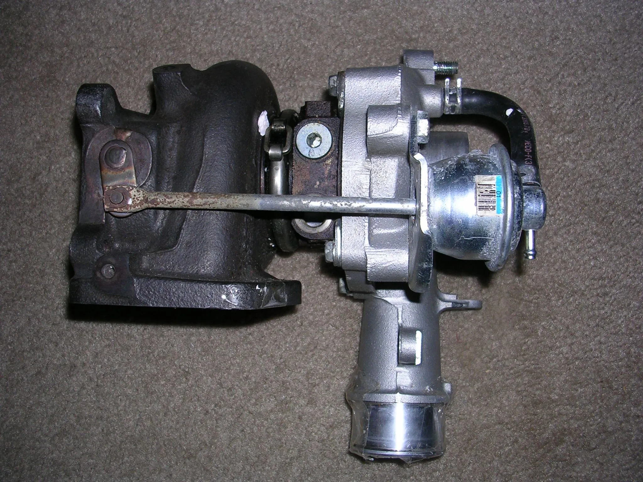

Maybe I missed them the last time I was back there, I'm pretty sure I didn't see any. I looked closely but, I was looking from the top not, the bottom.
Threads wouldn't necessarily make it adjustable either, even if they are there. It might just be the attachment threads for the end, iow, you could loosen it a bit but not tighten it, which is what you'd want, I think.
no threads - bout the only thing you could do is drill another hole at the end - but it's all a bad idea - you can get great control of it thru the electronics and that's the easiest way to go -

no threads - bout the only thing you could do is drill another hole at the end - but it's all a bad idea - you can get great control of it thru the electronics and that's the easiest way to go -[/QUOTE]
thats probably where i saw it was "adjustable". not mechanically but eletronically.
