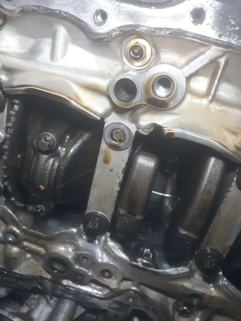

by the way, after almost 9 months I'm get troubles again. This time broken piston and and damaged cylinder block... I did not expect it from Mazda 6. I had 70.000 km only, and now I need to replace engine completely... so, have no words
Upvote 0
Wow, sorry to hear that:cry:
How many km between oil changes for this vehicle? Not trying to say this is your fault - it's just a question that's very typically asked for any internal engine failure.
