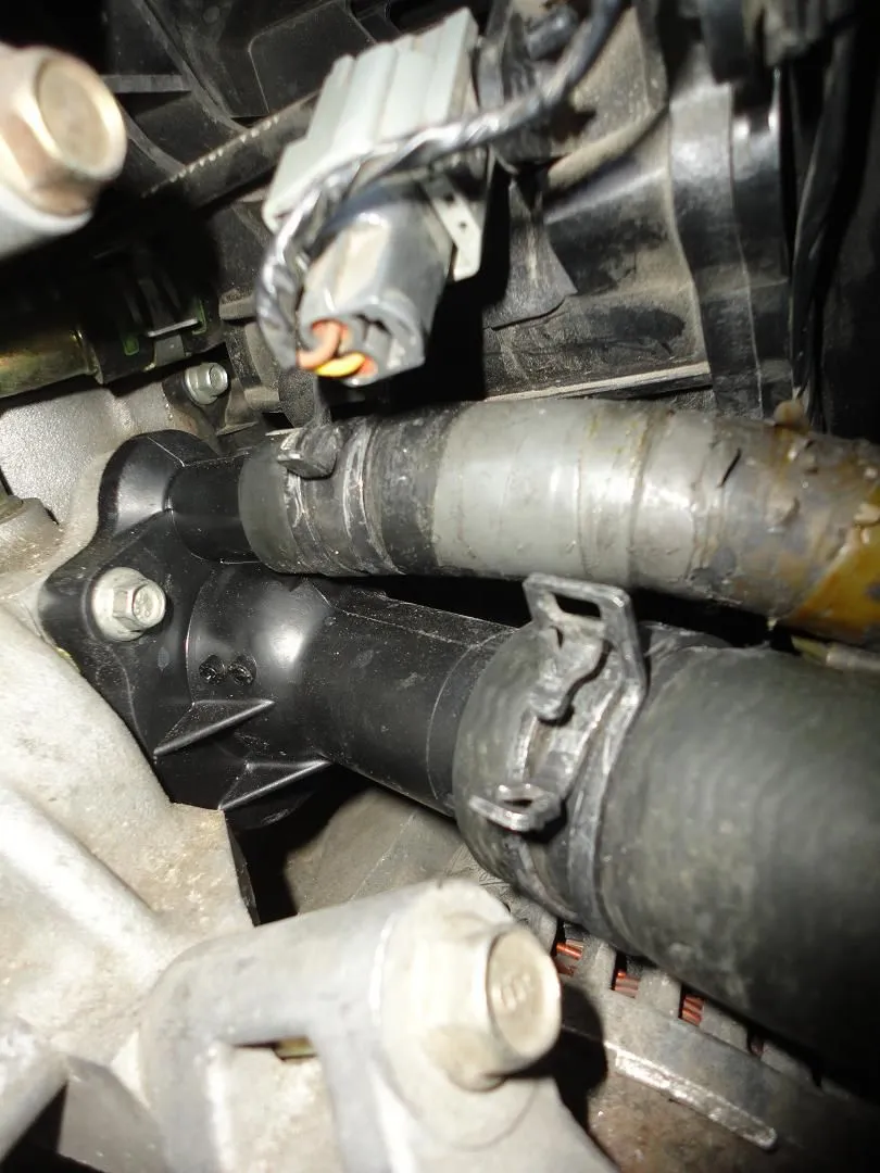

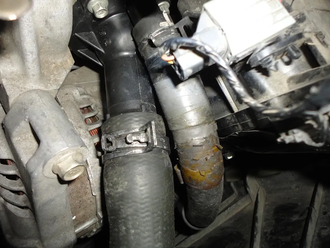

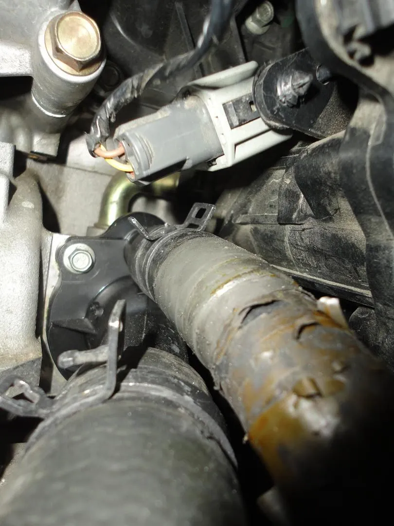

I was getting occasional CEL P0126s, so I decided to replace the thermostat on a 2006 Mazda5
1) Drained radiator from drain hole on driver's side of radiator - a little over 1 gal of fluid
2) Removed overflow tank (empty & clean) and all hoses from radiator neck for hand access
3) Did not remove tensioner belt as in manual - not needed
4) Thermostat has three 7mm bolts - used 3/8 ratchet with 1/4 adapter & 6" extension - fit perfectly. Removed 1 bolt from top, 2 bolts from bottom.
5) Thermostat has 2 hoses attached - 1 large, 1 small - these are pain to get off. I traced small hose to engine - removed small hose from engine(don't pull off hose with face under engine & mouth open :-). With small hose removed, was able to bend large hose so that thermostat is under engine - then able to remove both the small & large hoses from the thermostat. Thishttps://www.amazon.com (commissions earned) would really help in getting off the clamps.
6) Note that markings on hose - align with marks on thermostat. Attach large hose to thermostat under engine, then small hose. Push thermostat back to original location.
7) attach small hose to engine
8) bolt back thermostat - 2 from below, one from top
9) hook backup hoses & overflow tank
10) flush radiator
11) refill radiator & you're done
12) check for leaks
I hope this helps someone - no pictures - sorry

Thanks for all the indications. Several Mazda fora show this as a(nother) common problem with 2006 Mazdas 5. Code P0126 came up about 4 months ago (a week after passing my emissions test ;) ) but since most of my driving is within the city, temperature wasn't an issue (after warming up, temp gauge was always in the middle), so I postponed the work. Eventually, I took a long trip and realized that long periods going downhill or coasting on the highway would lower the engine temperature critically so, it became clear that I could not keep procrastinating any longer. The job took around three hours of which almost one was used taking the damn hose clamps off. Space was really tight and tools (regular pliers, vise grips, etc.) barely fit. I was able to open each clamp with a vise grip and keep it open in place (I wasn't able to slide it back on the hose) while pulling each hose out of the thermostat. I took the big hose first and the small last. Draining the radiator, cleaning the coolant reservoir, removing the old thermostat and installing the new one, flushing and refilling the radiator, etc. was pretty straight forward. I didn't replace the little evil clamps (although I was tempted to throw them away and replacing with screw type clamps). But these original Mazda clamps have special dents/holes to open them and keep them open for installation. After the hose is in place you touch the clamp with a screwdriver and the clamp snaps close, pretty much like a bear trap so, watch out your fingers. I bought an aftermarket thermostat (Stant 48728) at my local Advance ( http://shop.advanceautoparts.com/we...nheit-stant_20480007-p?searchTerm=stant+48728 ) that looks better than the original part. It also seems that operates differently by regulating the flow of coolant rather than simply opening or closing. I disconnected the battery for a couple of hours at the end of the work to reset the engine light. It's been 2+ weeks since I completed this work and things are working perfectly fine. If I can get another 90k out of this thermostat it should be fine. I added pics of the evil clamps and the thermostat in its final position after replacement for reference.
