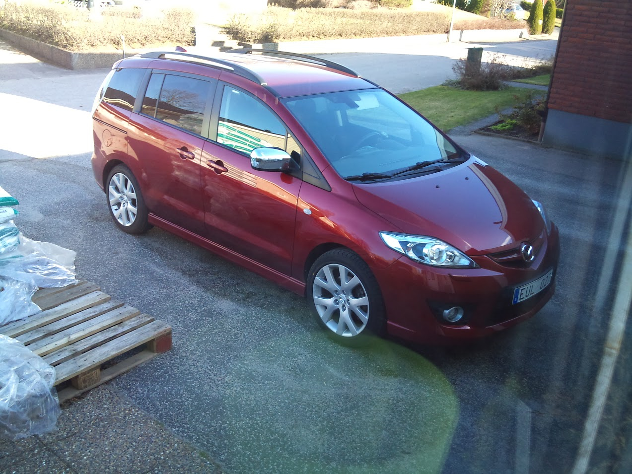

New rare wheels for me to day
5zigen 5ZR
17 x 7.5
ET 43
Fit perfect and don't touch with 4 passagers + oem wheels in car.

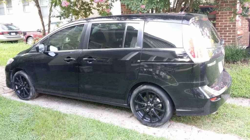

First time posting about my premacy/5 got some rx8 shadow chrome wheels for it today and here is how it currently sits
Only thing I would do dfferently is get slightly smaller tires. Its currently got 235/40/18 and on full lock they touch the plastic inner guard and sit about 1mm away from the strut. Might run 225's once these tires wear out
