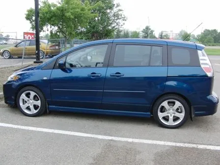

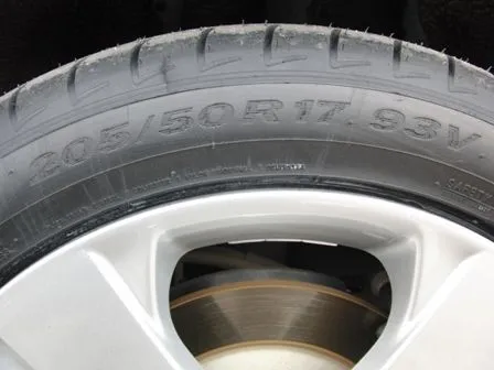

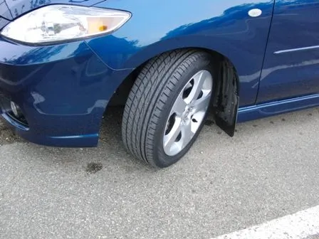

Here's what I have in case someone have them too.
I guess it is very low in the field of popularity.
Noticeable is the wider amount of rubber in the 'inner side' of the tire. You can find similar designs too in some Michellins. Could it be designed to suit the 'cambered' rear tires of todays cars?
Nitto NT850 205/50/R17

Do you know something about Westlake Tires? Because my Mazda Sevice Center offer them as replacements for the Toyos. Others that I've encountered are Sunny, Hankook, Nexen and Falken. Thanks!
How many K's on the 5 when you bought the Nittos, Skyhawk?
56000km.. The dealer report said old tire was still ok. (the toyo just reached the wear marker) if I'm not going on an long drive.. But we had to drive some 1600 km or so to edmonton and back.. So I wanted peace of mind.
I got mine from Kal-tire.
