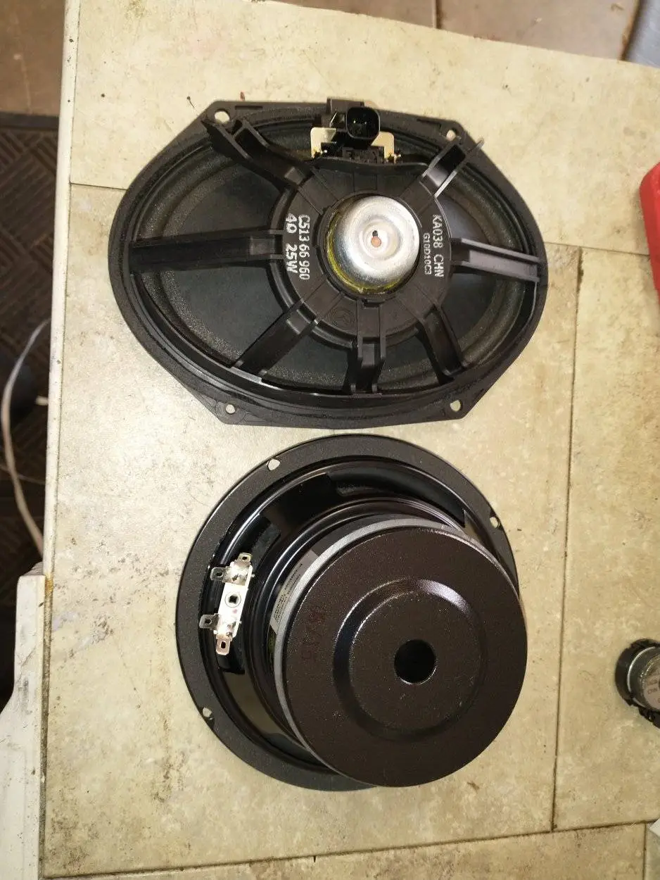

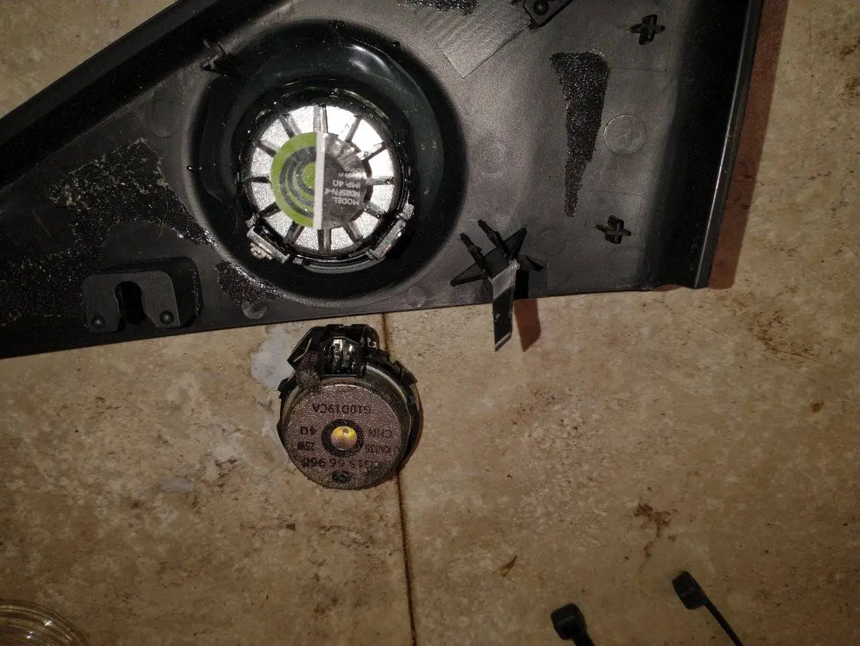

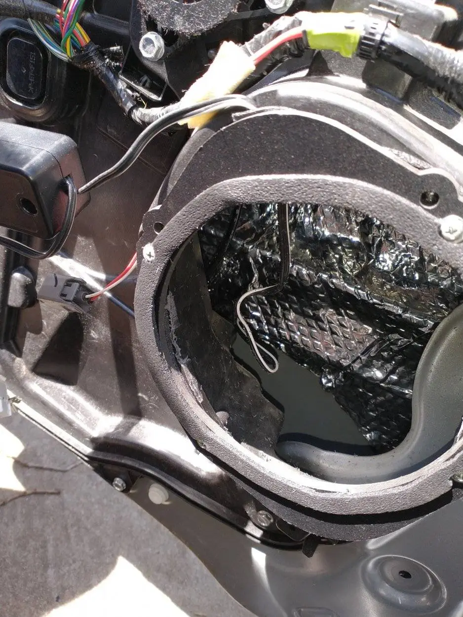

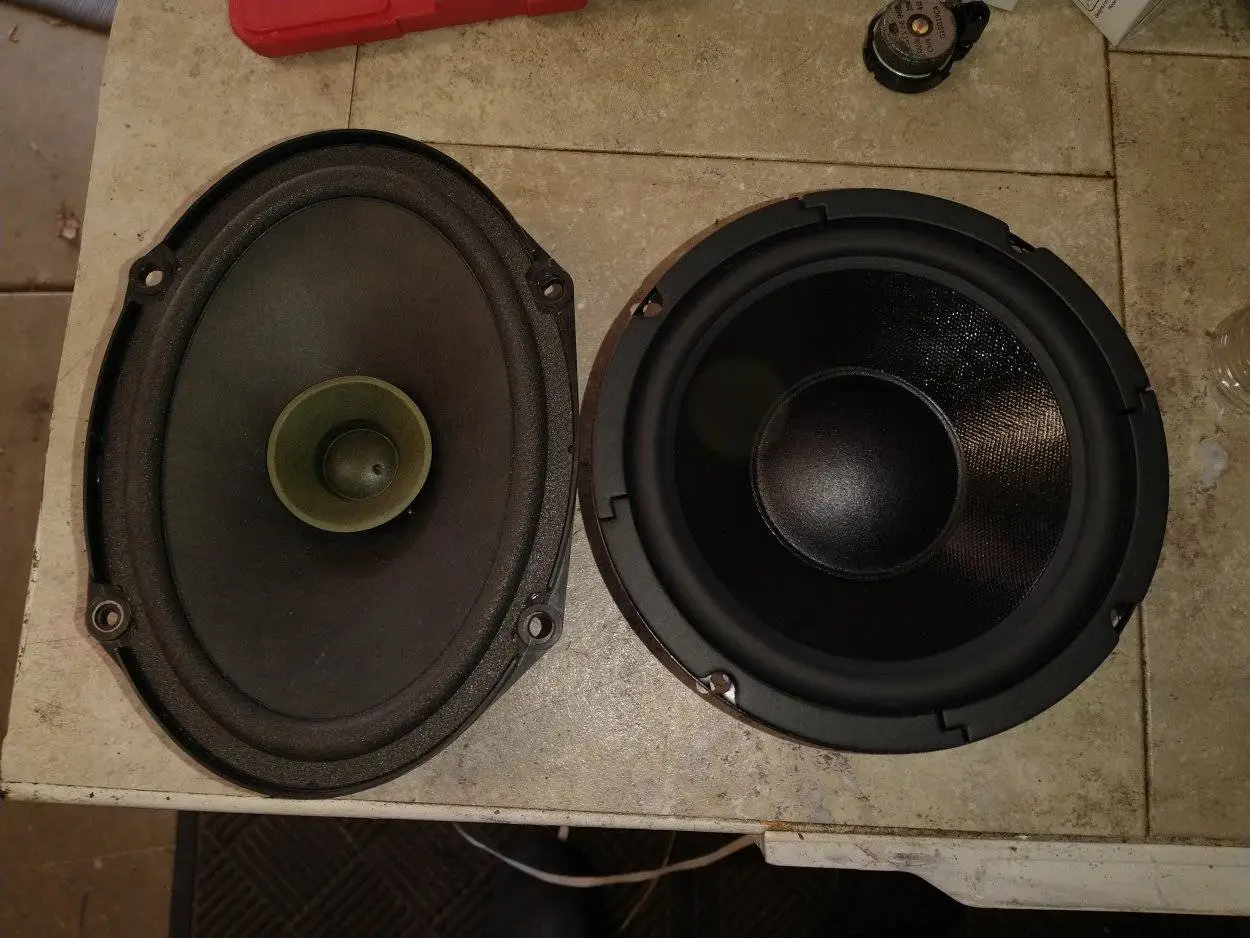

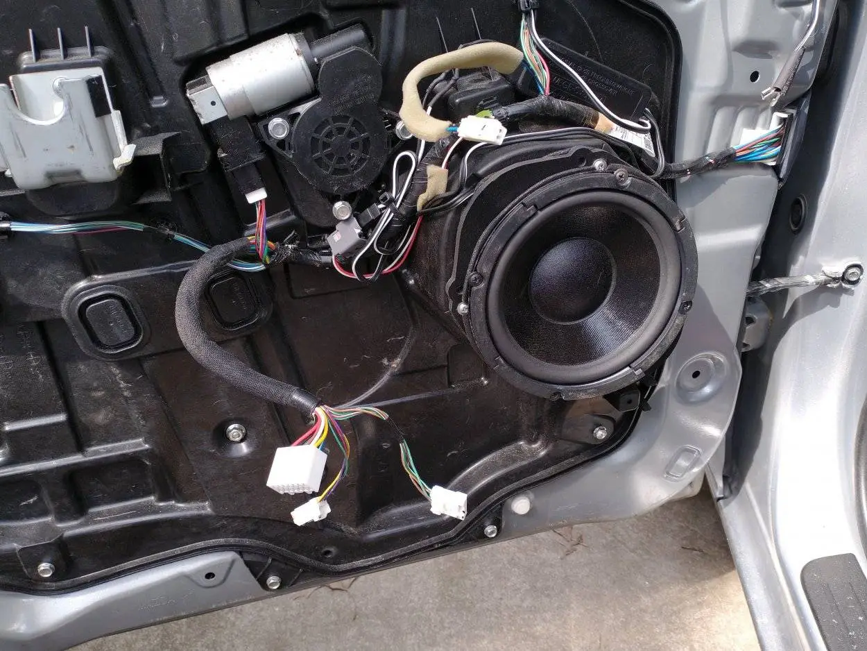

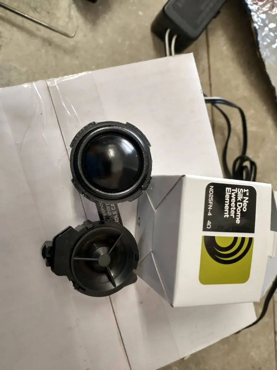

Upgraded the door drivers today with some very inexpensive Dayton Audio classic woofer and tweeters. The 6.5's are DC160-4's, and the tweeters are ND25FN-4's. Only $25 each! That's it! I had some MB Quart crossovers laying around, and used those. The 6.5's fit perfectly with some extremely minor trimming. A Dremel had it done in 60 seconds, it was just that minor.
The difference is nothing short of breathtaking! And I don't even have an amp on them yet!
While I was in there, I laid down a little Noico sound deadening, too.

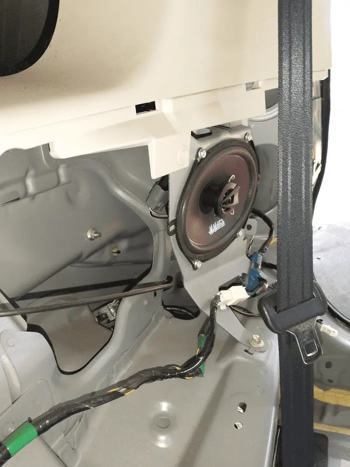

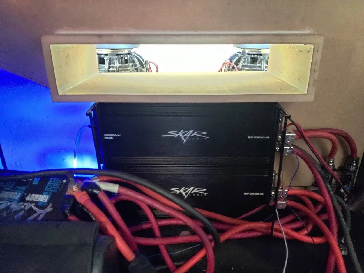

Deck is a Kenwood DDX-8706S, DSP is a Dayton DSP-408, amps are Kenwood KAC-M3004 on mids and tweets, and a KAC-M3001 on the subs. The entire car has been triple layer sound proofed. Killmat on the bottom, then a layer of Noico closed cell foam, and finally some Mass Loaded Vinyl on top.
You obviously see the front drivers, the rear speakers are Mmats 5x7 coax's that I picked up for $79/pr from the local car audio dealer. Subs are a pair of old school American made Rockford Fosgate Punch RFZ-1408's in a sealed box. Wait till you see how I did the enclosure! They have the exact amount of prescribed airspace, I kept the spare accessible, yet the box is completely invisible! I'll be posting pics of the final install in a few weeks.

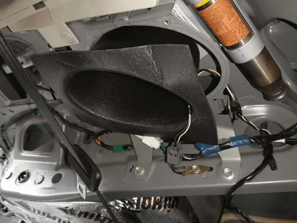

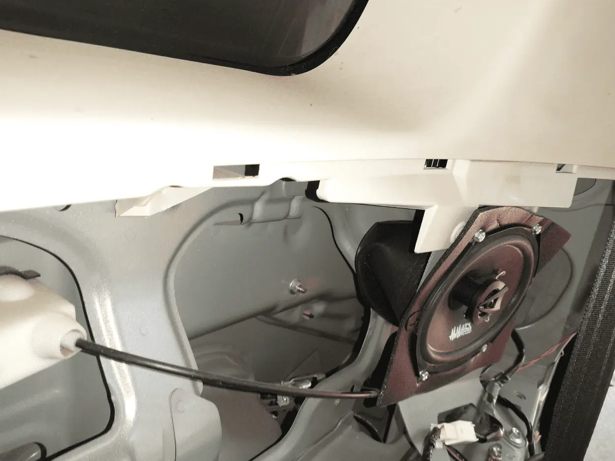

The rear speakers in our MZ5's are completely open to the air, both sides. That makes them absolutely not work. It's no different than just laying it on the back seat! Speakers only work when the back is isolated from the front. So, isolate them! XTC baffles are super cheap, about $7/pr, and will make your speakers sound so, so much better.
you took that much of the rear interior paneling off just to replace the speakers & add a plastic basket? *respect*
It's literally one single panel for that whole side. It's like 3 screws and 10 clips.
Besides, I was adding sound deadening, anyway.

Front speakers are easy as any car, get that inner liner off (screws on the inner handle and bottom of the inner pocket) and the rest is push pins and lift up and off... in a nutshell. Those lower speaker mounts are classic 5x7 with a hard plastic bracket that protects from window water above. Use metra wiring adapters, mights as well put down some deadening while your in there. For the tweeters, that panel just pops off and the tweeter has a single cap high pass. I just left mine disconnected and used a full range below.
