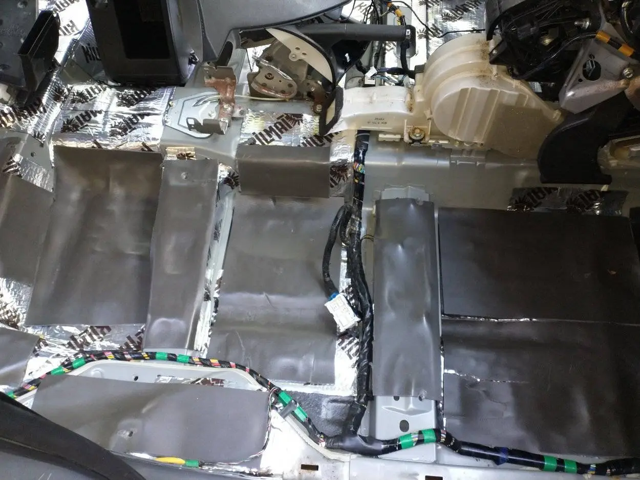

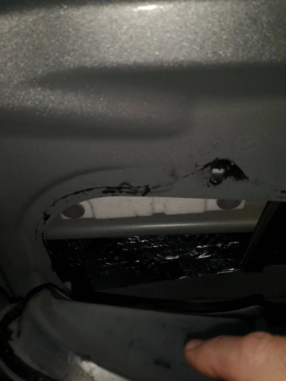

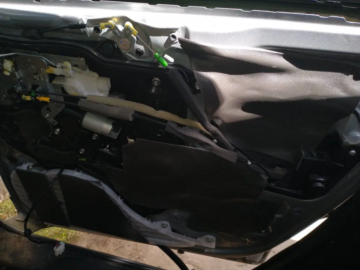

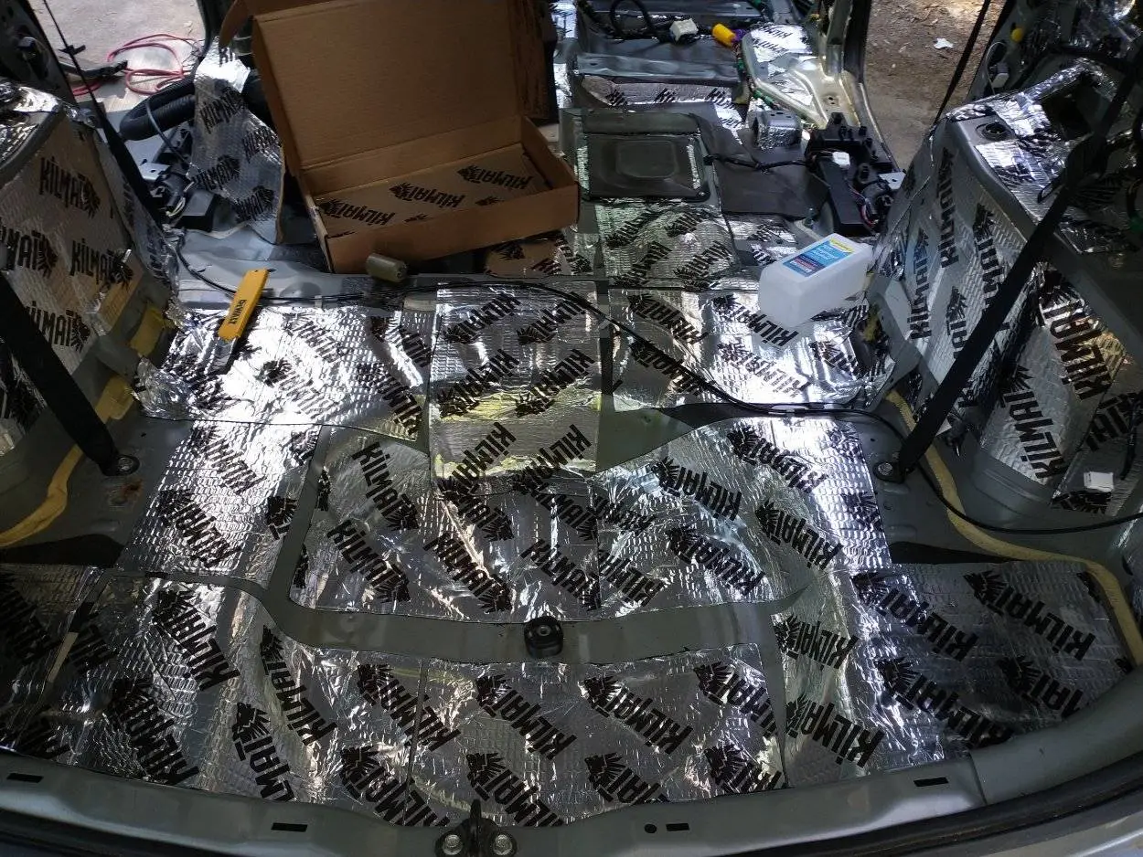

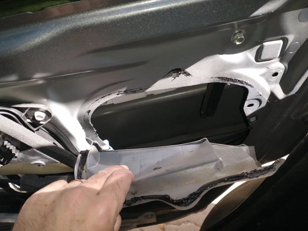

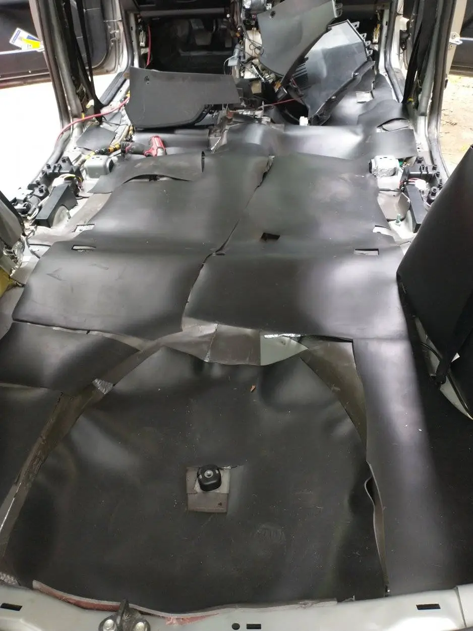

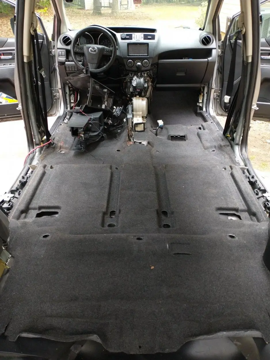

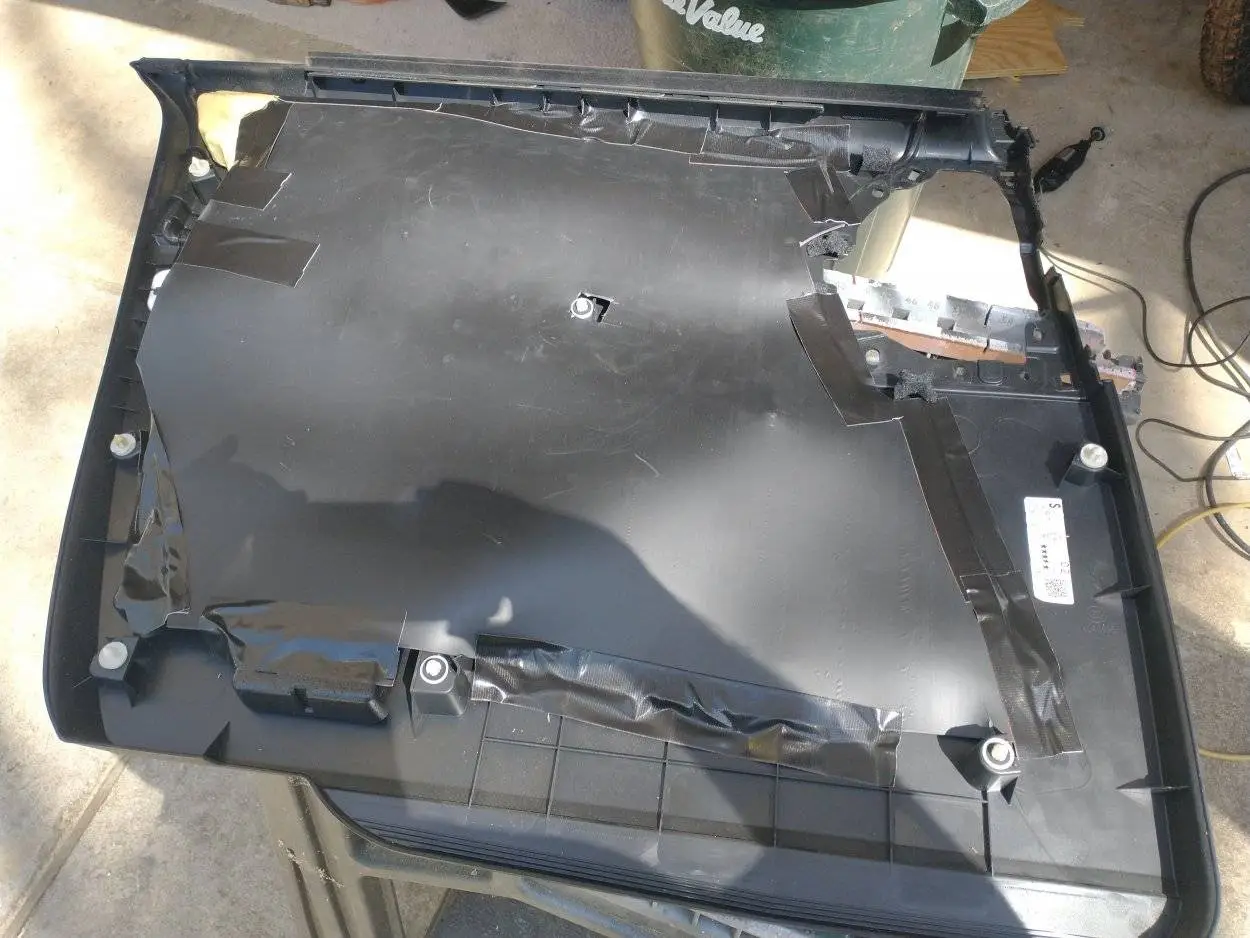

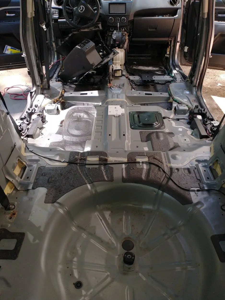

The van has absolutely no sound deadening whatsoever. It's pathetic. I fixed that today. I did a three part install: the classic Dynamat style asphalt on the door skin (I used Killmat), then I did closed cell foam on the inner skin, and finally I did mass loaded vinyl on the door panel itself.

You need to do the doors and floor at least. Doing the rear hatch door and behind the rear side panels is also highly recommend.

The difference is very noticeable. Much quieter. As far as quantifying, no I didn't measure the before and after, but there is a difference for sure, and it's well worth the hassle.
