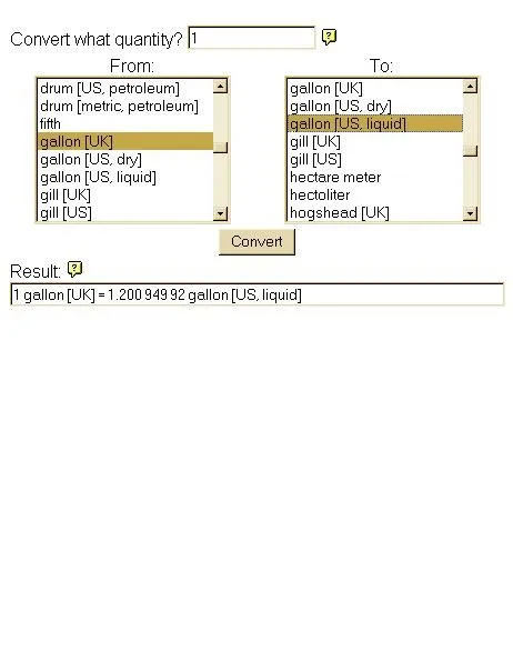

How are you guys calculating these numbers? I am using this fuel logbook calculator where I enter in the price paid, litres filled, and odometer reading on calgarygasprices.com
I think I must be doing something wrong, because I get 41.41 mpg. That seems to high compared to you guys, although I am a pretty conservative driver. Is 41.41 mpg a feasible number for a 2002 Mazda Protege sedan automatic?

41.41 mpg sounds reasonable if it's Imperial MPG.
(41.41 Imperial MPG = 34.48 US MPG = 6.82 l/100km)
Maybe those are Imperial Gallons
What Gallon? US or Imperial?

That would be the Imperial gallon. I'm from Victoria, BC, and have lived in the US forever. My frequent visits to home have clued me in. Back in the good ol' days, it took less to fill up the tank in Canada. Not really... just those gallons were bigger by 20%.
nobb said:
Maybe I am stupid, but I never knew there is such thing as US or Imperial gallon. I live in Canada and we use SI units in school =). Here is a screenshot of my fuel logbook:
http://img266.imageshack.us/my.php?image=gasmileagelf8.jpg
I searched the site, but it did not mention if it was Imperial or US gallon. The site does also give my mileage as 6.793L/100km.
