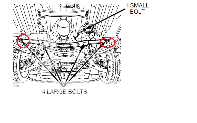

Is this the jack points you are referring to or is it the bigger nut in front of this? I am a guessing I am a bit slow. Rather be safe than sorry.
I am thinking it is the bigger bolt in front of the circled one and slightly in. They have what looks to be agreenish looking bushing device. Thanks again

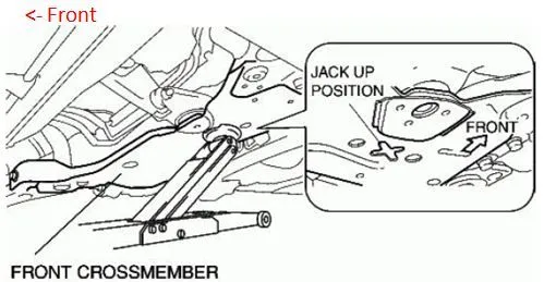

You want to jack it up here (see pic) so you can put jacks on the side sills.

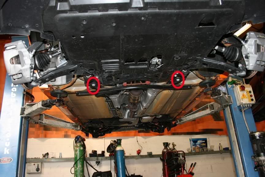

I like to use the jack points circled in red on the photo below. I got the photo from another site. I then place my jack stands on the factory jacking points. I did have to drive my car up on to a piece of 2x6 in order to get my jack to the jacking points. I use a hockey puck to keep from maring the bolt's head. You could use wood, but it tends to split.

That is either a Mazda3 or MazdaSpeed3. Your Mazda5 should still have the larger bolts that are circled though. My 2010 Mazda5 does.
