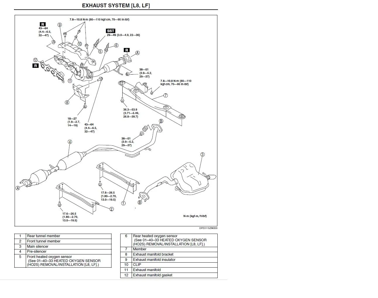

Here is a diagram of the stock exhaust layout.
Thanks for the diagram! I guess those two tunnel members might have to be modified to allow a larger pipe to pass through?
