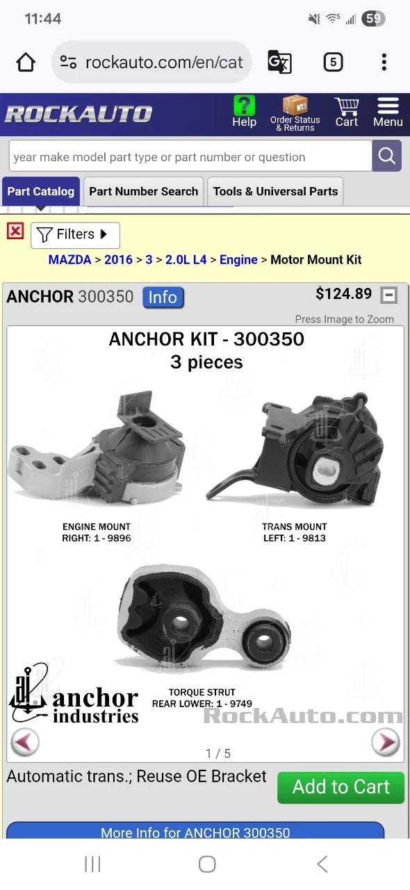

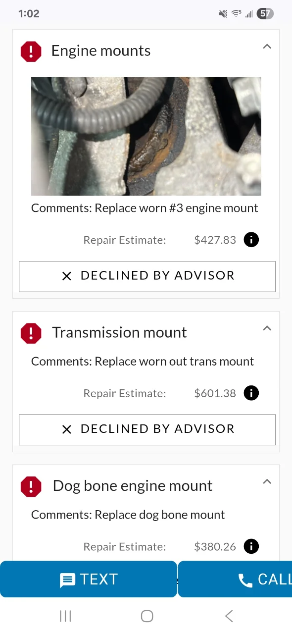

I'm guessing a Mazda 3 would have 3 engine mounts but rockauto only sells the front right mount. No stocks for the front left or any rear mounts. The dealership (upon getting diagnostics done) suggested to replace engine mount #3 and the dog bone mount. I'm sure there's 3 engine mounts so might as well replace all. They also suggested to replace the worn out transmission mount. Rockauto sells the left mount, but doesn't state what the other transmission mounts they sell, if it's either for a right or a left (I'll contact the manufacturer later).

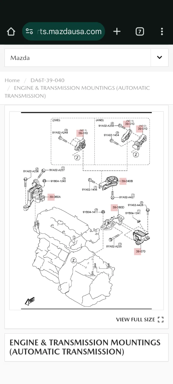

I usually go to partsouq.com, put in my vin and look at the exploded diagrams to see what parts are doing what.
I kind of figured earlier after finding a motor mount kit at rockauto. There's 3 mounts in the kit and 1 of the mount is a transmission mount. I didnt realize that the motor/engine mount is connected to the transmission mount as one piece (is it?)?
The dealership diagnostics had 3 separate diagnosis (and 3 separate prices ranging from $380 to $600 each!) for each mount as having issues rather than simply stating that the engine mount (all 3) is the issue.

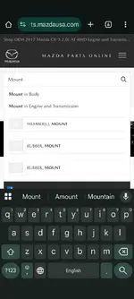

I recently ordered OEM parts for my CX-3 from https://mazda.oempartsonline.com/
You can also pull the part numbers from the official Mazda site and then search for it on dealership sites and etc.

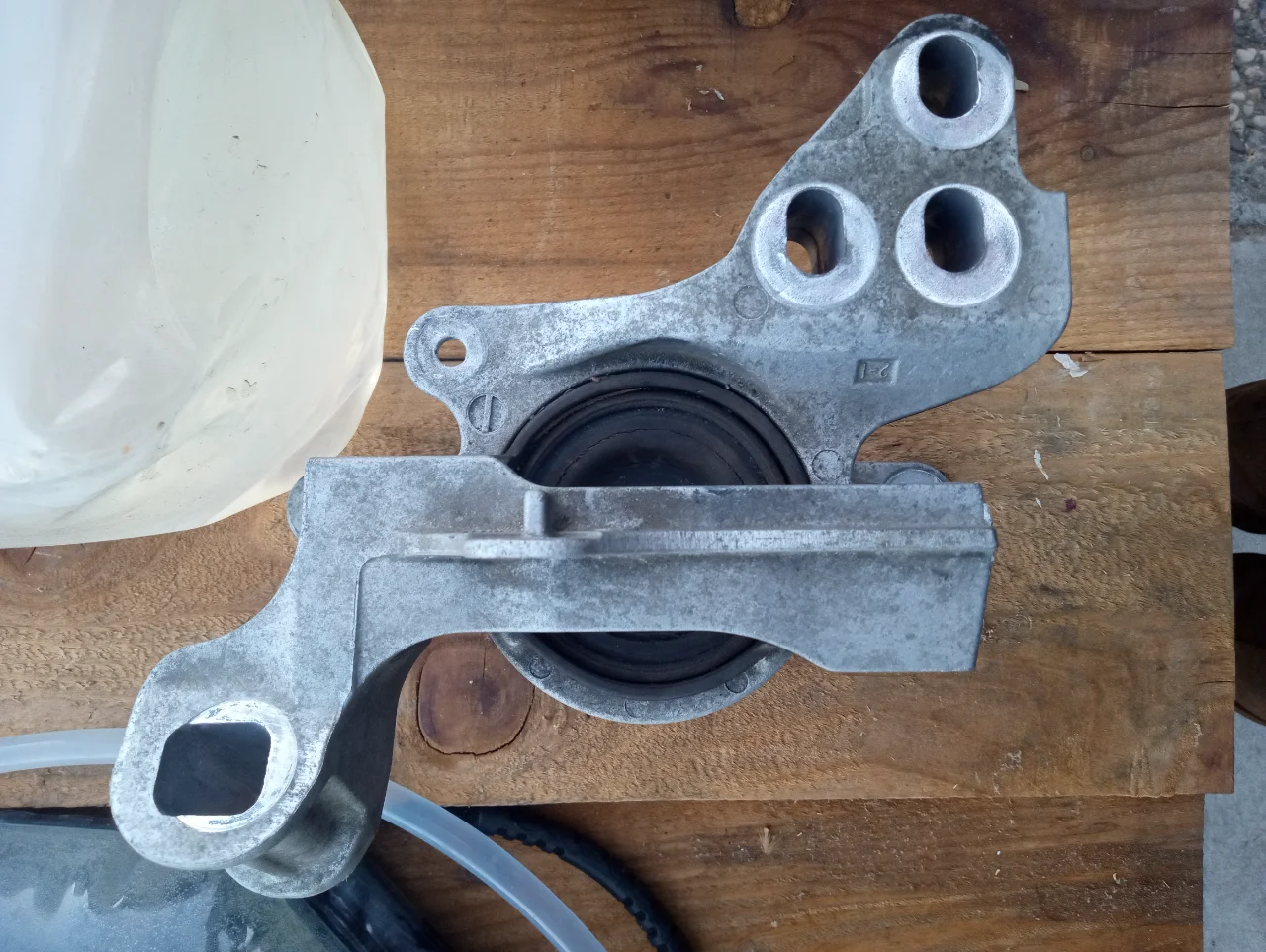

Ordered 3 mounts and installed 2 already: the side mount (between the passenger side strut and engine) and the transmission mount (dog bone right in the center under carriage). The last piece is supposed to be on the driver side of the engine. I was doing a D/L of the transmission so the intake box was out. It didn't seem like I got the correct item so I have to check again. There's a difference between awd and fwd.

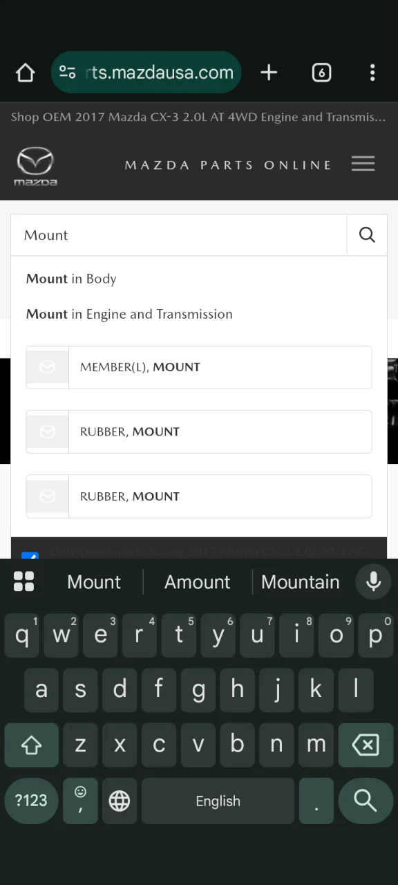

parts.mazdausa.com has everything listed in categories with diagrams after you specify year/model/engine/transmission/trim
Use the parts number here to shop for better prices.

The first picture in my first reply shows the bolt holes for the main mount and you can see that there is room for adjustment. I was told to make sure that the new one is positioned the same way by aligning the bolts.

Did you find out more about #3? For me, the last mount was on the driver side for the transmission. It was a real pain to get to. Air box out, battery out, battery tray out... I also had to disconnect the modules from the back of the tray. It has one long bolt going through a bracket on top of the transmission, two bolts into the chassis, and one nut higher up for a stud. The two bolts into the chassis are hardest because of the bundles of wires in the way. The rubber in the mount itself doesn't look bad, I would have believed it to be a life-time component. 😅

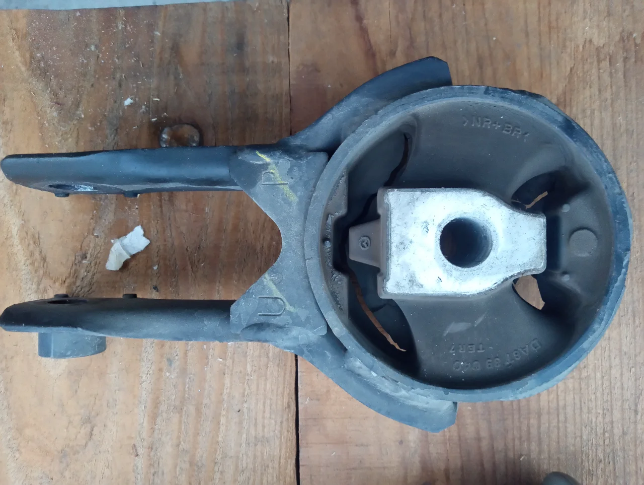

The 2016 Mazda 3 we recently had the engine mounts replaced had 3 mounts (left and right and lower rear aka dog bone mount). I posted a pic from Rockauto on post #3. The mechanic who installed them gave back the old worn out mounts and it looks exactly like the new mounts bought from Rockauto. The suggestion was to reuse the OE bracket.

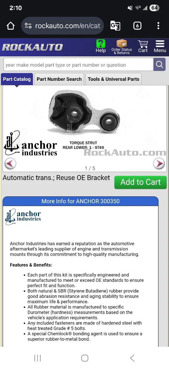

just because they "looks exactly the same" doesn't mean they're the same... you can't see the rubber hardness (durometer) nor know what filling is used inside the mounts... you may or may not get more vibrations with aftermarket non-performance mounts compared to OEM... it's a huge coin toss when you buy aftermarket

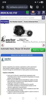

The Anchor motor mount kit was described as "meets or exceeds OE standards". It's the only brand that Rockauto sells as far as a complete kit.
