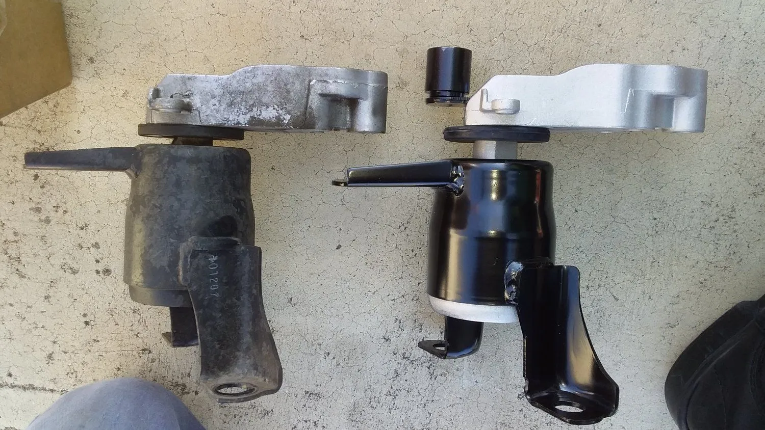

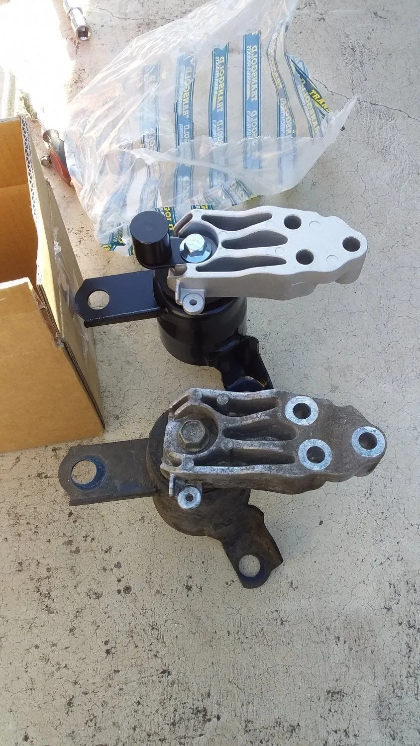

I fixed my partner's 2010 Mazda 2 Neo, manual 120,000kms, which had the same - "excessive vibration on cold start up", which settled after a few mins of driving / warm up
I bought & changed out the RHS engine mount with a non-genuine replacement on eBay Aus for $107 (link below) - some forums /sellers suggest the mount varies between auto & manual - this seller says otherwise, &, after messaging them to making sure it would fit our manual, the part they sold me fit & fixed the vibration - the mount they sent came with an additional little black thing on the top, which I don't know what it does, but hasn't affected the car at all)

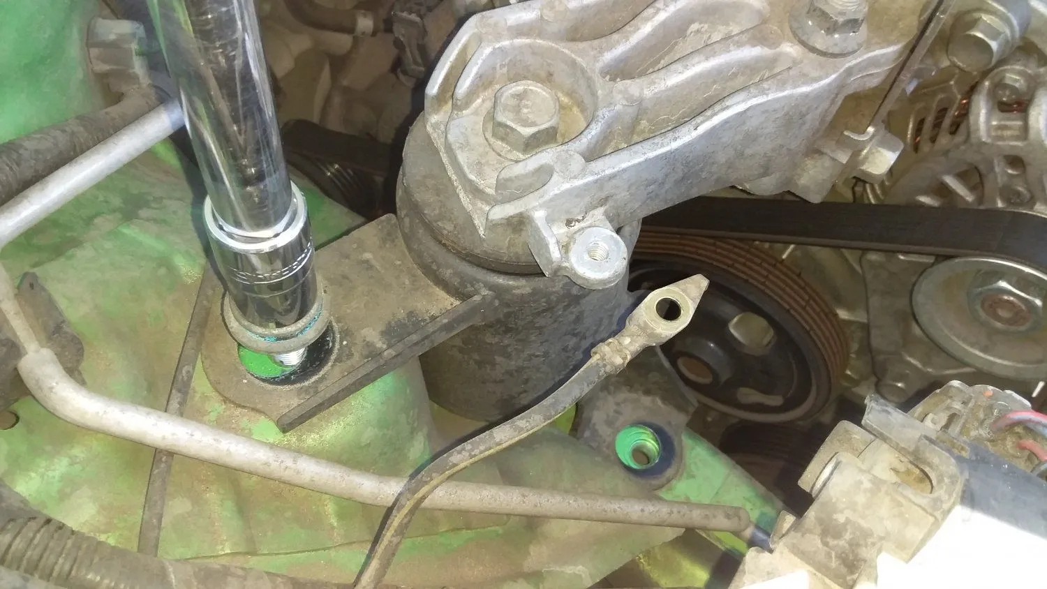

It was easy enough to change the mount with just my socket set AND a jack & piece of timber under the oil sump (to "sightly" raise the engine / take the weight off the mount) - & replacing the mount about a month ago now, has completely solved the vibration, & doing the job took me less than a half hr (& surprised me at how easy & straight forward it was for a DIY'er - I think I used a 17mm & 12mm socket, from memory, & you'll need an extension to reach the bottom bolts - I put 3 shorter extensions together to be able to reach these bolts)
It seems on start up, on ageing Mazda 2's, the engine temporarily idles quick to get up to running temp, & while it's at that quick idle rev range, the vibration was heard & felt through the whole car (including the steering wheel & everything that's attached to the engine bay) while stationary or driving - due to a tired RHS engine mount (I think people also refer to this one as a "gel" mount)
I was quoted over $600 for the repair at a Mazda dealer (for a genuine $450 part, plus labour)
I am curious, though, if this problem can be resolved without spending any money i.e. without buying any parts - there is some space at each bolt hole (top and bottom attachments - see pic), I wonder if raising the engine, loosening off all bolts & slightly shifting the offending /tired old mount forwards or backwards a little & then re-tightening everything will eliminate the vibration, even if only for a while, until the mount is completely shagged??? If you try & succeed with such a "free fix" or similar, please comment...
Method for replacing RHS engine mount - a common cause for excessive vibration on cold start up;
1) (if replacing mount) buy new mount - I'd suggest new, & not 2nd hand, to avoid installing an already worn / tired mount, & check you have the same part (hold the new mount near the one you are replacing to see if its the same thing before you start)
2) "slightly" raise engine using a piece of timber under the oil sump (to spread the weight) raised on a jack (any sort - I used the car's jack from the boot) - you only need to take the weight off the mounts, so 5 - 10 mm of actual travel / lift will do
Note; for most mechanical work it is best to disconnect the negative battery terminal before commencing any work (to avoid accidental electrical shorting, should you contact a positive component & the engine or body of the car with any tool you are using & shorting it across to any other part of the car, but I managed this job ok without disconnecting the battery)
3) loosen all bolts/nuts on mount making sure that there isn't excessive travel in the engine ( 3 at top & 3 at bottom - you may need to adjust up or down the jack), & REMOVE THE ATTACHED WIRE (top of mount)
4 - A) (if attempting the "free fix") slightly shift the mount forwards or back, re-tighten all nuts & bolts & reattach wire & remove jack before doing a test drive - & share a comment / post if this fixed the vibration
4 - B) (if changing out the worn / offending mount) if not too much engine travel when loosening nuts & bolts & they all loosened easily, fully remove top & bottom nuts & bolts & the old mount
5) install the new mount, & tighten & reattach everything in reverse order - & share your success with a supportive post
Link to the exact supplier / part I bought (& no, I am not linked or sponsored by them - I think they are in Qld, & I am in SA), I found them by using the "cheapest price plus postage" filter on eBay) & it came with the silver mounting arm included, even though it's not shown on their eBay pics;
