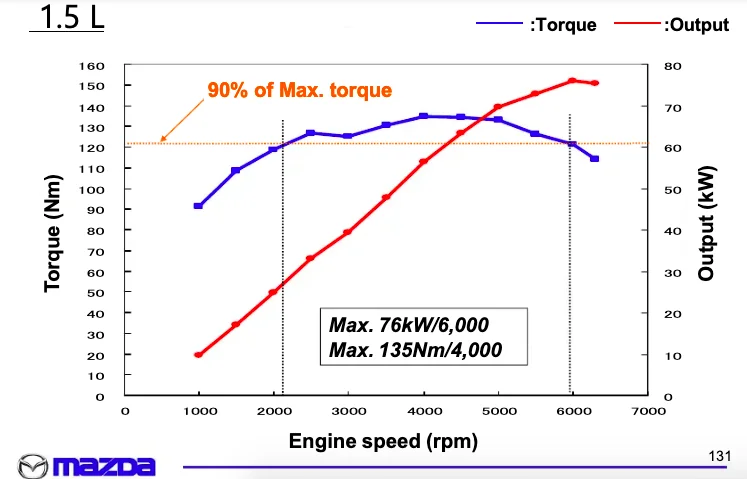

MAZDA2 ZY-VE 1.5lt Pg131 Torque & kW Vs RPM Curve

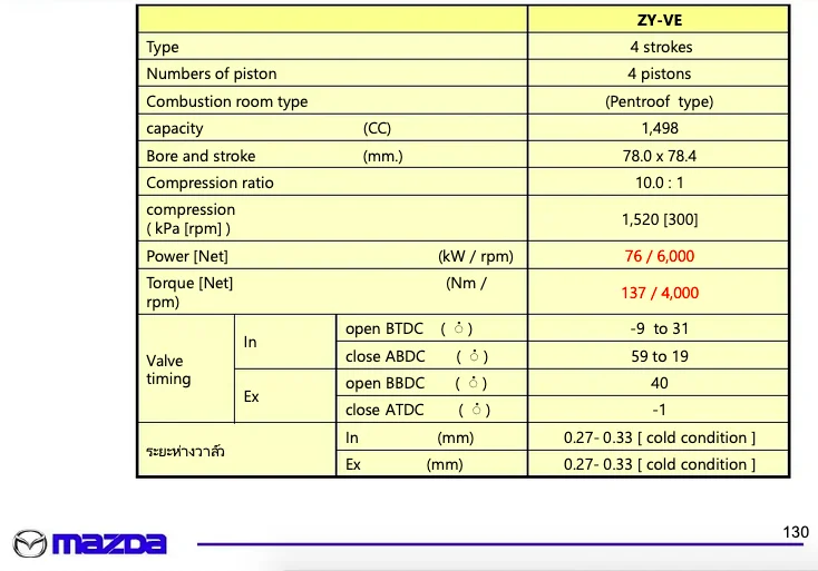

MAZDA2 ZY-VE 1.5lt Pg130 Spec
If you have modified your MAZDA 2 DE 1.5lt MZR ZY-VE with CAI & Exhaust, what is your Dyno Result outcome? ...overlaid on the Factory Stock Result above would be of interest.
