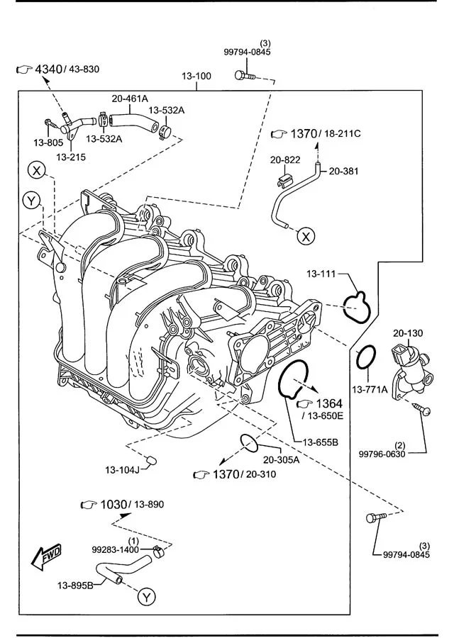

I've got the US version 2011 1.5 ZY-VE engine, and the video mentions variable length intake runners for the 1.5. I've got the manifold off right now for a good cleaning and to replace gaskets, but I don't find this feature in my engine. I have the turbulence damper assembly, but I would assume that variable length runners would require some sort of actuation assembly, such as the motor that drives the turbulence dampers.
Can anyone with a 1.5 point me at the mechanism for variable length intake runners?

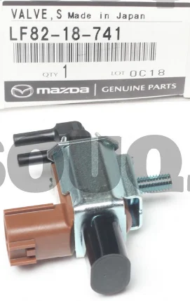

Toyotas used ACIS or earlier TVIS System with a set of vacuum actuated Butterfly Valves.
MAZDA seems to use "VLIM"
....the "Inlet Manifold Flap" shown in the "Cut-Away" looks like the MAZDA 2 DE 1_5lt MZR ZY-VE Engine "Intake Lengthener"
But somewhat Oddly.....the "Intake Lengthener" Control Method does not appear to be separately identified on the ECM Inputs/Outputs in my MAZDA W/Shop Manuals per:

(In Australia we only rec'd the 1.5lt ZY-VE engine, no 1.3lt ZJ-VE SFAIAA, there was a BUDGET 3 door version, but think that still had the 1.5lt ZY-VE)
LF8218741 Vacuum Runner Solenoid Valve for Mazda vehicles (3, 5, 6, CX-7, typically 2004-2013) that regulates the engine's intake manifold runner.

Thanks for your reply, Rob. I feel like maybe it was a feature on the ZL-VE, or some other variant that we didn't see here in the US. I've heard it referenced a time or two in other places, but I don't find evidence that it actually made it into production. I've even explored euro and asia parts diagrams and not found any clues.
The system diagram above matches what I found when I had everything apart. The only thing not shown there is the brake booster vacuum line, which plugs into the manifold right next to the PCV and MAP lines. There is a small rubber plug on the throttle side of the manifold, down low. Referenced as 13-104J in this diagram.
Maybe that was for a feature not implemented?
-Mark
