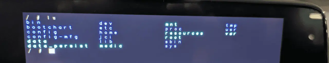

I was able to get into the 'terminal' option and plugged in a USB keyboard (it worked!), and ran ls to show the contents of the filesystem. I didn't do much more than that before exiting as I didn't want to make it a brick by accident.

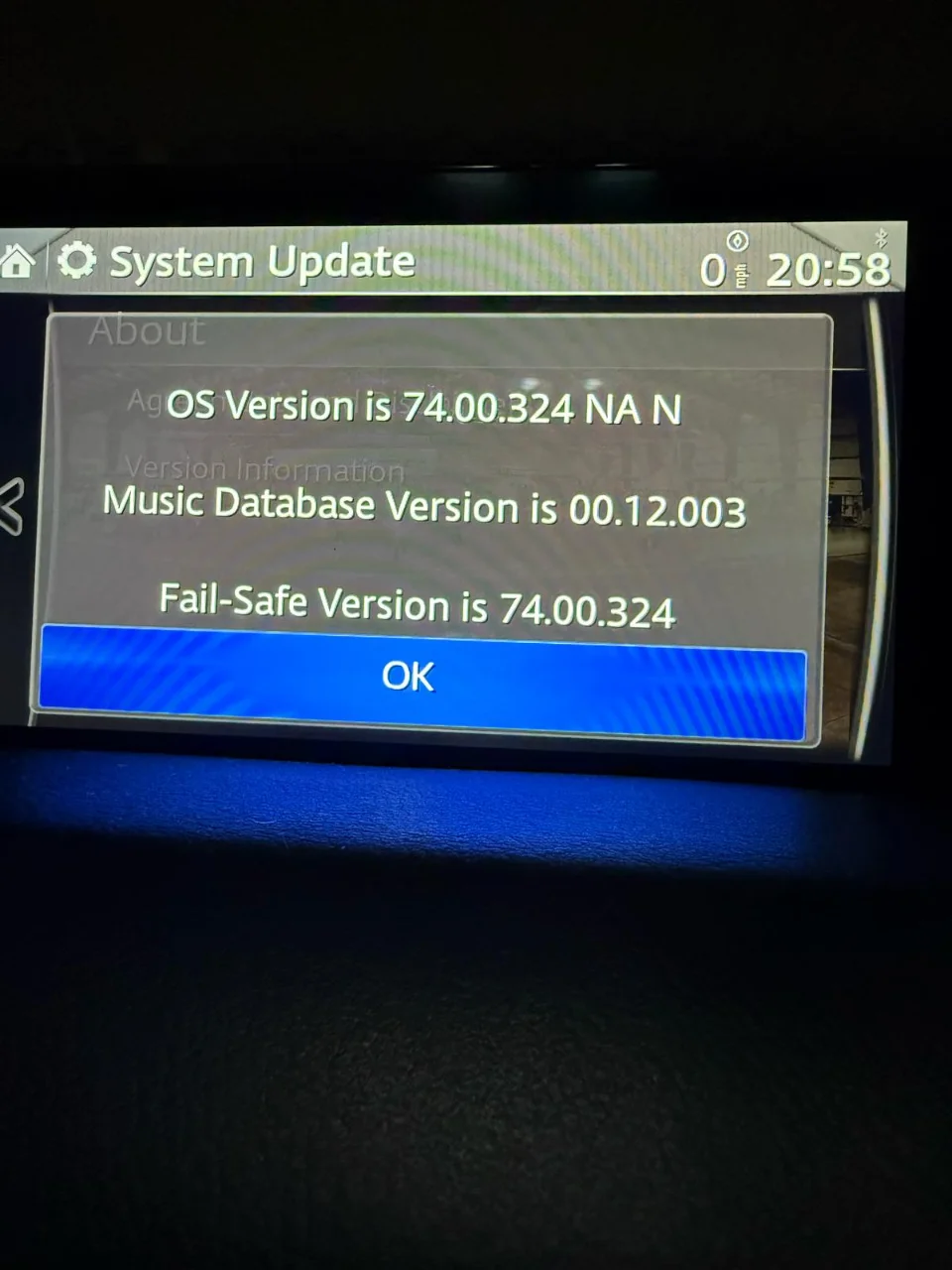

I have AIO installed on the v74. Once you create your configuration, go in the " _copy_to_usb" file and look for "run.sh" file. Open it with notepad and look for "-eq 70". The line looks like this:
elif [ $_VER -eq 70 ]
Change 0 with 4 => elif [ $_VER -eq 74 ]
Save and close the run.sh file. Then you transfer everything you need to the USB stick, ready to install it on your car. That's how I did it and it worked. I followed to the letter some YouTube guy instructions and rest is history. So far no issues.

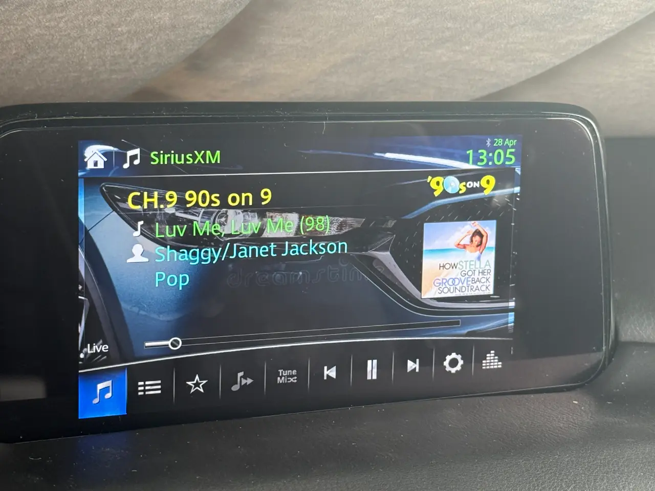

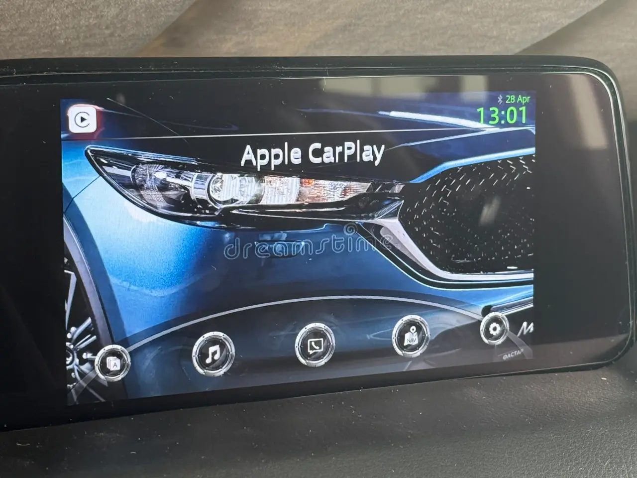

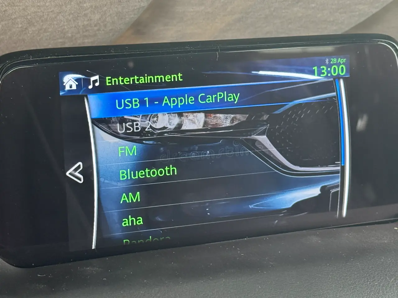

Played a bit with AIO. Rearranged the audio sources, changed the background picture, added the date on top of the time, changed some colours.

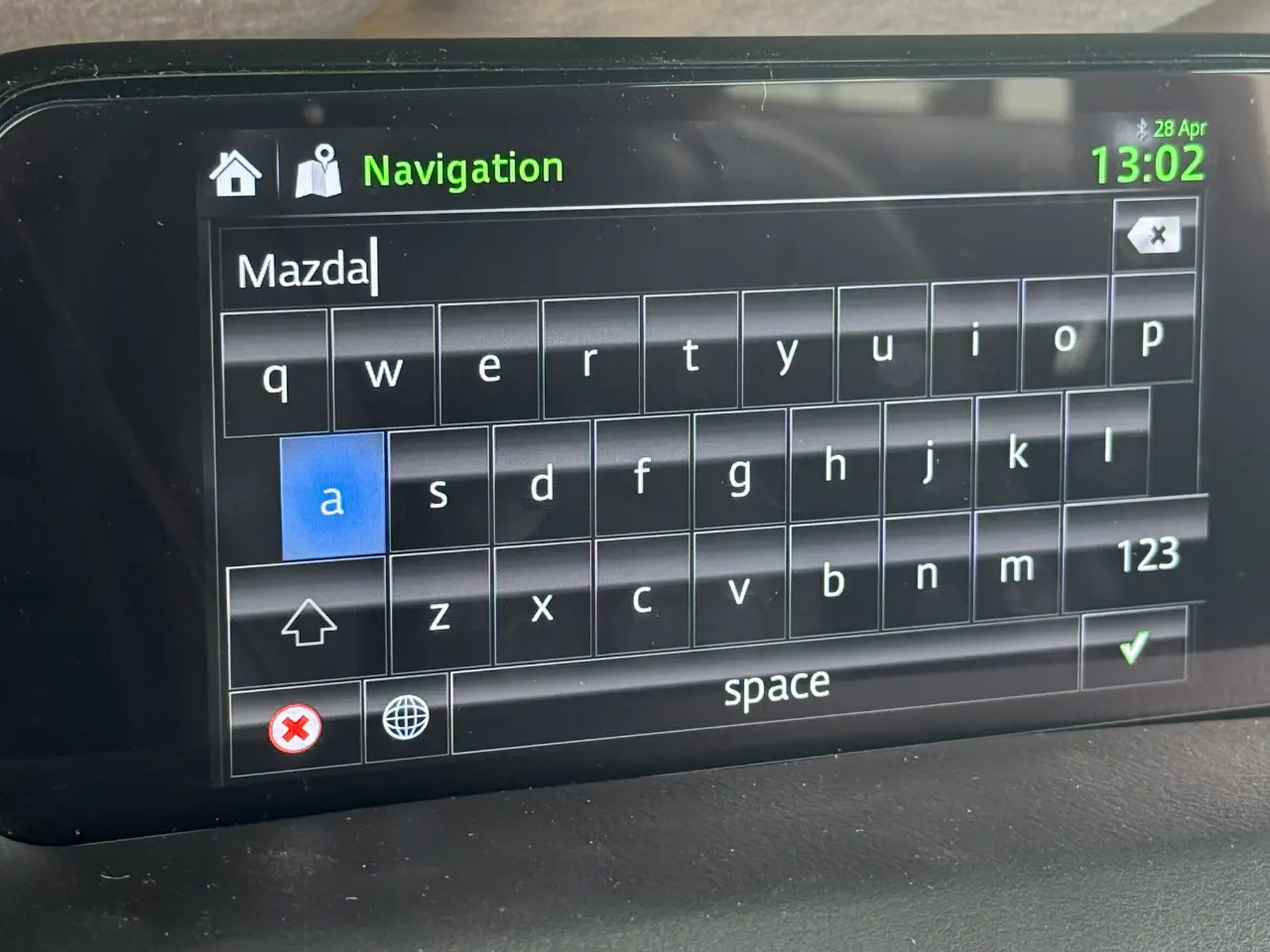

So far works good. It doesn't seem slow. I'd say that there is no difference between stock OS and AIO/tweaked OS. I discovered one issue accidentally: for some reason, all the Mazda dealers disappeared from the map's database. Just did a map update last night and it's the same result, no more dealers in the nav database. I must have installed something from AIO that screwed with the Mazda dealer names and addresses. Even more intriguing for me, today I helped a coworker to install AIO on his Miata. His map does have all the Mazda dealers in the database!
