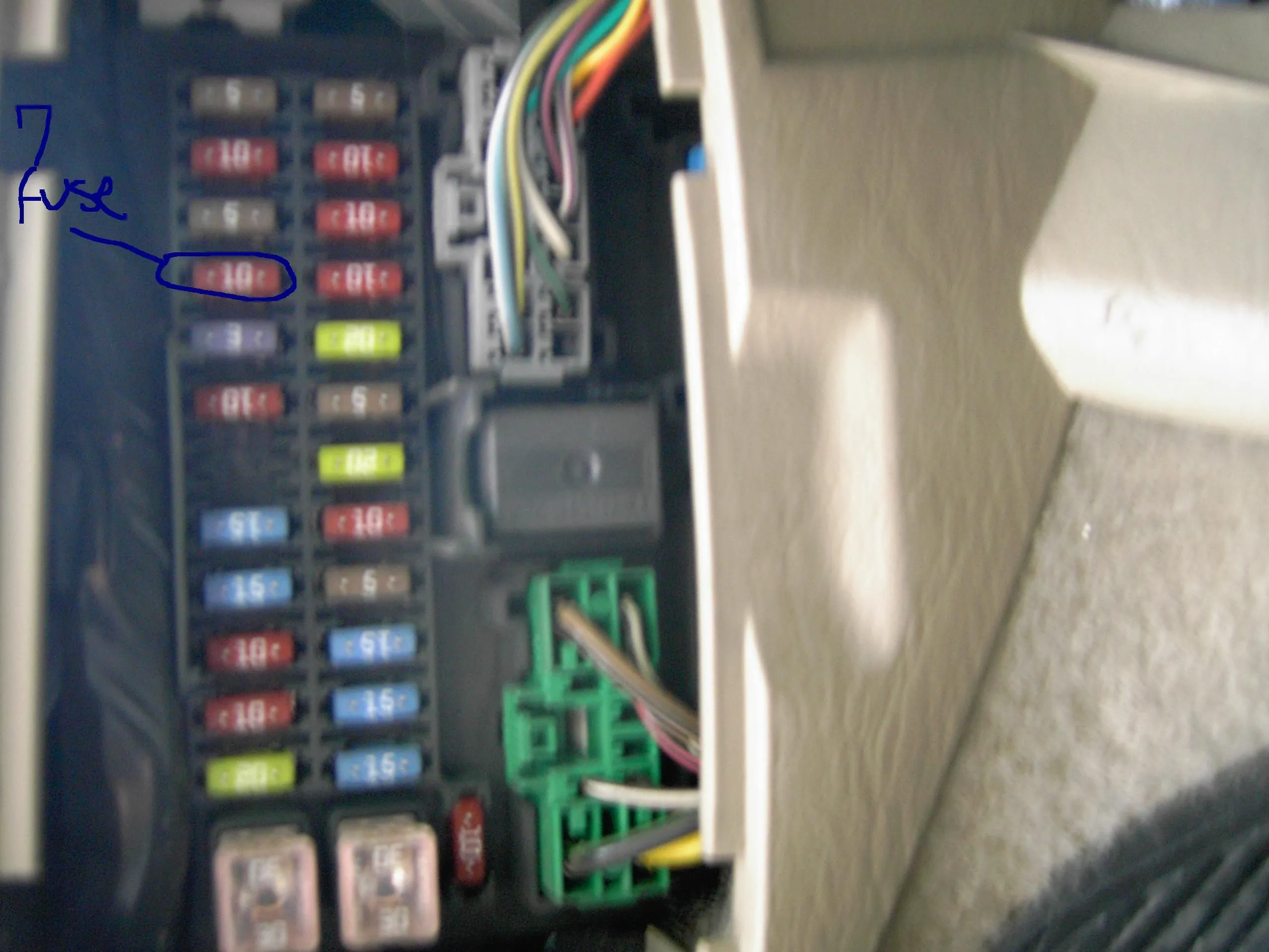

possiblilities:
PATS antena fell off
large metallic objects, electronic devices on key chain can cause interference in the PATS key and the receiver

Could a bad fuse be a problem?
Central junction box fuse 7 (10A), which protects Passive Anti-theft transceiver (PATS), Restraints control module
here's a pic of ignition fuse
sorry for the blurry pic,
i never thought of that a fuse may be the responsible for this, as simple as that, lol
Thanks snake,
Unless you see anything else that could cause the PATS to suddenly stop working, I'm leaving in about an hour to go try again. All lights and battery functions work. Keyless entry works. So all I have to go on now is a possible blown fuse or loose wire. I will most likely have to tow it to the dealer, and call them tomorrow.
No problem, i like to help people out, especialy fellow Tribute owners as i own the factory service manual, lol
when you go, take a 10a fuse so you can check if the fuse is blown and replacing it it should be back to normal, if it isn't the only option left would be the stealership (gun) as you said
