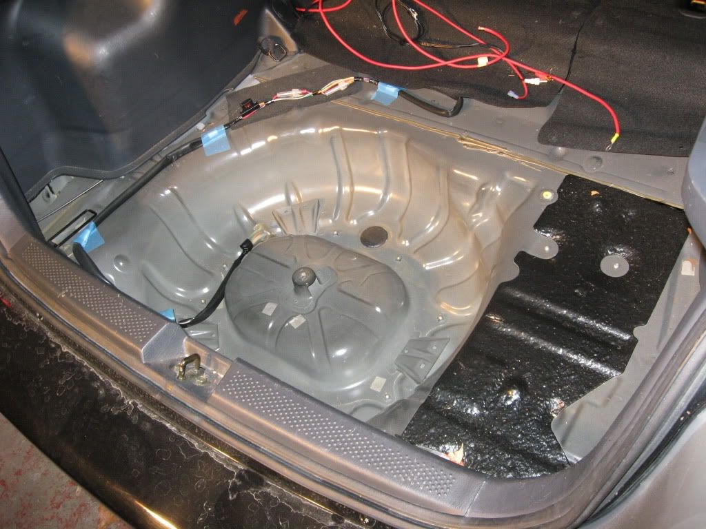

here you can see where the wiring clips in to the stock location. drivers side, just in front of the rear wheel well. this pic is facing the rear passenger seat.
check for a couple of those plastic pop out clips, and then you should be able to pull up on the pannel. the wire on top, is the wiring that goes to the sub. i already undid the clip in this pic. im assuming the wiring on the bottom will be there regardless of weather your car had the sub from the factory or not. that is where your sub wiring should clip into.
in the pic below, you see the continuation of the wiring for the stock sub. the black wires that are taped to the floor, they plug right into the stock sub. (never mind the red wires, they were my old crappy sub power wires. they are not stock)
hope this helps some.

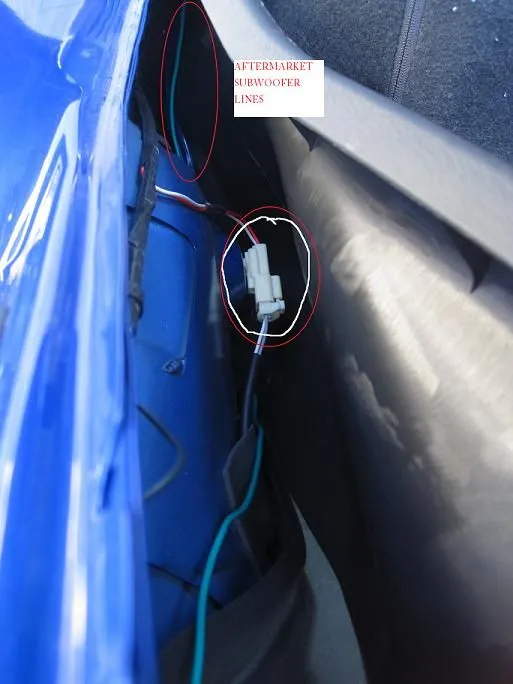

soooo weird thing is i have holes in the frame where it appears the factory sub wires are connected in your pictures, but i have no actual wire. im assuming the origional owner took it out when installing the aftermarket setup. dangit.
i actually did look back there while exploring the trail of the current blue and silver lines that are in the hatch for the aftermarket sub, but when i removed the two pins i couldn't pull it that far out to really get a good look. from what i could see tho i dont have that connector either.

i got the courage to rip apart my interior some more and took a pic of the rear wheel well behind the driver.
i suspect the connector i circled in red and white is the one that gives power to the taillights and rear light in my hatch. i also circled my currently disconnected sub lines, which appears to run under the moulding up to the front of the car. i was unable to lift the trim any farther to investigate.
