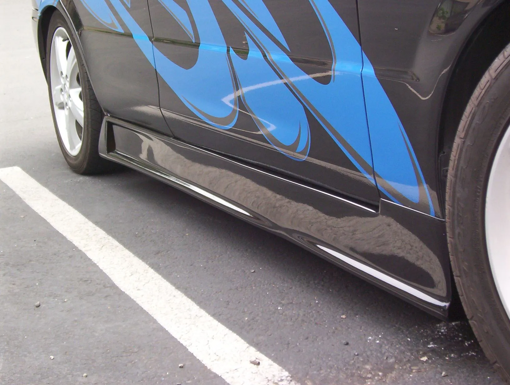

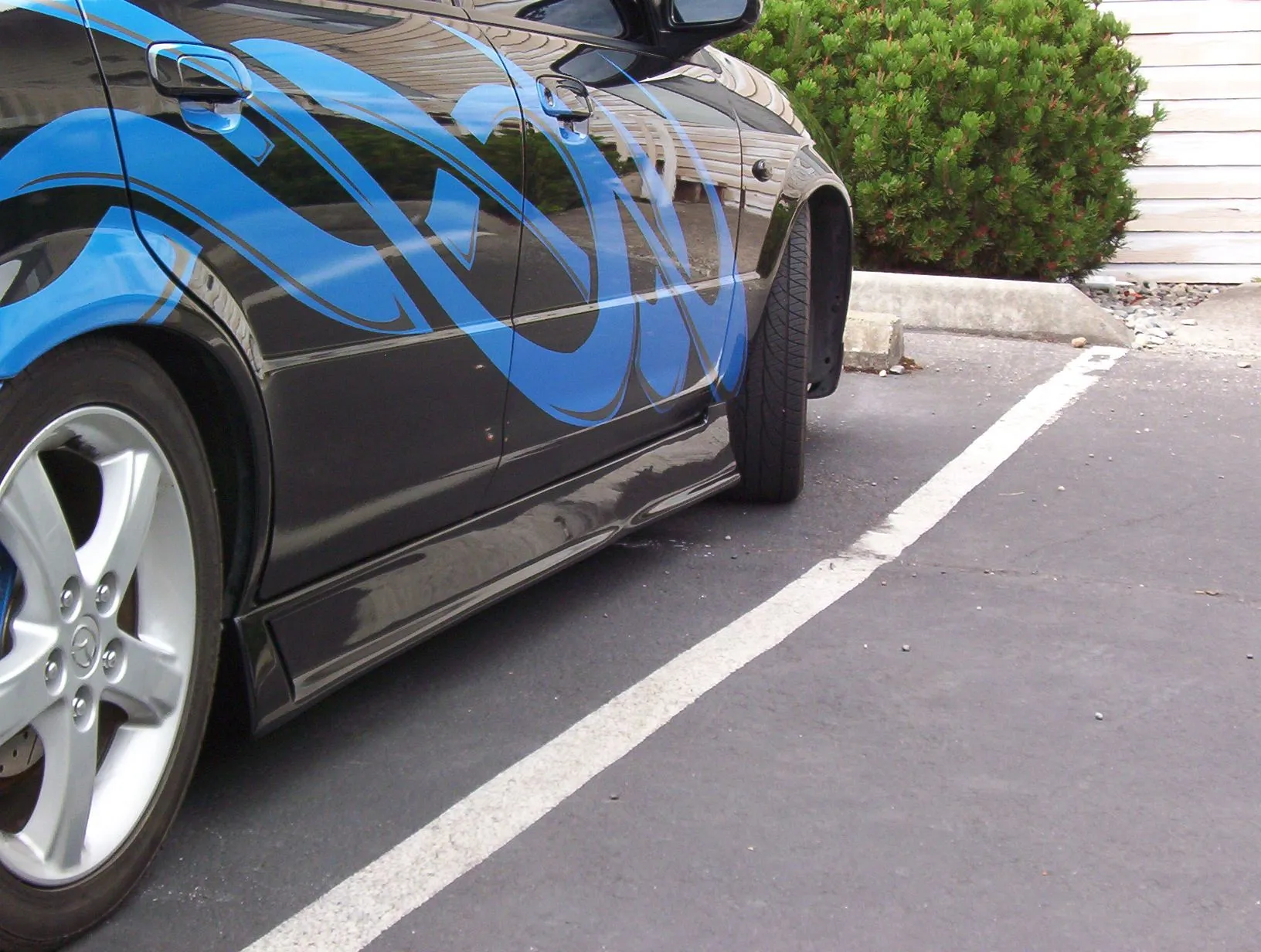

sides installed so i thought i would add a pic.....or 2
looks good but I'm gonna need (pics) of the whole car now... mmkaythx
i am getting those today after the vinyl gets fixed, i need some new ones for a show board anyway, the only thing that sux is my rims wont be on until i get back from ny in 2 weeks

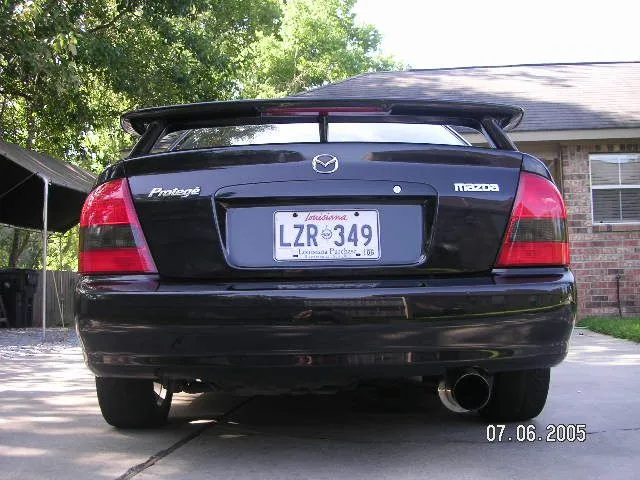

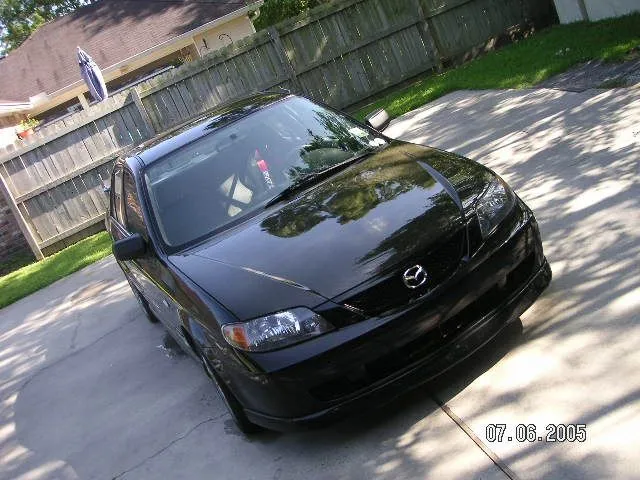

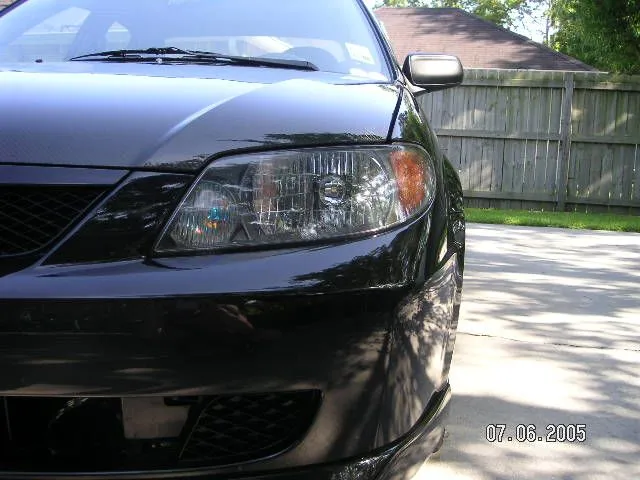

heres some of my car
