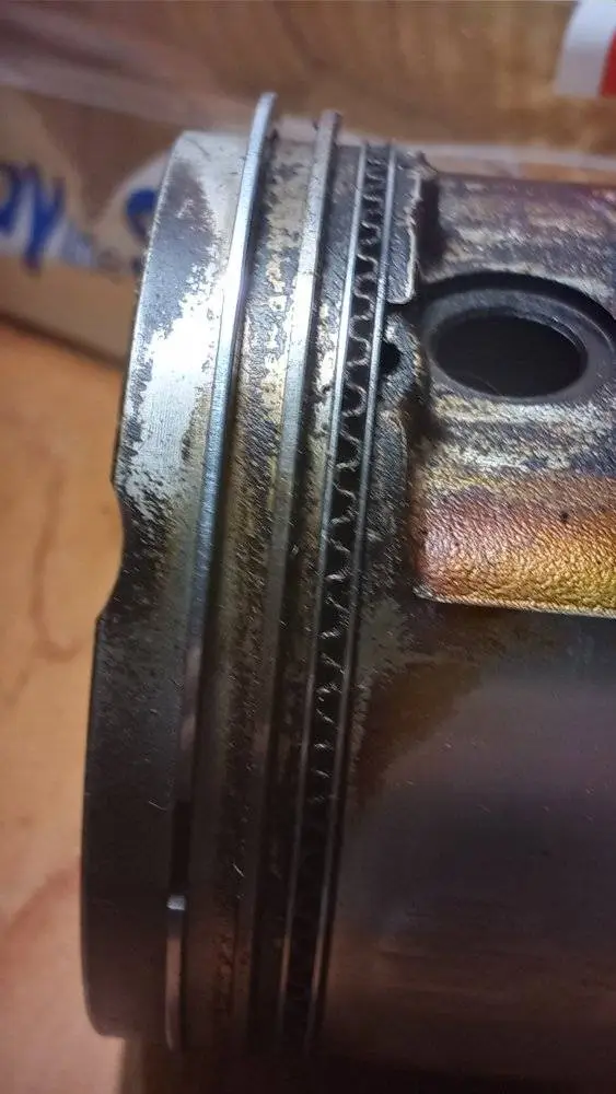

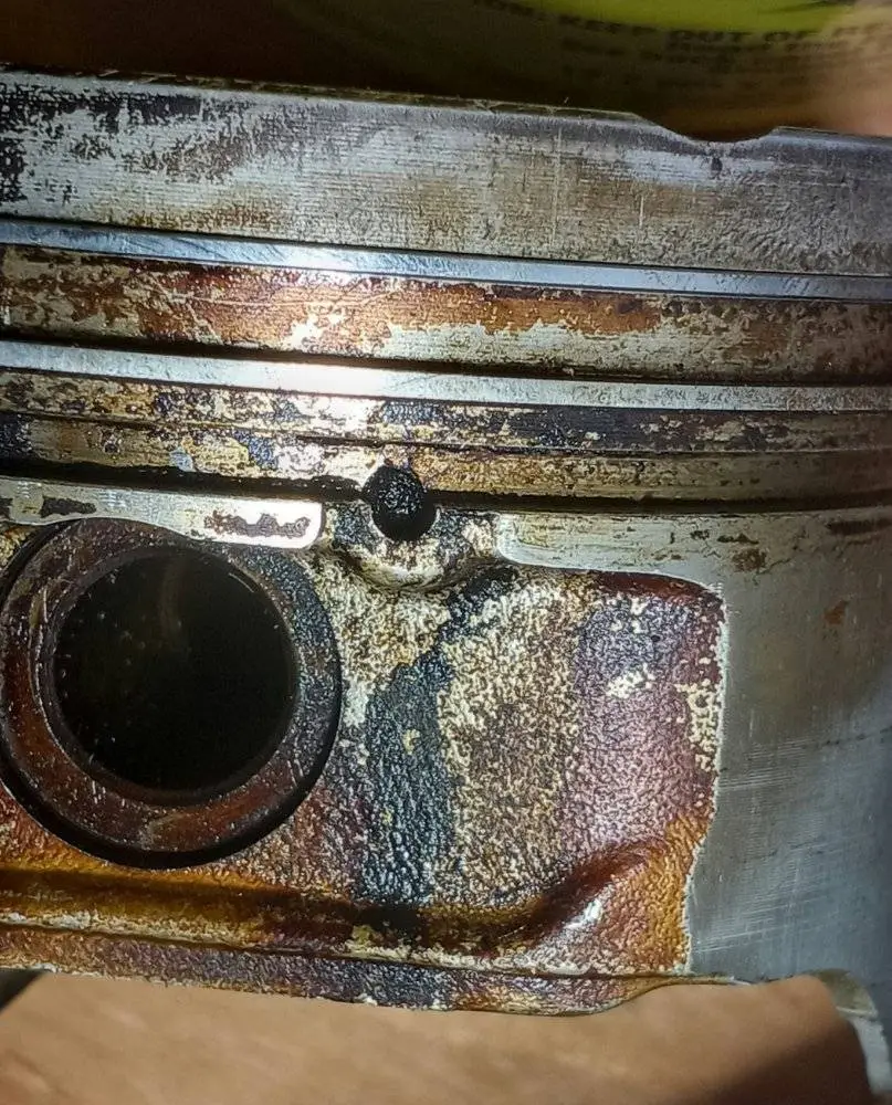

This is what your piston ends up looking like when your pistons oil drain holes completely plug up...
Notice the lack of spring tension on the oil ring.
The oil hole drains towards the connecting rod.
Once that hole is plugged up, it's really hard to clean it out because there is no flow through it to get the engine cleaner to it, but I guess some people have managed to do it.
