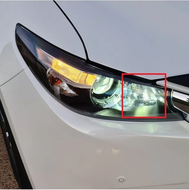

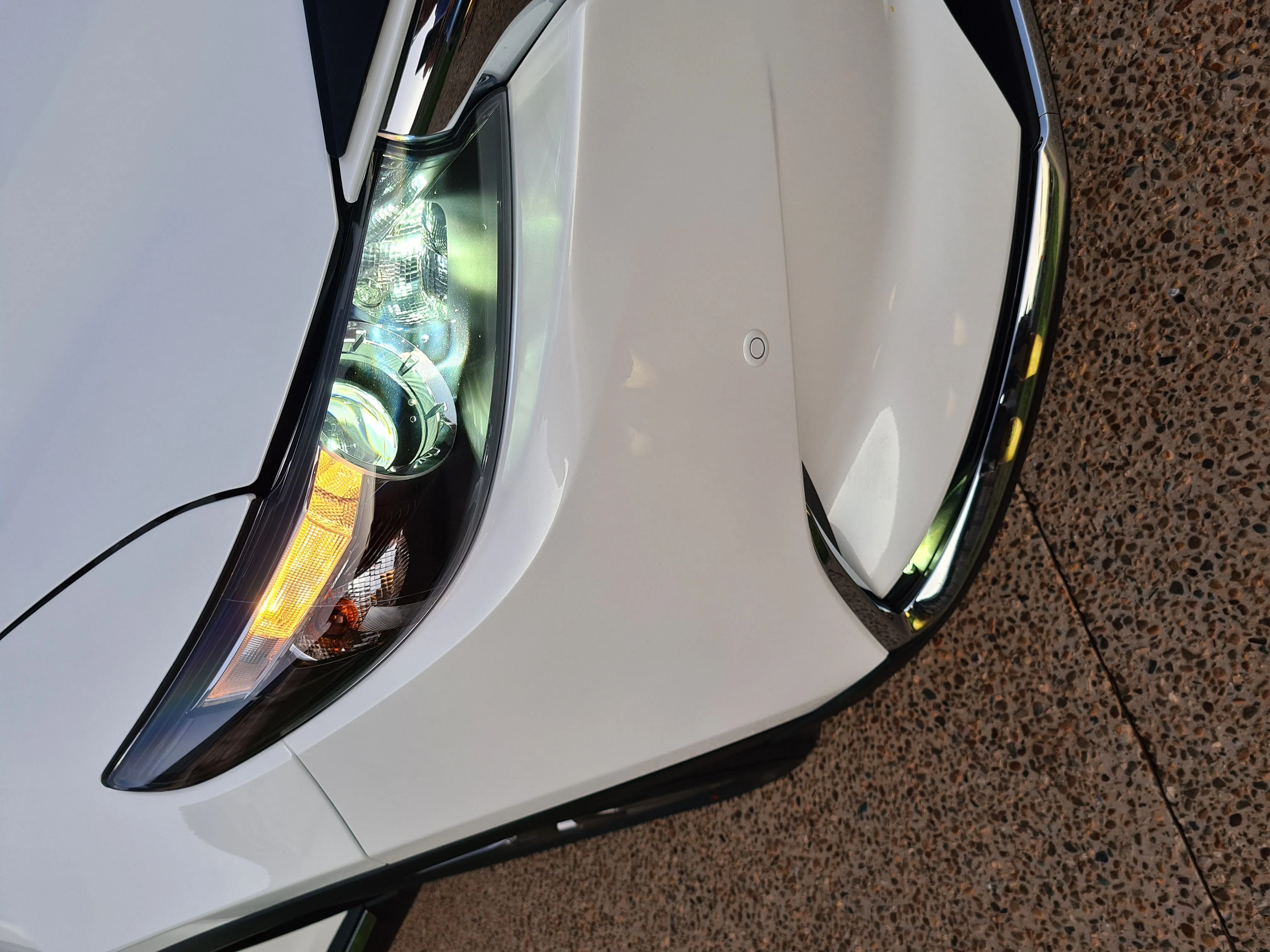

Good day,
I have a 2020 CX9 GT, I noticed while driving there is a light that automatically turns on. Its yellowish in colour and also the position lights have the same colour. Wanting to change it to led so that it is similar colours with the low/high beam. Looking at the manual, it doesn't tell you what type/size of that light is.
Can you provide more details to where that light is? Maybe a photo as well would help. You should also tells us in which market you are located since this has a big incidence on lights configuration.

Thank you I'm in Australia. I think there is no problem changing it to white. Its just that the mechanic is advising not to change it because the drl is automatic.

Oh its not marker or indicator lights like your picture. Im referring to drl. My marker/indicator lights are led
I see what you mean!! It's this one:
I had to take a closer look. North American models have the drl either together with the actual headlight circle (lower trims) or as light bars (higher trims).
Confirm with your owner's manual what the size code is, but from this generic manual I found online, says it's size 7443.
Not sure though what the concern of your mechanic is replacing that with LED, other than being able to find the proper kind. Some LED bulbs are too weak to be used as drl.
Interesting how the model differs by regions. Sometime the issue with DRLs is that they have 2 different level of intensity for day and night driving. If you change them to LED then you may lose that 2 x intensity level capability (depending on the LED model). You can see in the manual you linked that there are 2 x wattages identified "21/5", which seems to indicate that these bulbs are running on two different settings depending on the driving scenario.
