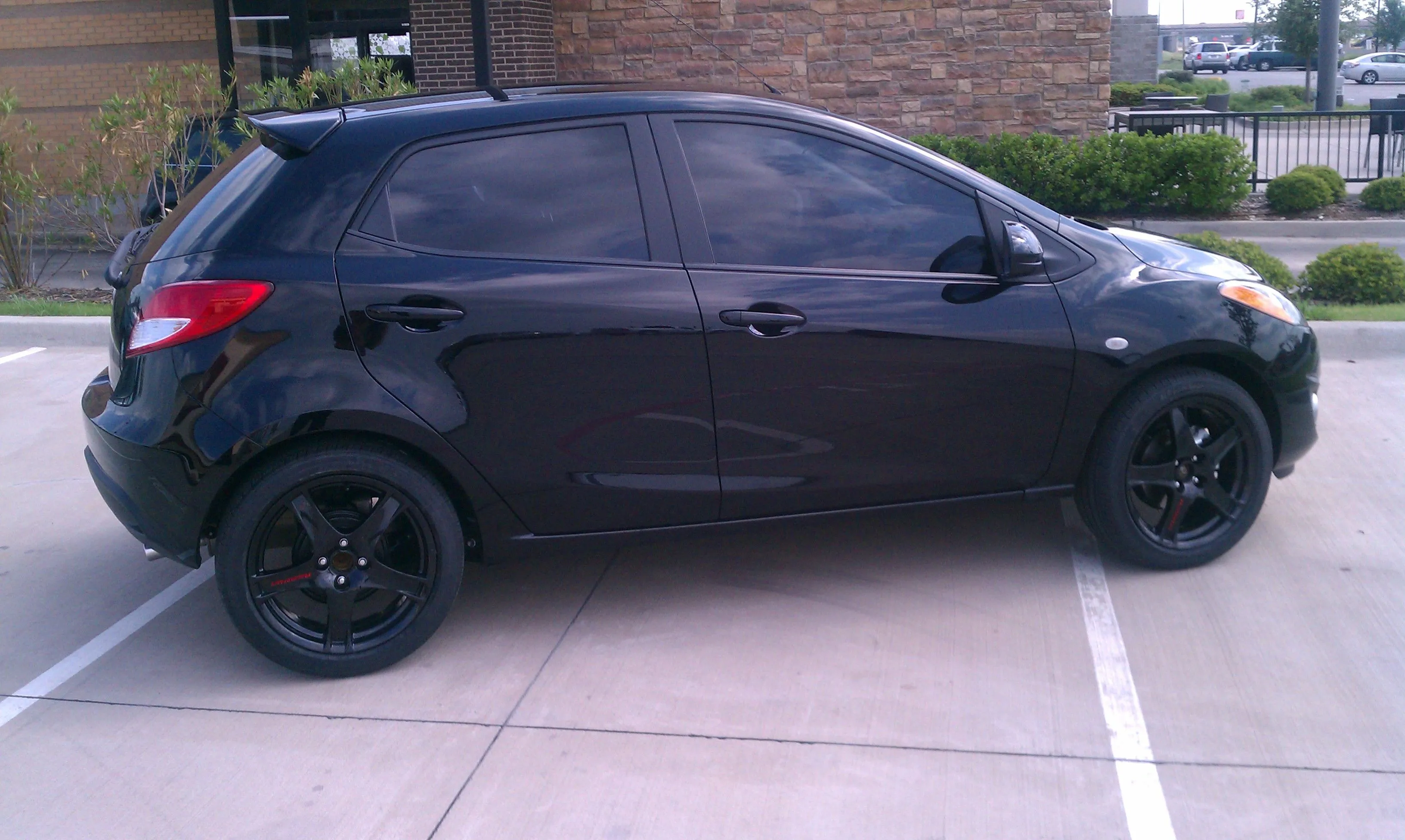

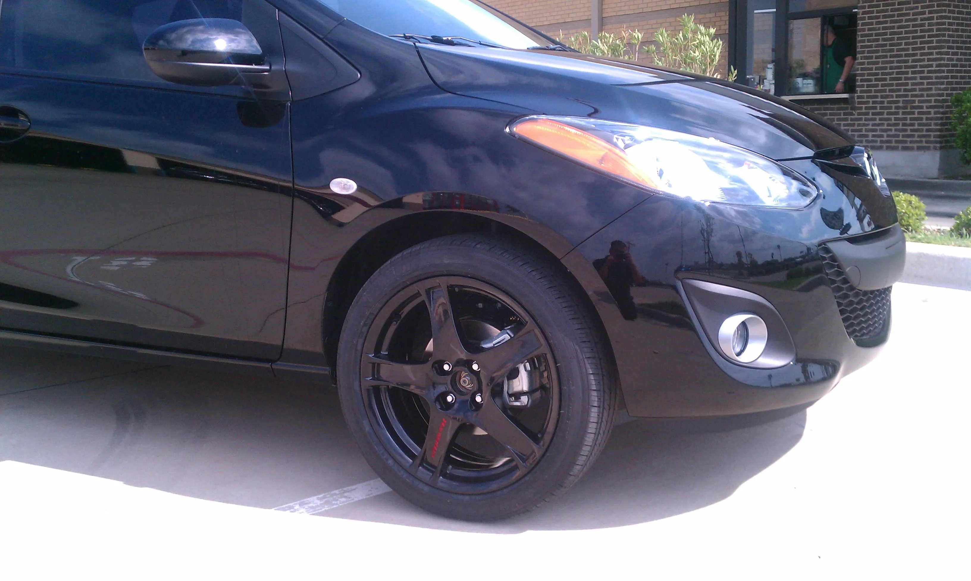

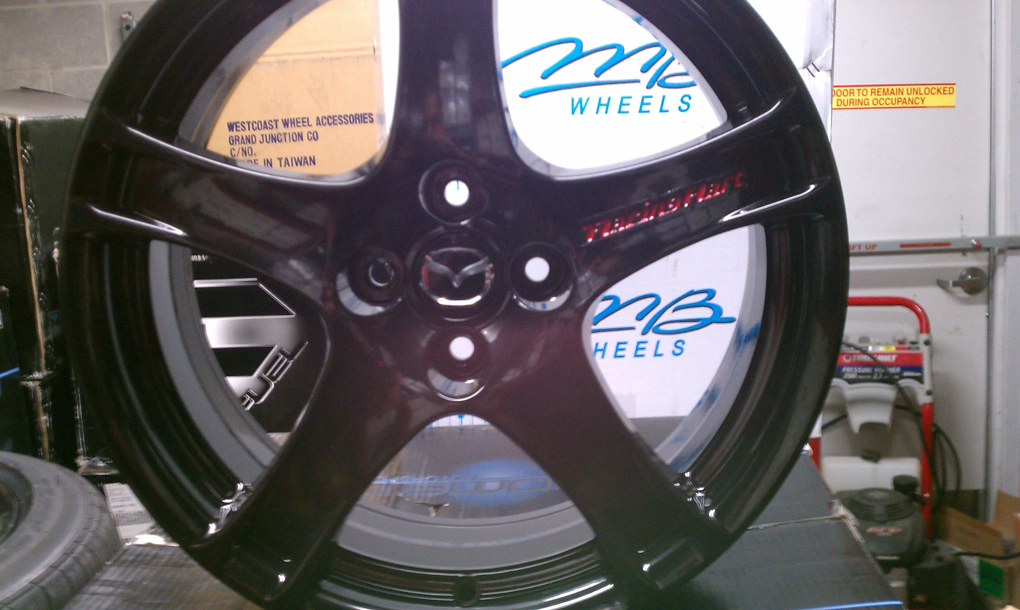

I have the factory 2005 Mazda Miata wheels on my Mazda 2 and they work great they are 17x7 with the 215-45/17 Michelin mxm4 z rated tire. I went this route because none of the aftermarket wheels seem to have a good offset that kept the wheels from sitting outside or inside the car too far. This setup allows me to get maximum size tire as I like to keep the sidewalls semi cushiony. The fitment is great I can't seem to wear these tires down for nothing I've have 10,000 miles on them already and you can't even tell. They still have 8/32 of tread left, oh yes and they're powder coated black with red detail lovin it. Great ride and great stance.

Those are really heavy though.
Only ruffly 18lbs and my tires are lighter than stock.
18lbs for a 17x7 wheel is actually not that bad. most stock oem 17's are over 20lbs.
Yeah don't get me wrong I love aftermarket stuff but I like the stock stuff better I like to make my car look like it was supposed to come this way.
I spent countless hours daydreaming and deciding on what type of wheels and tires I was going to put on this car. After I was done with all the math and the limited wheel well space I had I began searching for OEM wheels that had correct offsets that would fit on my car. Thankfully I had a Hollander interchange manual, patience and a lot of used wheel vendors looking out for me.

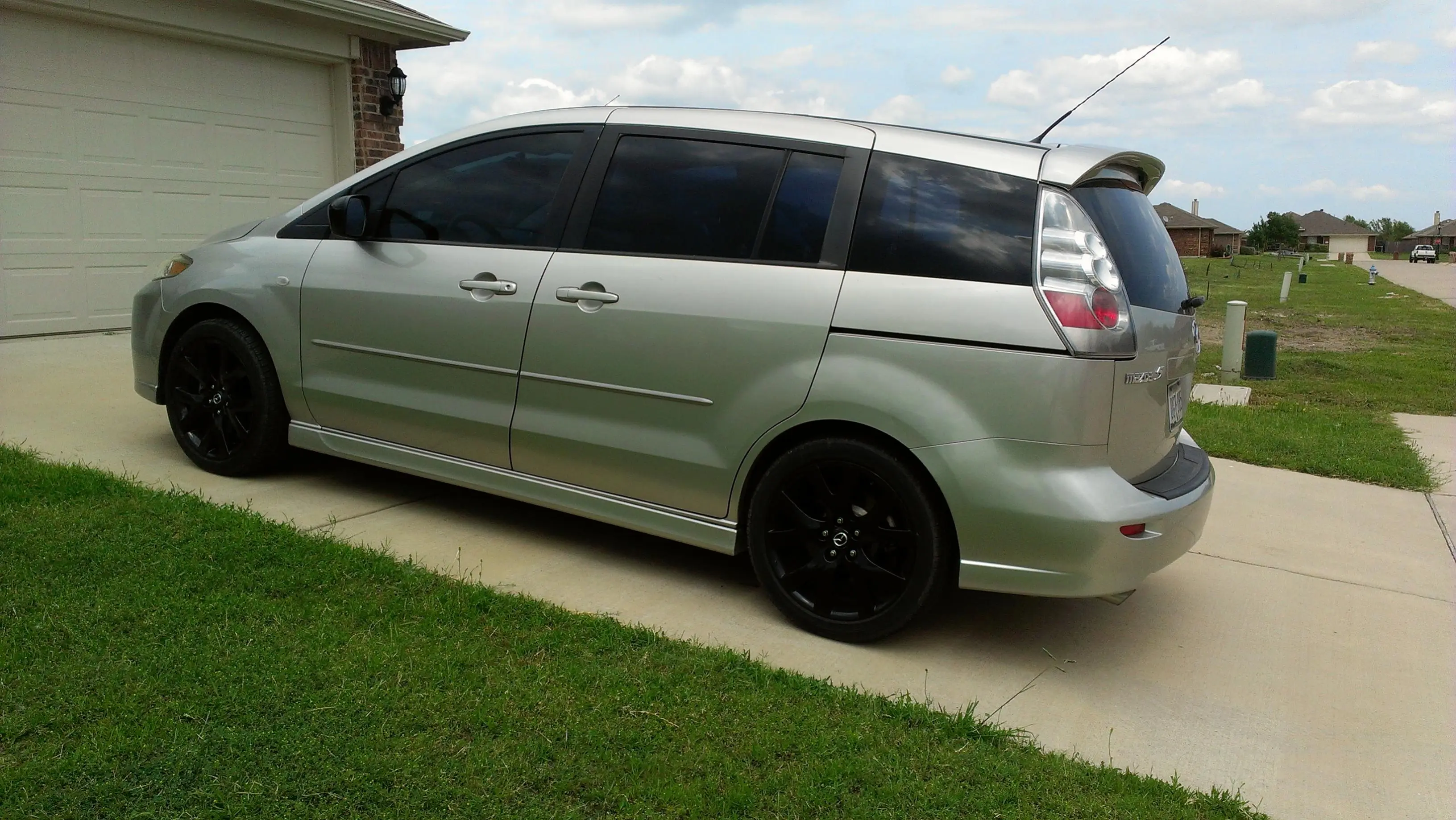

Oh yeah and my mazda 5 has 18inch CX7 powder coated black wheels I almost did 20's but It's a family ride :)
