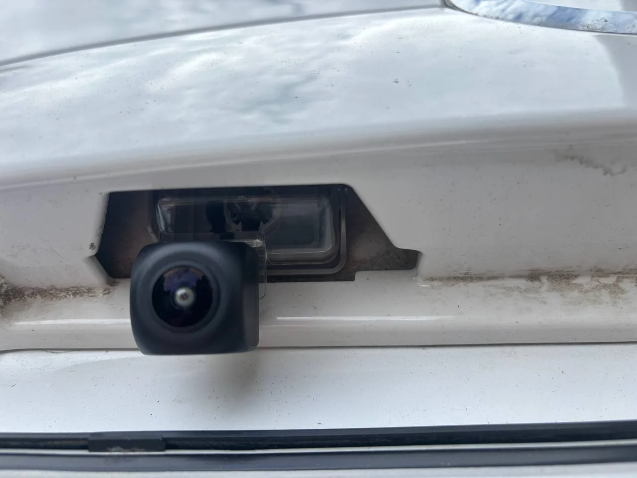

Just installed a reversing cam on my EU 2016 CX-5.
The camera is a no-name one I got off Taobao, but it works well. I mounted it where the license plate light goes, removed the license plate light cover, and it slotted in fine. Drilled a small hole in the base to run the cable through. Only issue is there’s no rubber seal on the camera, so I’m a bit concerned water might get in and cause rust inside the tailgate. Might seal things from the inside later.

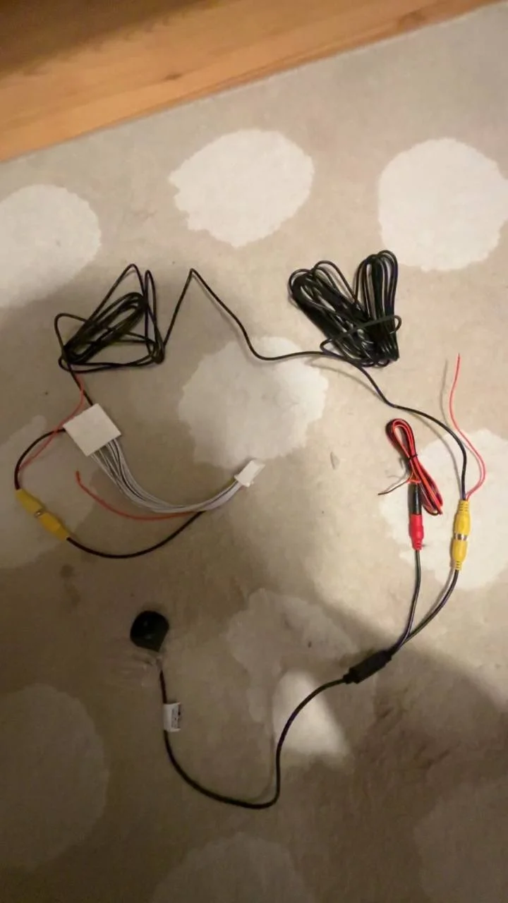

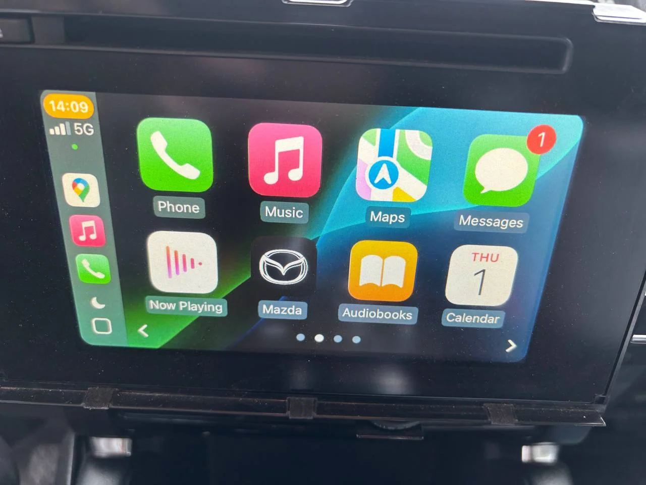

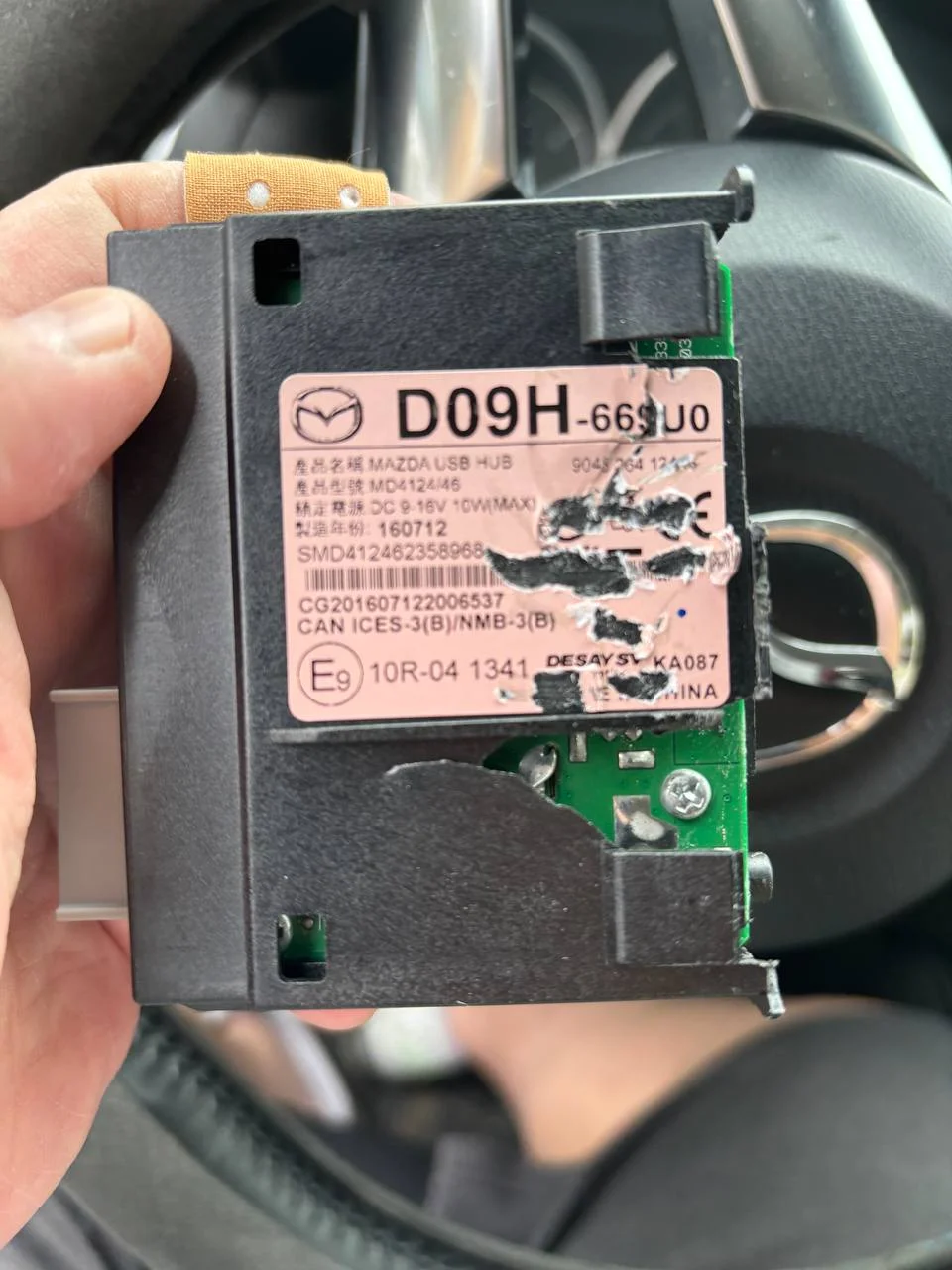

Wiring was simple. While I was at it, I replaced the USB hub with the alibaba model so I could get CarPlay working. That part works great now. The old USB hub didn’t survive the removal though — cracked total.

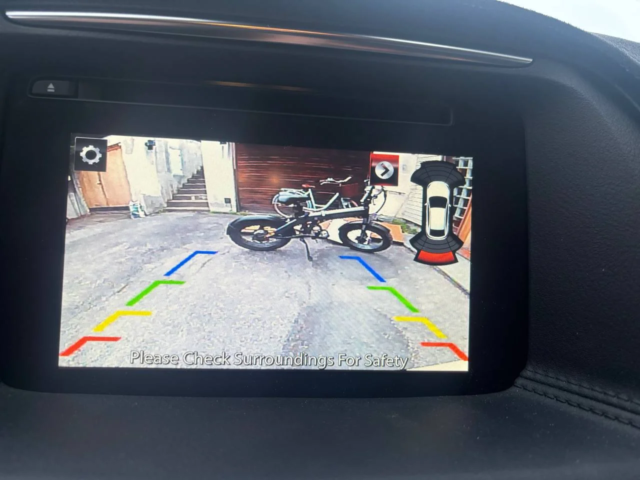

Camera image is good, totally usable,but no dynamic tracker lines. Still better than nothing, and the install was easier than I expected thanks to all the forum posts out there.
