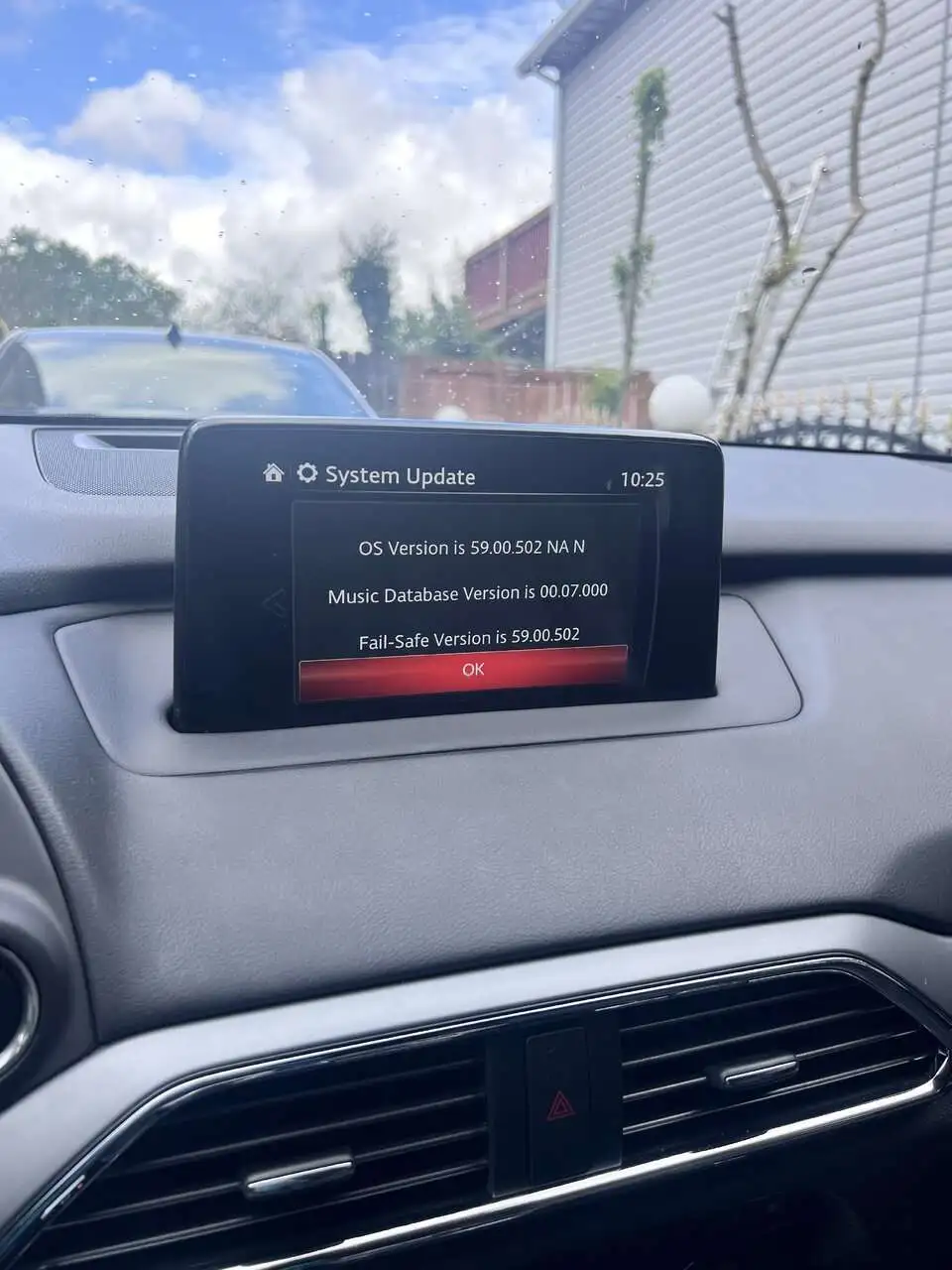

I can’t find ASH8 anymore in here. Does anyone else have the info I need to do a firmware update on a 2018 CX9? Current version in picture.
For future firmware update requests:
When you request the firmware update, list your current version, and you'll receive a PM from a member who will provide instructions relevant to your current version.
If your firmware version is below 55.00.650 NA N, you'll have to flash the failsafe first.
