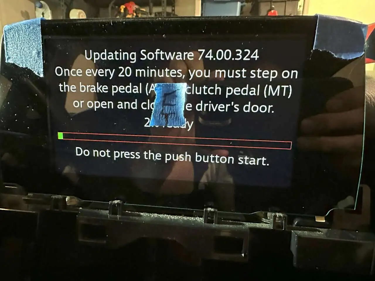

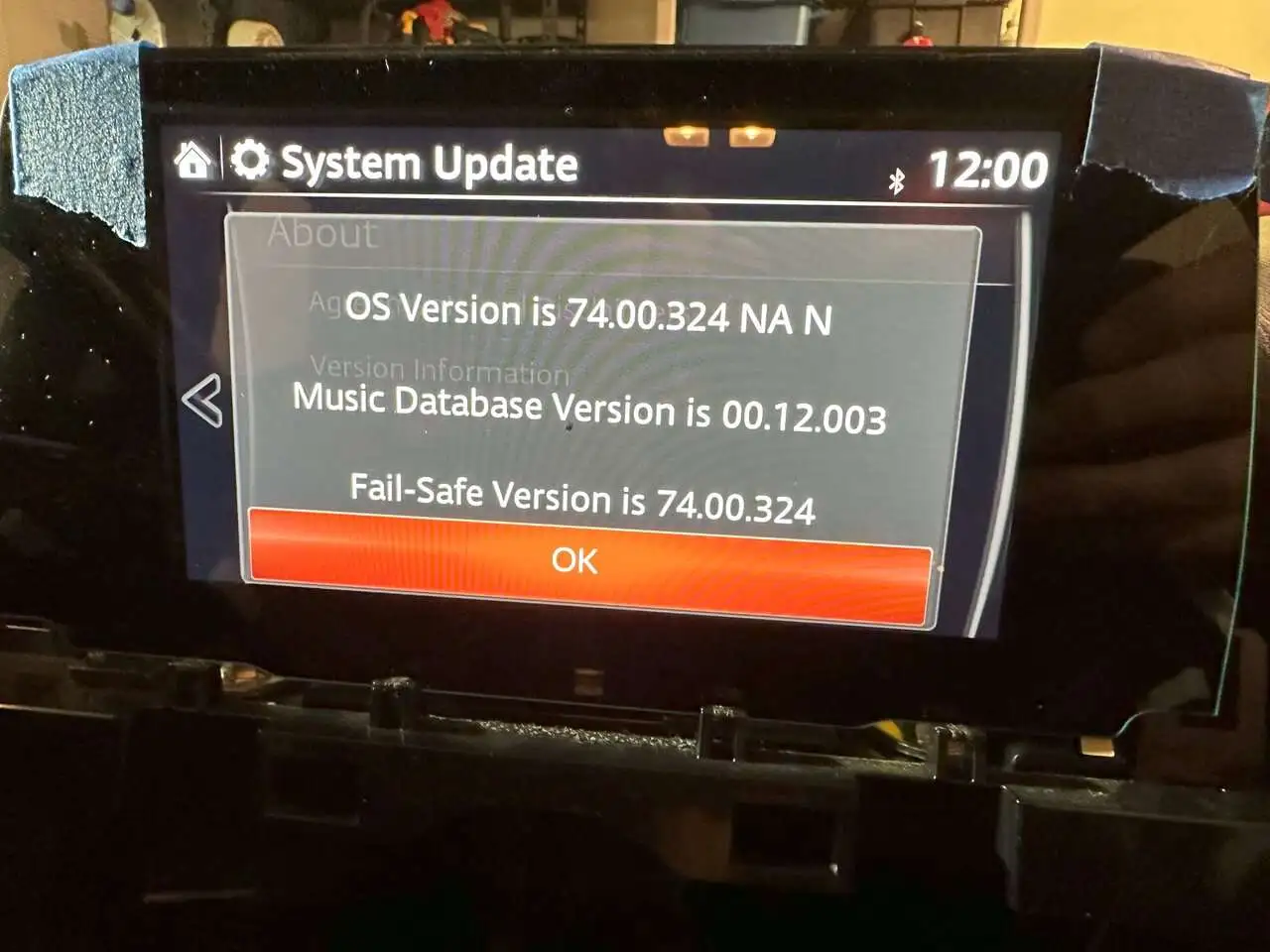

I thought I should report back on my little bodge as maybe it will help some other poor 2017-2019 Mazda 6 owner who has ghost touching but wants to update their firmware.
The short version is that it worked as seen here.
Longer version steps:
1. I purchased a replacement touchscreen for a 2017 CX-5 from ebay for ~$25.
2. I removed the CMU following one of the youtube videos on how to do it.
3. I disassembled the CMU and removed the front plate with the touchscreen attached. I had already disconnected the ribbon cable before this, so make sure you disconnect it if you haven't already.
4. I connected the new CX-5 touchscreen ribbon cable to the board
5. I used painters tape (non-conductive) to hold the touchscreen glass over the display
6. I reinstalled the CMU into the car and started the update procedure.
7. On the step where you check the status of the CMU, I used that opportunity to map out where the Enter and Clear buttons would be activated on the CX-5 glass, and then used some painters tape to mark just above it so I would know where to press during the actual procedure. The touchpoints were almost directly in the center of the screen, which was surprising.
8. After that I just followed the steps and everything went well.
9. Removed the CMU and removed the CX-5 touchscreen. Re-assembled the CMU with the original touchscreen which you leave disconnected to keep the bad touchscreen disabled.
10. Installed the ACP kit, cursing like a marine while routing the new cables through the trim.
11. Reinstalled CMU and all trim pieces I had off for the routing.

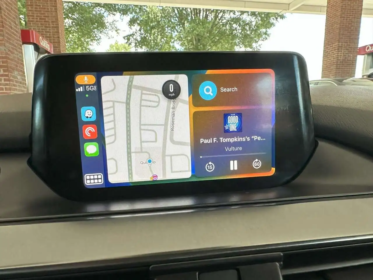

12. Enjoyed having ACP working as I went for a little test drive and refuel.
Thanks to all the groovy people who make these sorts of DIY projects possible.
