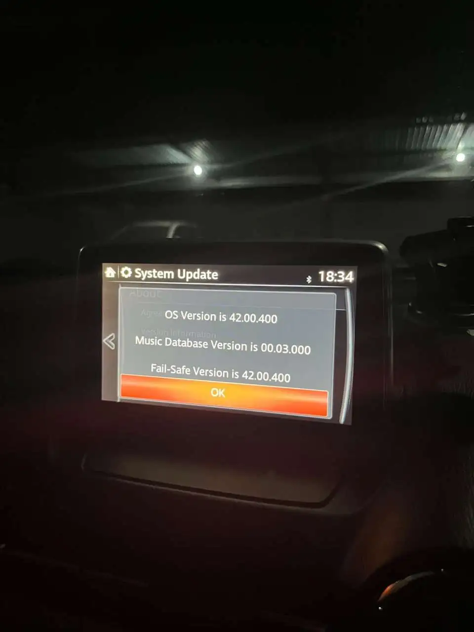

hi,
Bought the carplay upgrade module in Aliexpress for my Mazda 2 year 2015, but looked at my current firmware now I'm a bit confused, it shown just 42.00.400 with no region characters at the end; which region is it?
Can someone also help me to provide the right firmware to able to use the carplay module?
thank you

hi,
thank you
additional info: I bought this car in Indonesia, so I guess the OS should be Asian version?
