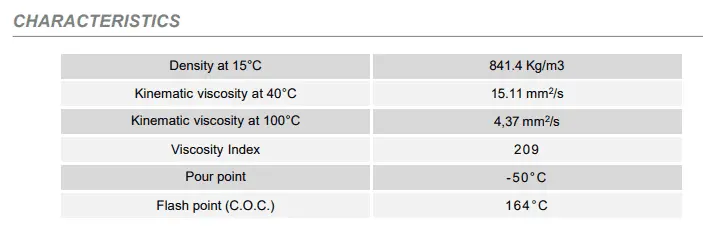

See attached chart for comparisons.

Interesting. Notice how all the ULV tans fluid has about the same Kv/CsT @ 40C & 100C except for the Mazda A7 @ 40C ? I'm wondering now if the 15.11 Kv @ 40C is a mis-print for the Mazda A7.

This chart was supplied to me from TOTAL, if it were a typo then the viscosity index would also be incorrect, which is possible but they are usually great with the info they provide. It has a very robust additive package and for all purposes looks to be very high quality from what I've been shown.
Ya, if that is a good number, I fully agree. I just wonder how TotalEnergies accomplished that.
