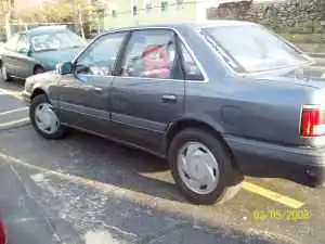

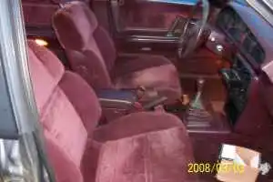

Hey whats going on... I am a honda guy but just recently bought a 88 626 turbo because I needed a cheap car and got it for 350 bucks (115k miles).... but after buying it I realized the thing actually has some power lol but anyway I was wondering if anyone on this forum is familiar with them and can tell me what upgrades I could do to it that are relatively cheap... I know they sell a chip on ebay for the 2.2 motor but it says 89-9? mines and 88 I was wondering if it would work or where I could get one because on google I read that the ecu only allows 12.6 pounds of boost if anyone can help me out id appreciate it thanks NiCk
