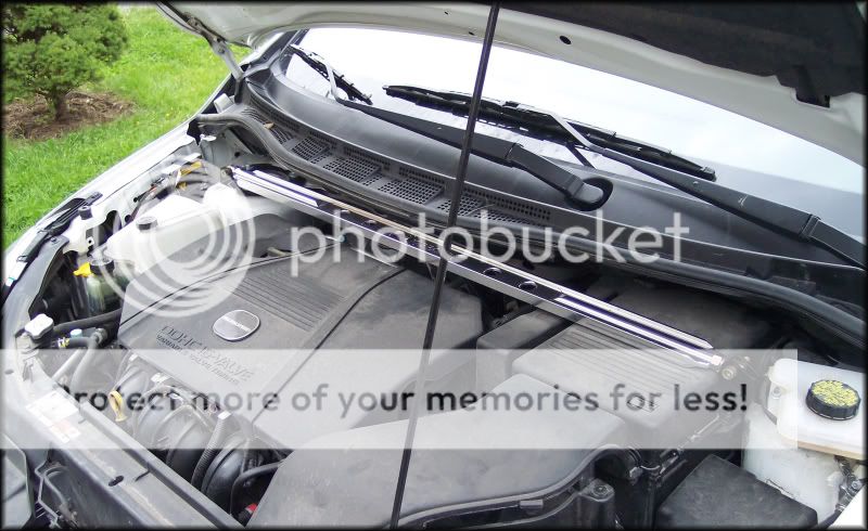

Mazda 3 Strut bar are bolt-on on our 5. Installed mine about 2 months ago. I have the Vibrant model.
I guess the question is "does it really change anything or just look cool". Its just a question... would be seeing if any technical specs can be proven by the supplier? BTW the speed 3 does not have this bar...it only beefs up the tie offs to the firewall.
It makes a tinny difference. I got this for pretty cheap so i had to try this.
30$ and still looking brand new ;)
Thank you venom design... this answers my question.. :)

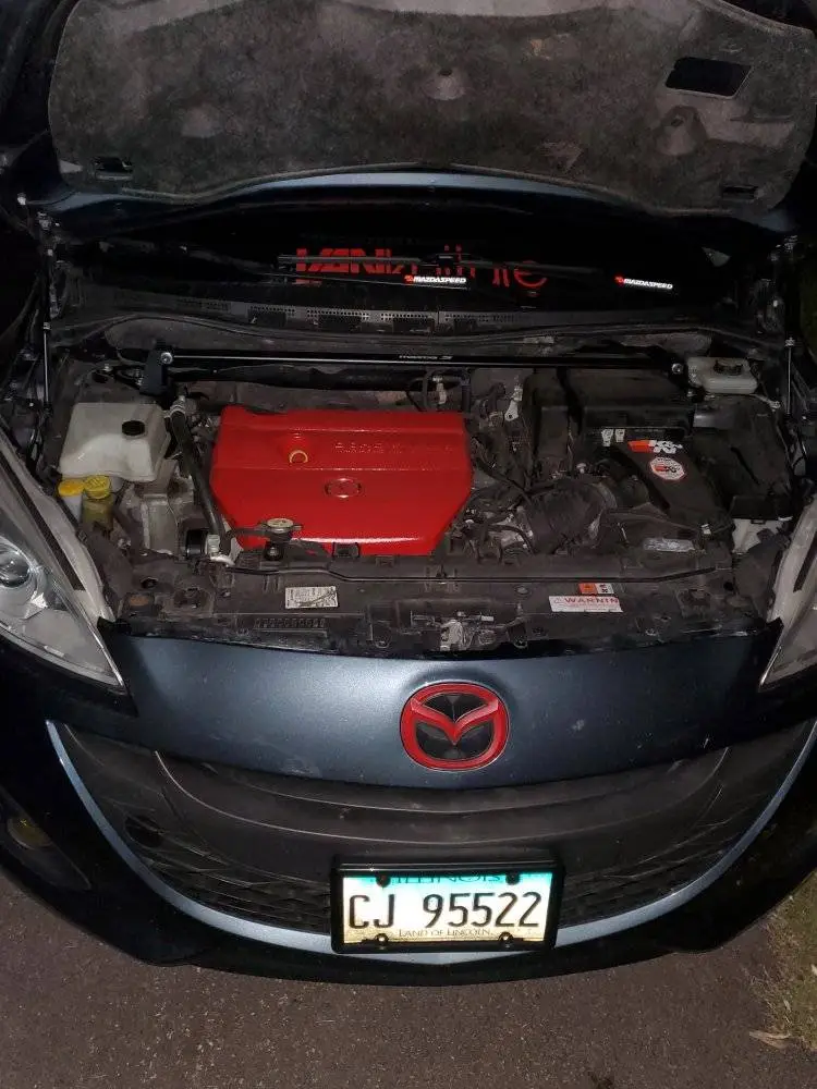

But it seems like it is already touching the battery cover... is it?
^ the guy above you bumped a 13YO thread and you're going to ask again if a bar between the strut towers does anything? :ROFLMAO: the sound of silence for 13 years seems to be a pretty clear answer. the name brands mentioned here are also all out of biz...
