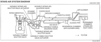

Anyone got a picture of ours? Like a cutaway?

I'll try to scan the pictures out of the Service Highlights Manual for ya.

Ok, here's the pages right out of the service manual. First picture is of the whole system, second is how it operates.
The engine speeds are different for the 2.0L (4,600rpm) but operation is the same.
