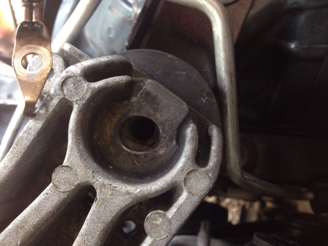

Replacing the Rhs top hydraulic engine mount in my nieces Mazda 2 as its flogged. Got a replacement and put it in and read the manual after . It says not to remove the mount bolt that fastens the engine bracket to the top of the mount !!!!
Can I install the bolt without stuffing the new mount what torque spec etc ?
Also the engine mount bracket is elongated as the picture shows . Is this normal ? Can I get an after market replacement bracket if so where from ? 20160502/4b93c069125a175cac25d61b11970841.jpg[/IMG]

I think the vibration would be your engine mount probably the top hydraulic mount . I have not driven the car I'm fixing it's my nieces . Repairing it after a front end impact . I found the top hydraulic mount was stuffed excessive movement . I replaced it with one from eBay but the engine mount bracket was elongated as you can see . I drilled that out and made a collar out of mild steel pipe and fitted it in the bracket . All good now . Niece drove it and said the vibration has gone that it used to have . I've checked the other two mounts and they are fine . It looks like an issue that they do the bracket as well as its only soft alloy . That's why Mazda sell the mount with the bracket attached at around 300 dollars . Hope this helps

I'm replacing the passenger side engine mount, but the replacement i bought is just the mount, not the bracket that actually mounts to the engine. The service manuals say not to loosen the bolt that connects the bracket to the mount, but will it actually cause me any issues if i do? And when mounting this bracket to the new mount, what torque?
