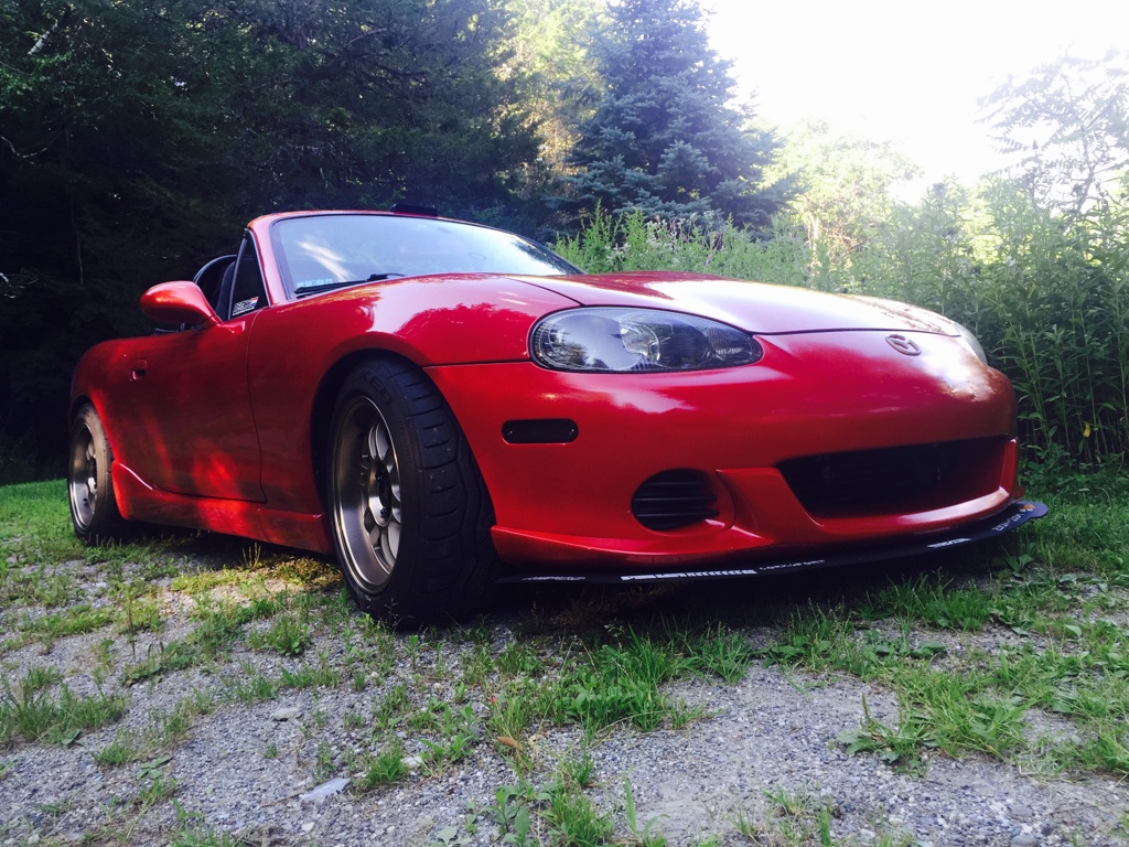

So, what do you have into this vehicle total so far? If you don't mind my asking.
not counting the vehicle cost...let's see..not a whole bunch...suspension, wheels and tires included probably 2,500$..all bolt on's (that includes many little bits as well, gauges/pods, lighting, o2 mod,wires...etc
That's it Mark? For some reason I thought it was a little more. You better start moving if you want to catch up to what you had invested in the P5. ;) haha
Ya, maybe a little more but not much, I got many of the parts new/used at highly discounted price too
