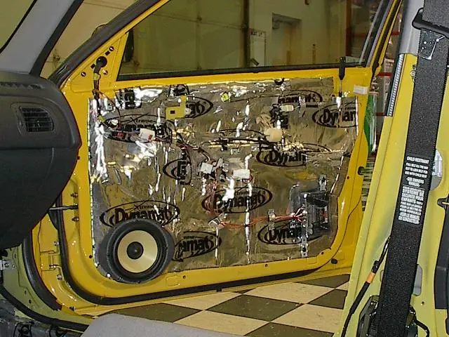

Dynamat IS a VERY good product. You don't require much of it to deaden a door or trunk. It's quite pricey but it sure does work!
While Dynamat is the best sound deadener out there, I am looking to add several layers of the stuff to dampen my speakers and the road noise. On all four doors, the floor, and the hatch I would be looking at about 100 sq. ft. and that cost too much for Dynamat. I looked up sound deadener showdown and it list the most common types and brands. I think I will go with RAAMmat because it is a butyl based and has a decent temperature tolerence.

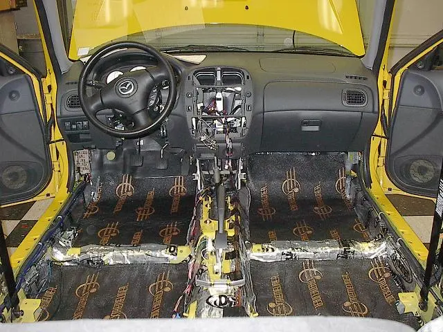

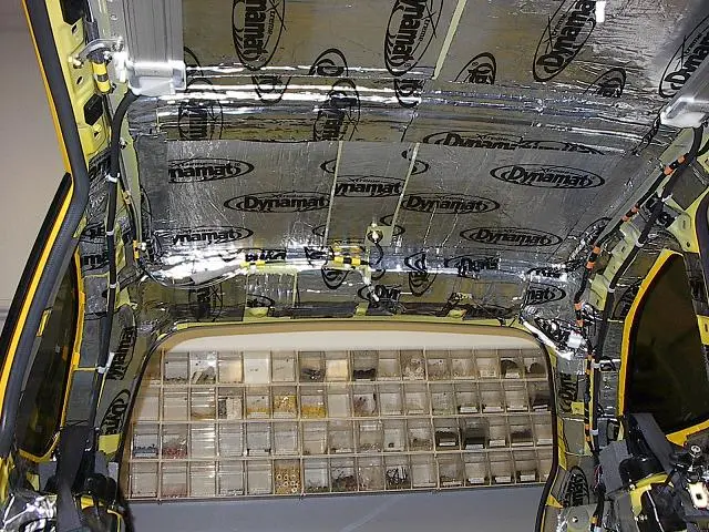

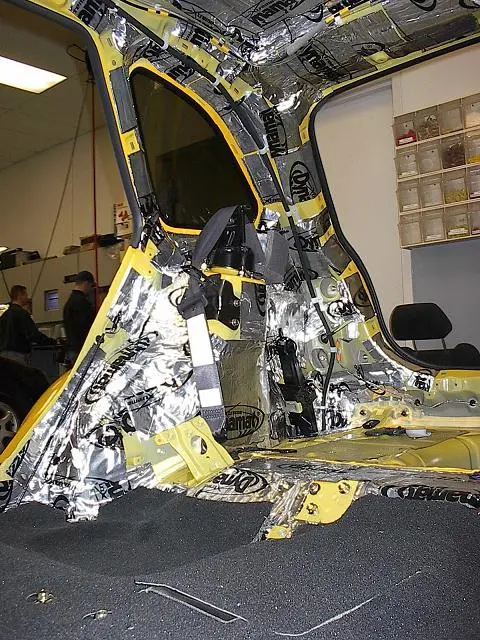

I did mine with Dynamat-- but I had not done any research on the stuff before hand.. Dont get me wrong, it did a better job than I had imagined.. but next time I will use Raamatt for cost effectiveness..
I used about 110sq all one layer and on the floor I added a mat to help with noise. I Dynamated the Floor, Roof, Hatch, Wing, and Both inner and outer skins of the doors..
Road noise was cut in half-- before it seemed hard to talk to a passenger and after it was a piece of cake.. No rattles at all,, not even the liscence plate. The roof had a lot of flex when the bass hit, but never rattled, even with the sunroof open..
Have fun,
Billy

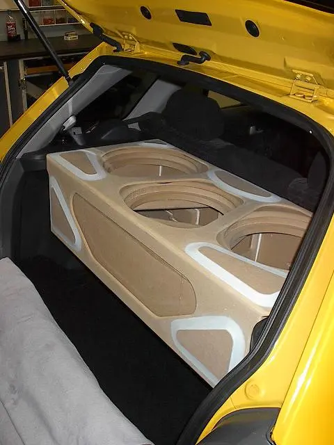

Ok, another update. I just replaced my sony bandpass with a ported box with 2 12' RF P2s. Now my watch even rattles.
