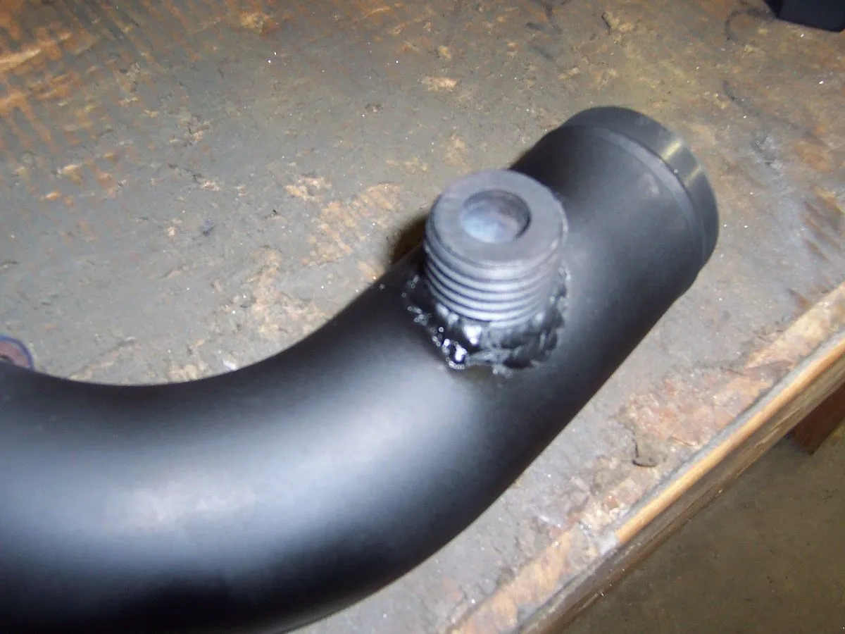

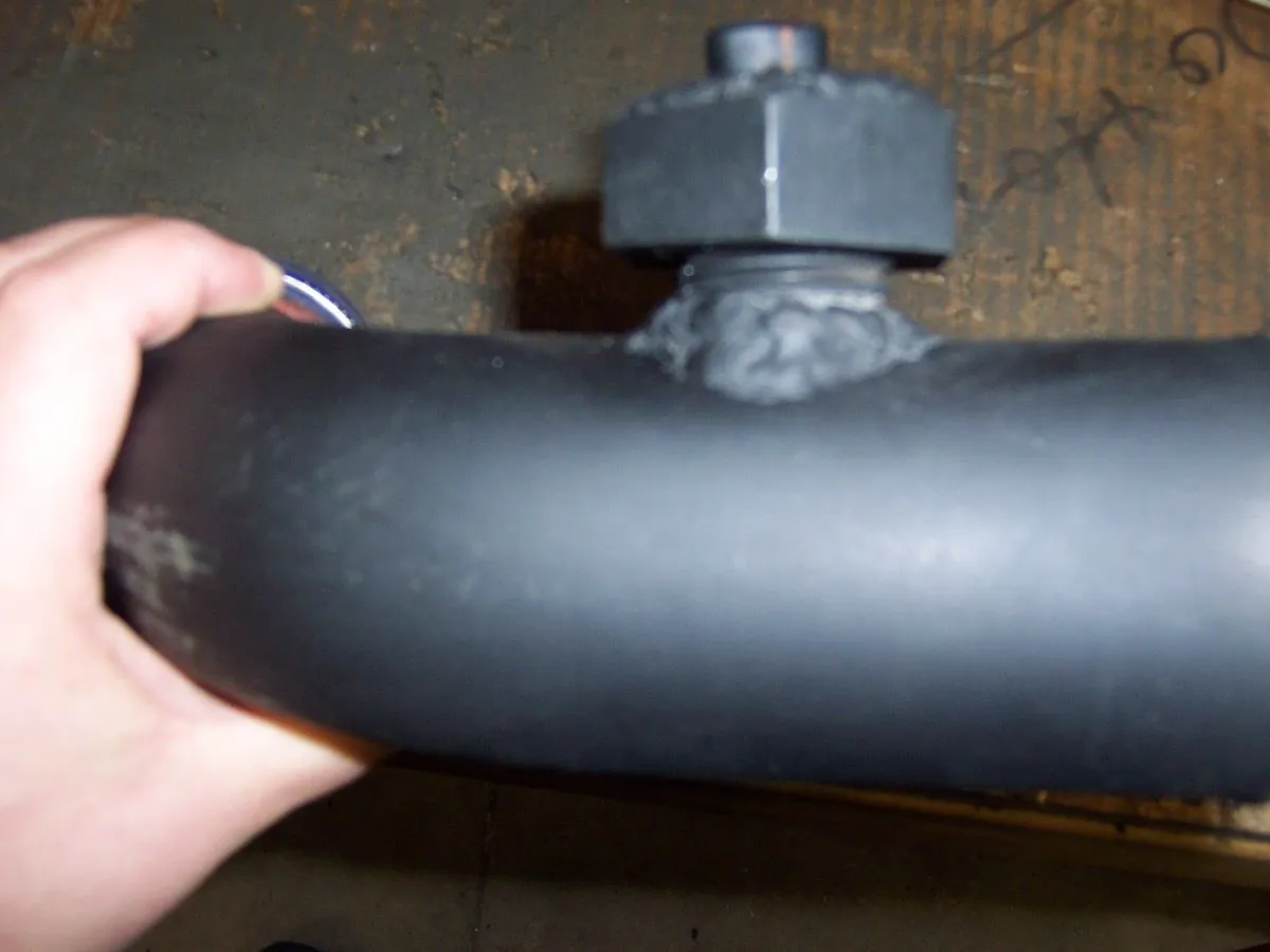

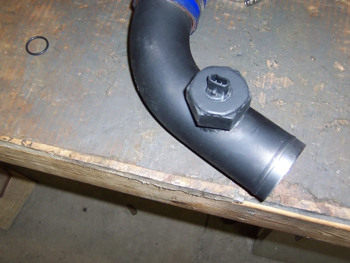

How did you seal the IAT on the cold pipe? I'm guessing it took more than the factory grommet?
ok this is what i did. first off on the hiboost kit, the one bend is made from mild steel. i took a 1 1/8" diameter bolt and cut about 1 inch off the threaded end. drilled the center out so the sensor would fit through. then took the matching nut and welded a big washer on for a flange. drilled the washer out so it would fit the sensor through. then welded the bolt to the pipe and drilled through in the pipe. then i took a rubber o-ring and used that as a gasket, then just screwed it together. oh yeah, i also had to cut the nut down alittle.
