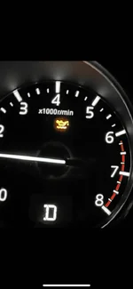

I just changed my oil, 4.5 quarts of oil, but the low oil level light is on? I have no leak. The light only goes on when I drive more than 5 miles. Any ideas?
What is the oil level on the dipstick? What year is your Mazda6? Does it have the 2.5 turbo engine?
I don't know what MY your Mazda6 is, but that light, according to the 2020 Mazda6 Owner's Manual, is a low oil level warning light, indicating that the oil level is at or below the MIN mark on the dipstick.

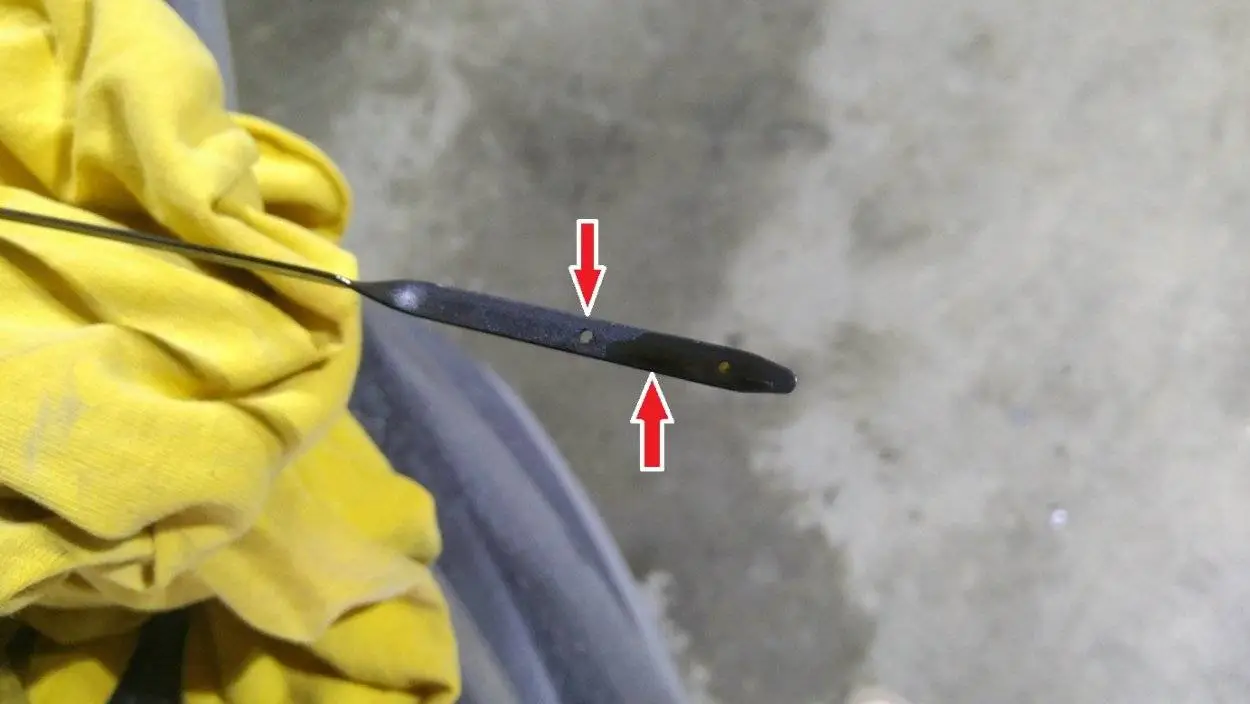

Fill the oil until it is anywhere between the center of the two holes and the top hole (refer to the picture below).
As @Silly Wabbit said, add more oil and check the dipstick until the oil level is where it needs to be. It's not enough to simply add 4.5 quarts and call it good, the amount is an approximation (as explained in the manual) and doesn't account for drain time, oil dilution or oil consumption.

Yes. Looks good, light still on. I added 4.5 qts during the oil change. Is this normal for the light to still be going on?
I hope you found the answer to this. If not, here is what I found. I had the same thing happen in my last oil Change in our 2020 2.5 CX5-G. I changed the oil, the filter, and added back 4.5 quarts of 5W-30 oil. The dipstick was very strange in that one side would remain dry while the other side appeared to be over full...I checked it a couple of dozen times in disbelief, but it persisted. Finally after a lot of frustration, I just went ahead and added the final half quart from the 5 quart jug of Mobil 1, and the oil was exactly midway between the high and low holes on both sides of the dipstick. So, apparently my CX5-G takes 5 quarts of oil, not the 4.8 per the manual and website. The hardest part is that last .5 quart completely changed whether the dipstick read completely strange to exactly between the high and low holes. Very strange.
It is almost like Mazda put the Turbo oil pan (5.1 quarts) onto the non-turbo (4.8 quarts) engine.
