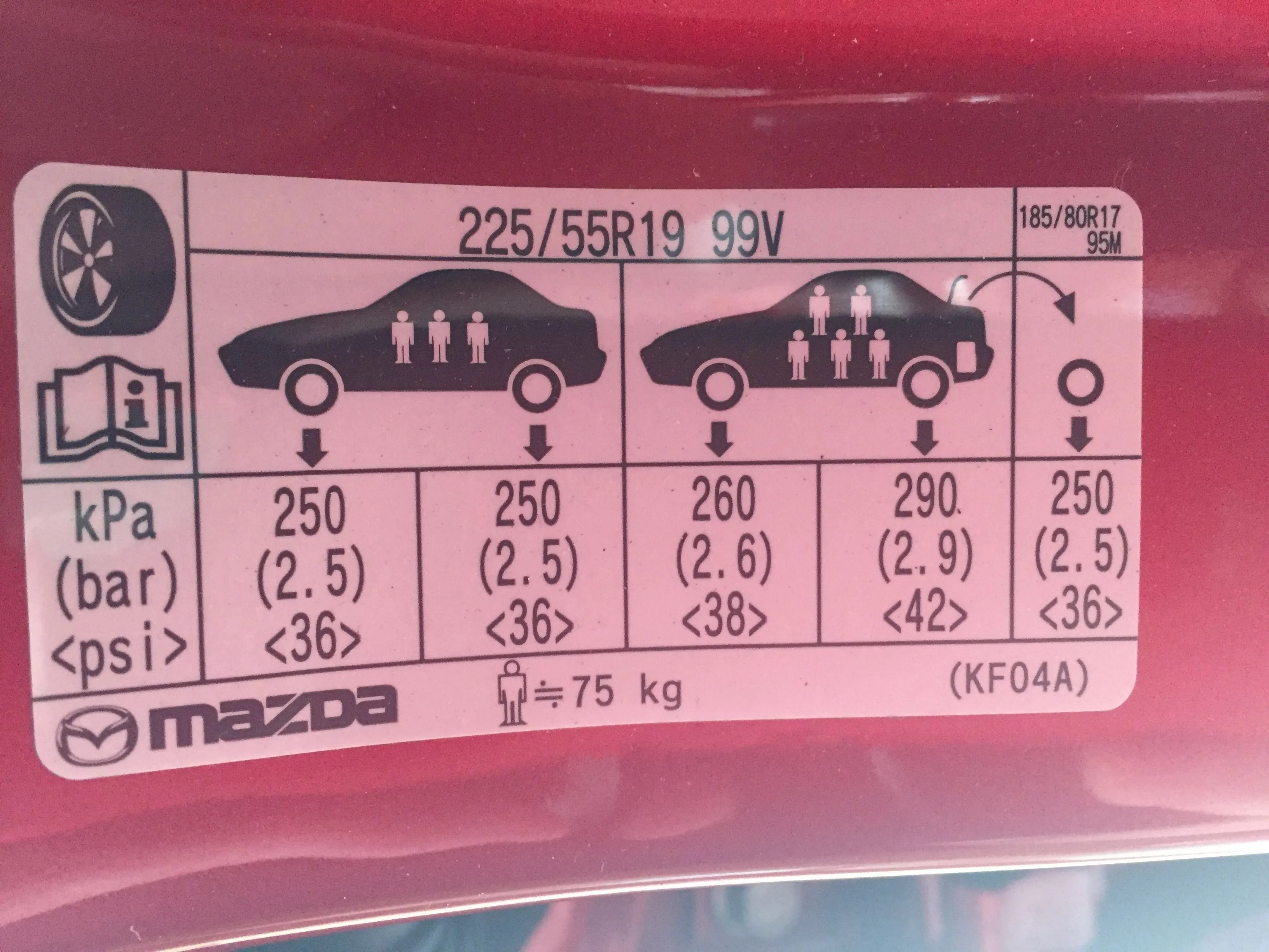

The OP hasnt stated what his tyre pressures were, or if he has checked and adjusted them recently. If they were down around 30-32 then there would most certainly be a measureable effect on fuel economy. And as we know, tyres naturally lose pressure over time, and may not be immediately obvious.
So, it is wise to regularly check tyre pressures because running low pressures is one of the most common causes of poor fuel economy - people often overlook the simple things in search of more complex causes.
Air pressure affects rolling resistance. Sidewall deflection etc.
Get a pushbike and ride it with tyres at lower than optimal pressure and see how it goes. Then pump the tyres up hard. Easier to get up to speed and keep there, and rolls further.
Same reason that car manufacturers recommend higher pressures when carrying a load.
Its physics 101.
On the 225/55/19's Mazda here recommends 36psi all round light, and 38 front/42rear loaded. See attached tyre placard from my car.
So running 38/40 all round is no stretch at all.
