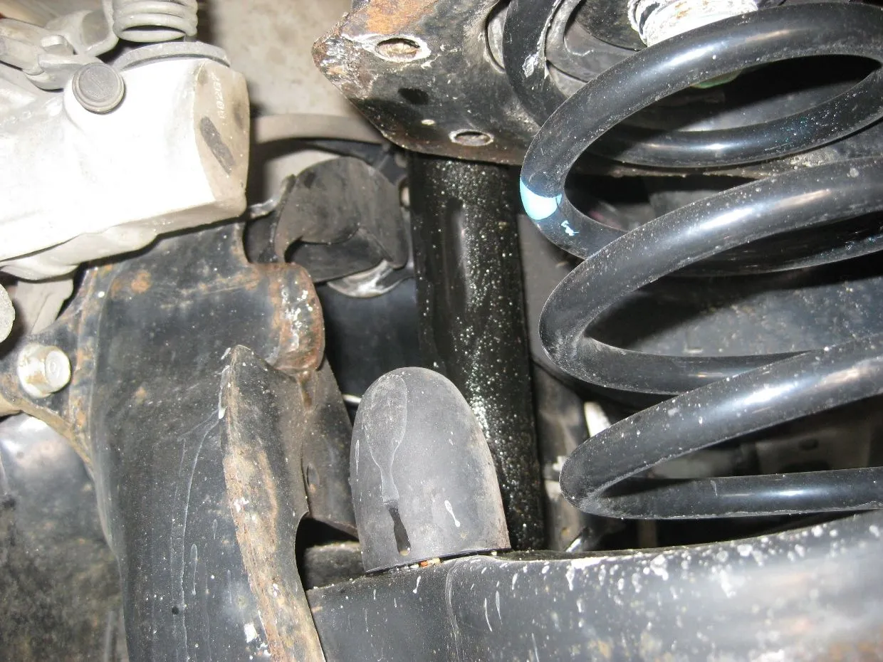

Sounds like the bump stops are rotted/deteriorating and are causing the struts to bottom out. Have you taken the wheels off and inspected?

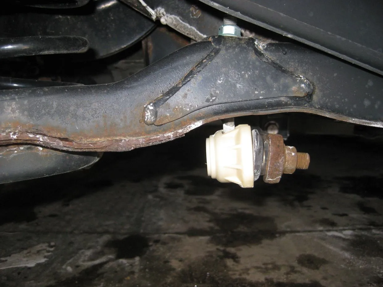

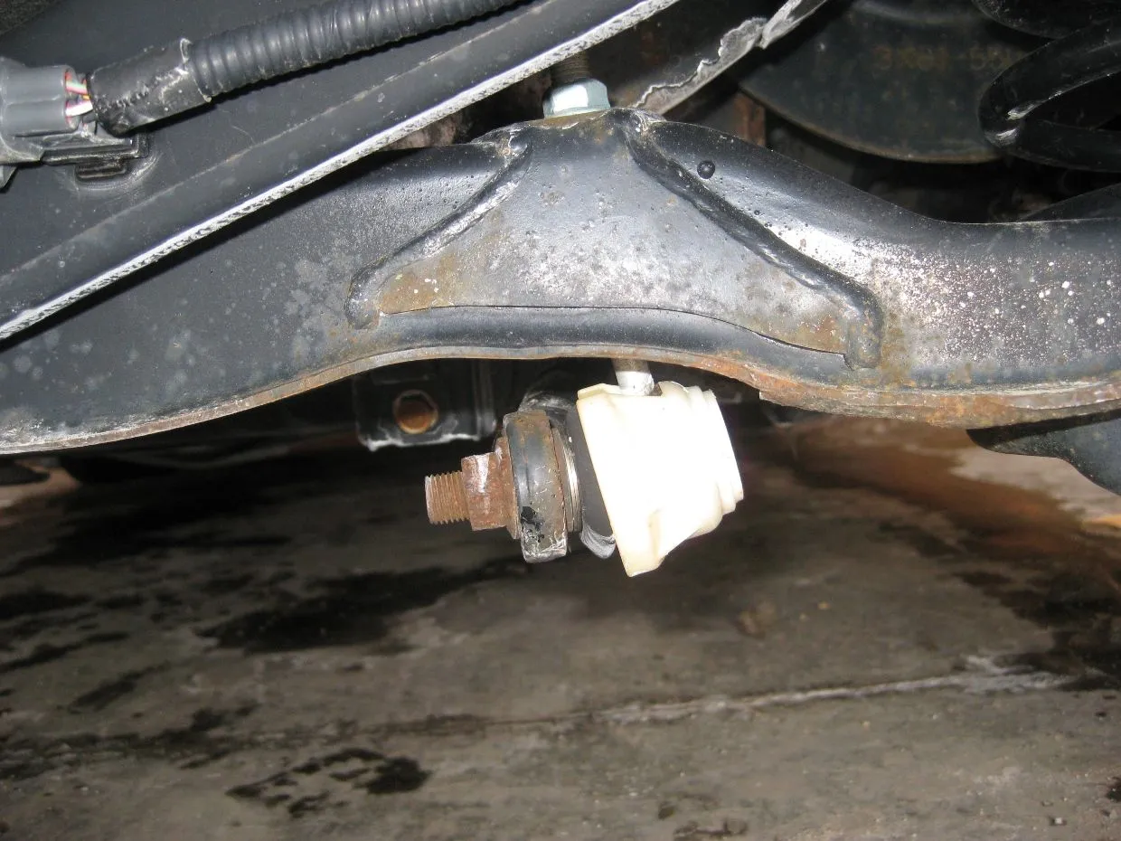

Sway bar end link bolts is the first thing I'd check. They tend to losen themselves up without locktite. Happened to me at 5k and I thought I was losing a shock the noise was so bad.

Actually I'm not so sure... On futher inspection the drivers side rear shock is definately blown. Oil pouring out (see picture). But what do you guys think about my sway bar end links? They look weird to me but I guess I've never looked before. The passenger side angle seems weird for sitting on flat ground?
I just had my tires replaced, and during the process, the mechanic noticed the same issue.. my end link bolts were lose. I thought it was only me :wtf:
Locktite to the rescue. It'll definitely keep those bolts tight.
gotcha
the clunky noise was no joke though. i thought my shocks broke
