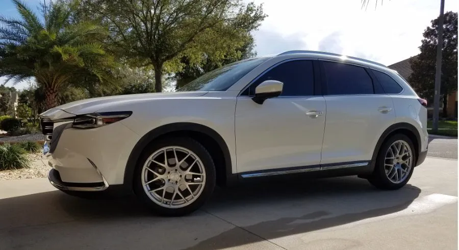

I finished adding Ceika 1M Coilovers Lowered 1 1/2”, Avant Garde 610 9” wheels and Michelin Pilot 255/45/R20 10” AS/3 tires, love it looks great, rides nice and handles much better.
I finished adding Ceika 1M Coilovers Lowered 1 1/2”, Avant Garde 610 9” wheels and Michelin Pilot 255/45/R20 10” AS/3 tires, love it looks great, rides nice and handles much better.View attachment 223602
Looks great. Those wheels are nice. Why did you go smaller in tires? Those Michelin tires are nice. Had them on another car of mine. Only thing is they wore out fast. Hopefully they last for you.
