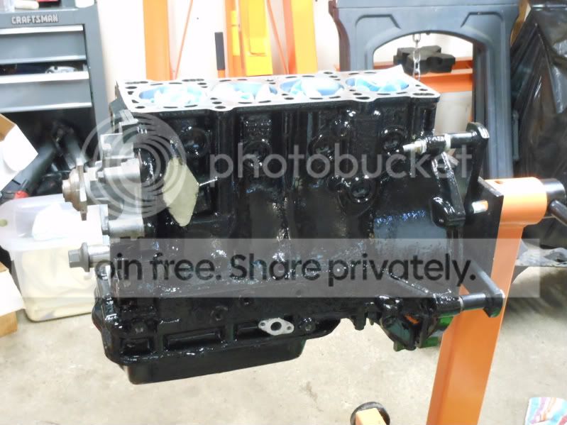

Here is the location of the factory oil return:
The fitting is basically a flange molded into the MBSP. If you're adding your own return, you can do it however you want. The cheapest way would be to drill a hole, tap some threads, and screw in the fitting of your choice. The proper way would be to have a threaded bung welded in. Either option will work, but if you tap your own threaded hole, consider the location carefully. The walls of the MBSP are fairly thin in some areas, and you probably want to make sure that the return dumps straight down into the oil pan instead of landing on one of the flat surfaces of the MBSP.

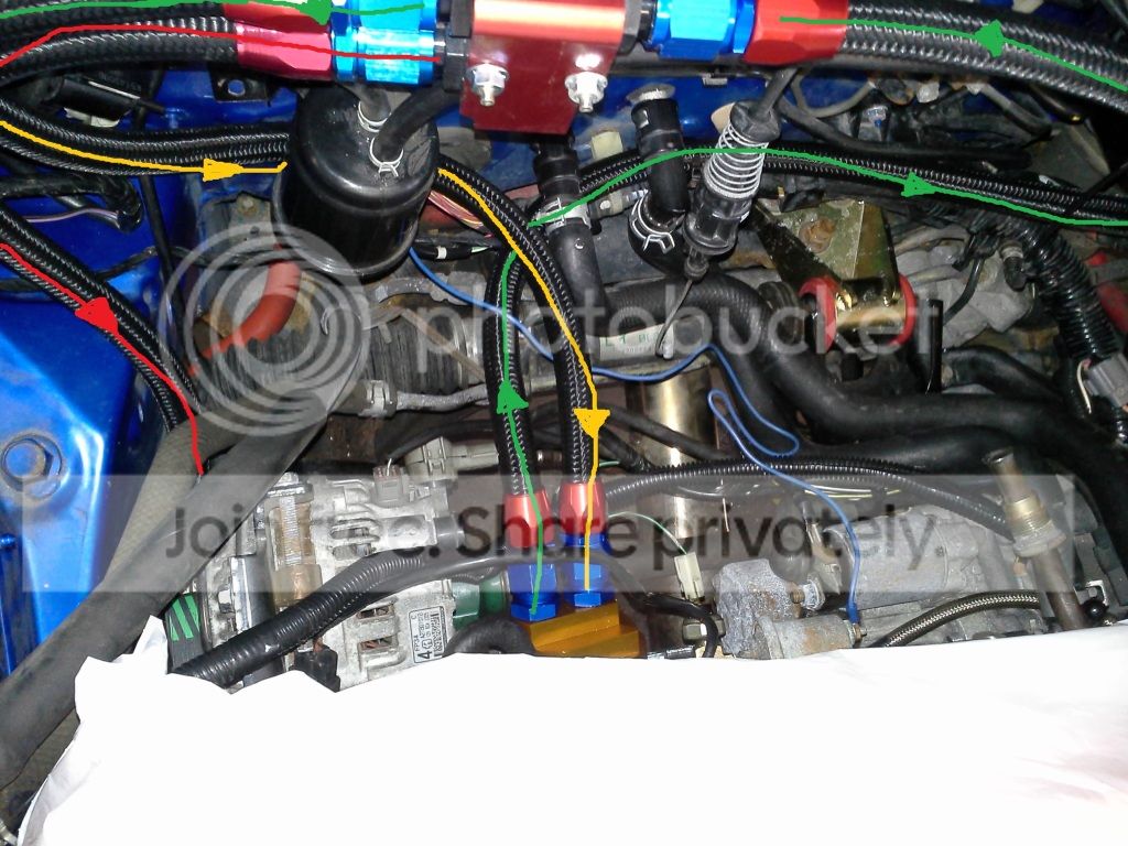

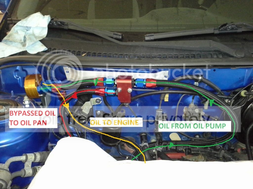

Also, in case you care, here are reference pics of how I routed the oil return lines when I installed my DocB oil system:
Line routing 1
Line routing 2
Top down on oil return line

Just so I'm clear about this, the hole with the two-bolt flange boss on the front-facing side of the MBSP is the factory return point for the MSP turbo, correct?
I will need to check mine to see if it's been machined and plugged or if it has been left as-cast and unmachined.

Thank you for your reply with great photos and helpful comments!
Correct.
Your regulator return point seems like a nice out-of-the-way place with plenty of room to work. Is there plenty of metal to work with in the MBSP at that point if I should tap it for pipe threads or machine it for a threaded o-ring fitting?
I didn't take any measurements unfortunately, but in the location I used I felt plenty comfortable drilling and tapping--I believe it was a 5/8" NPT, possibly 3/4" NPT. It was a little thin on the top and bottom but being snugly between two of the oil pan bolt locations, there was plenty of material to the left and right of the hole. I believe I've seen a few other members use the same location.
