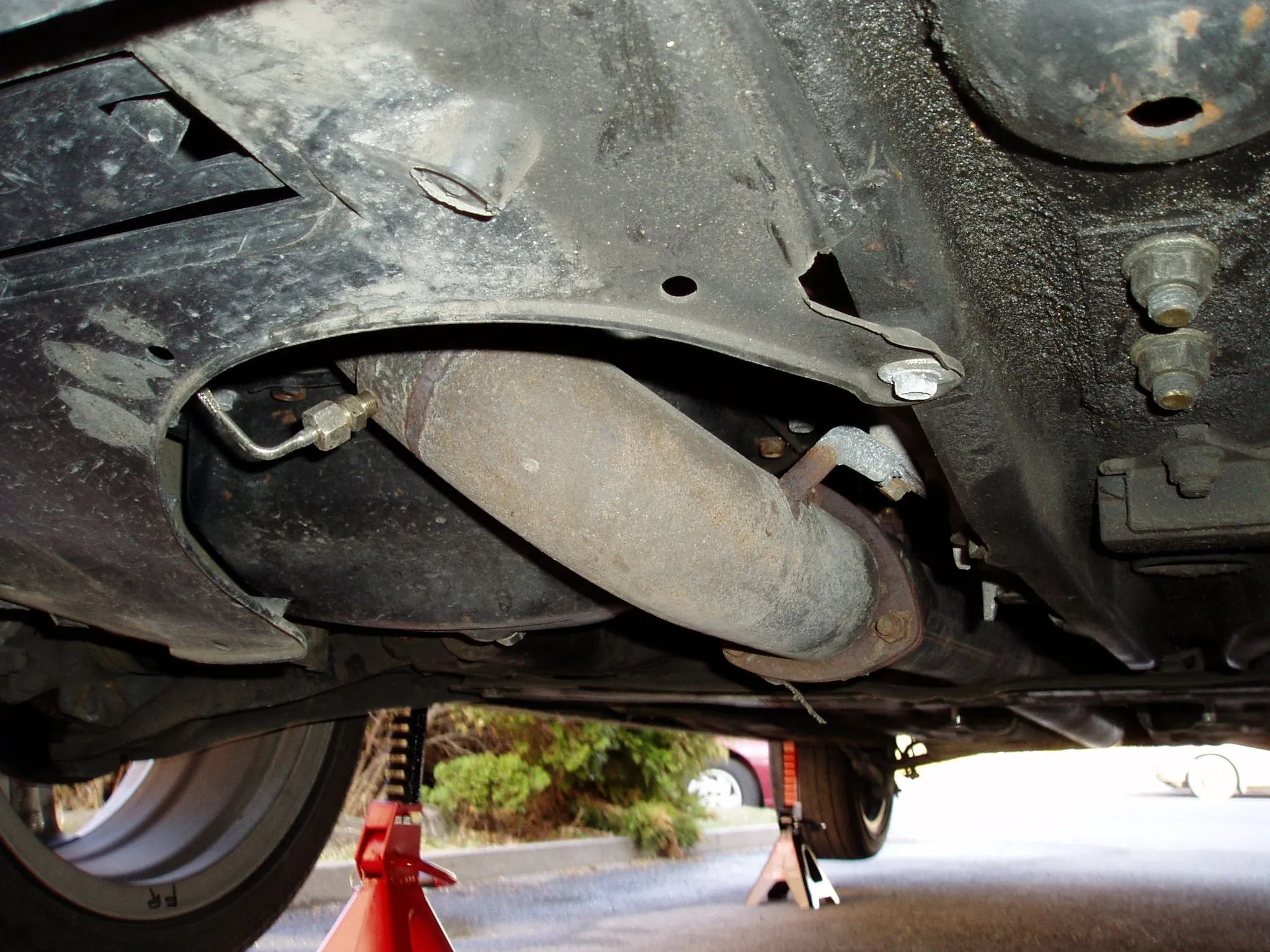

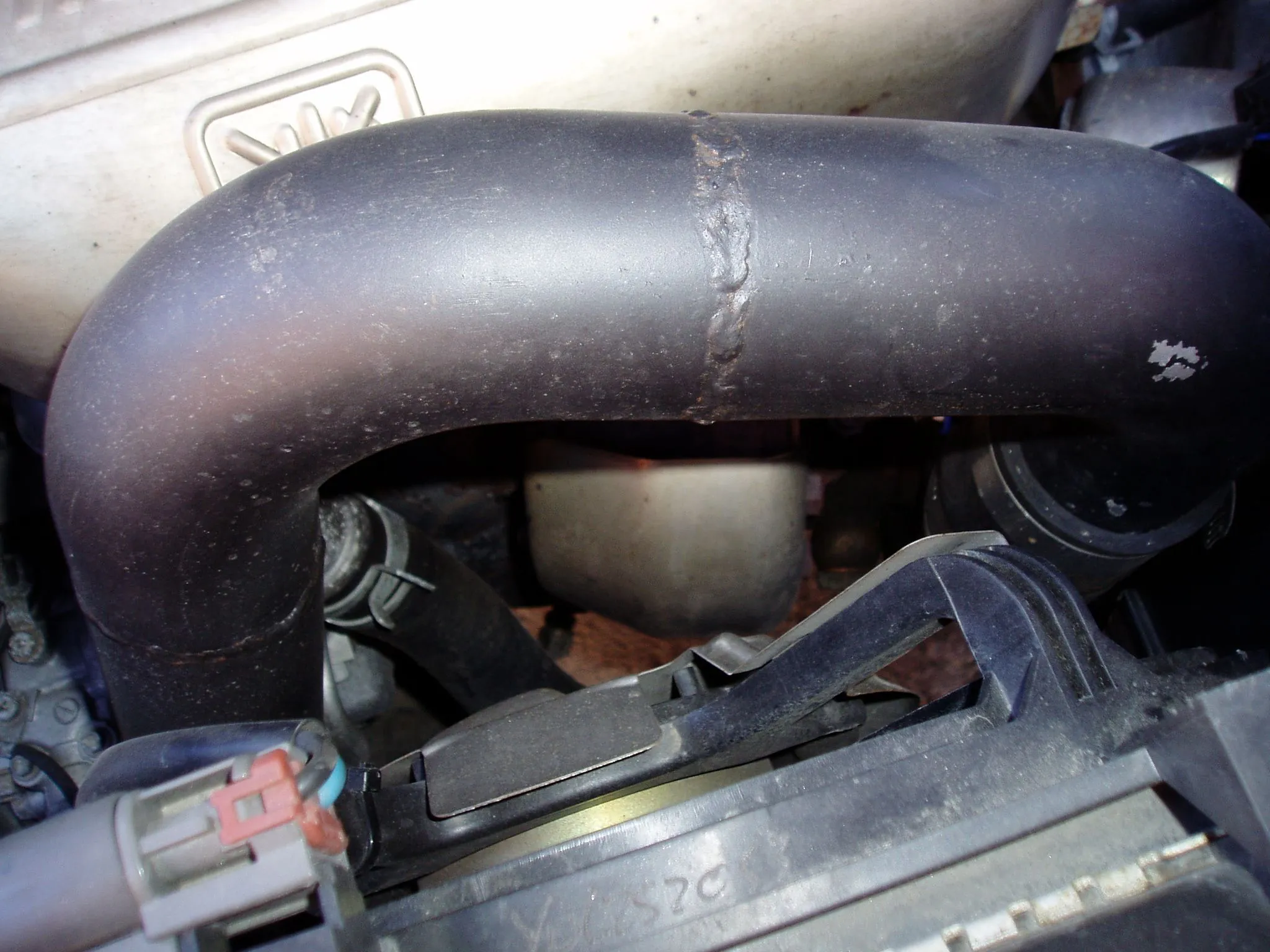

My EGT stays around 1100 degress while i'm driving on the highway and around 800 on idle (sometimes 700). Goes up to 1300 when i'm racing ... so it gives me a pretty good idea of what's going on ... i could take a pic for you if you want. It's in my downpipe, about an inch after where your J pipes connects to your S pipe.
i'll take pics of both tonight (where mine is and where on the stock exhaust i would put it).

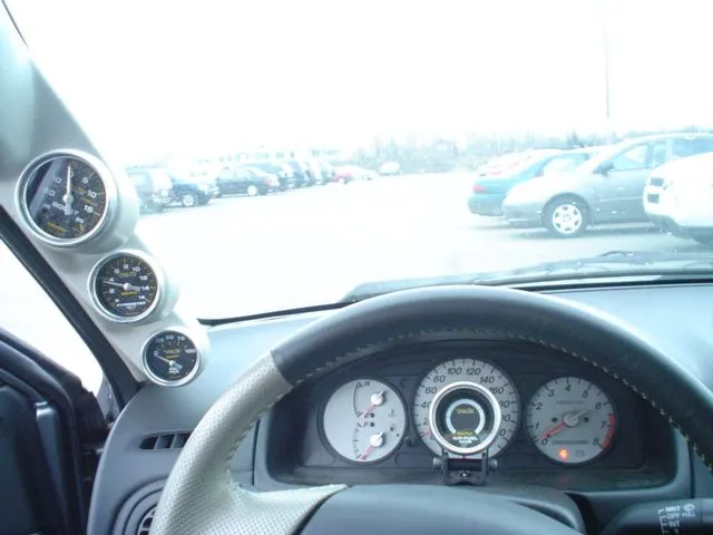

here you go
EDIT: the 3rd picture is from the top ... you can see it in the middle, under the turbo

It's a custom j-pipe or s-pipe + j pipe you have ??? looking good.

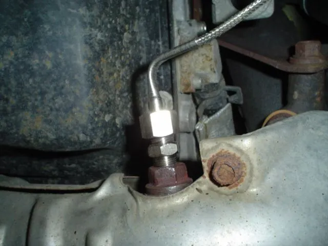

First ! I will try to put it in the j-pipe where we find a bunge with bolt covering it up. This bunge is where the non-turbo 2.0L have it 2nd 02sensor. it 's the same J pipe one on the MSP. Mazda have just put a blot on it. (screwy)

it's a custom exhaust ... my downpipe replaces the stock S and J pipes (between turbo and midpipe)
i think its a good spot to put it because the temp will never max out the EGT gauge, it'll never go up to 1600. Maybe Brian can tell us how high his goes since it's in his manifold ? we'll see if there's a big difference but i think that as long as you can see what idle temp is + regular driving temp + racing temp, then you know how long to let your car idle before you turn it off or you know when the temp is higher than it usually is
I have install it today, I will post pics tomorow. Now my gauge read higher that zero (cool) hhh

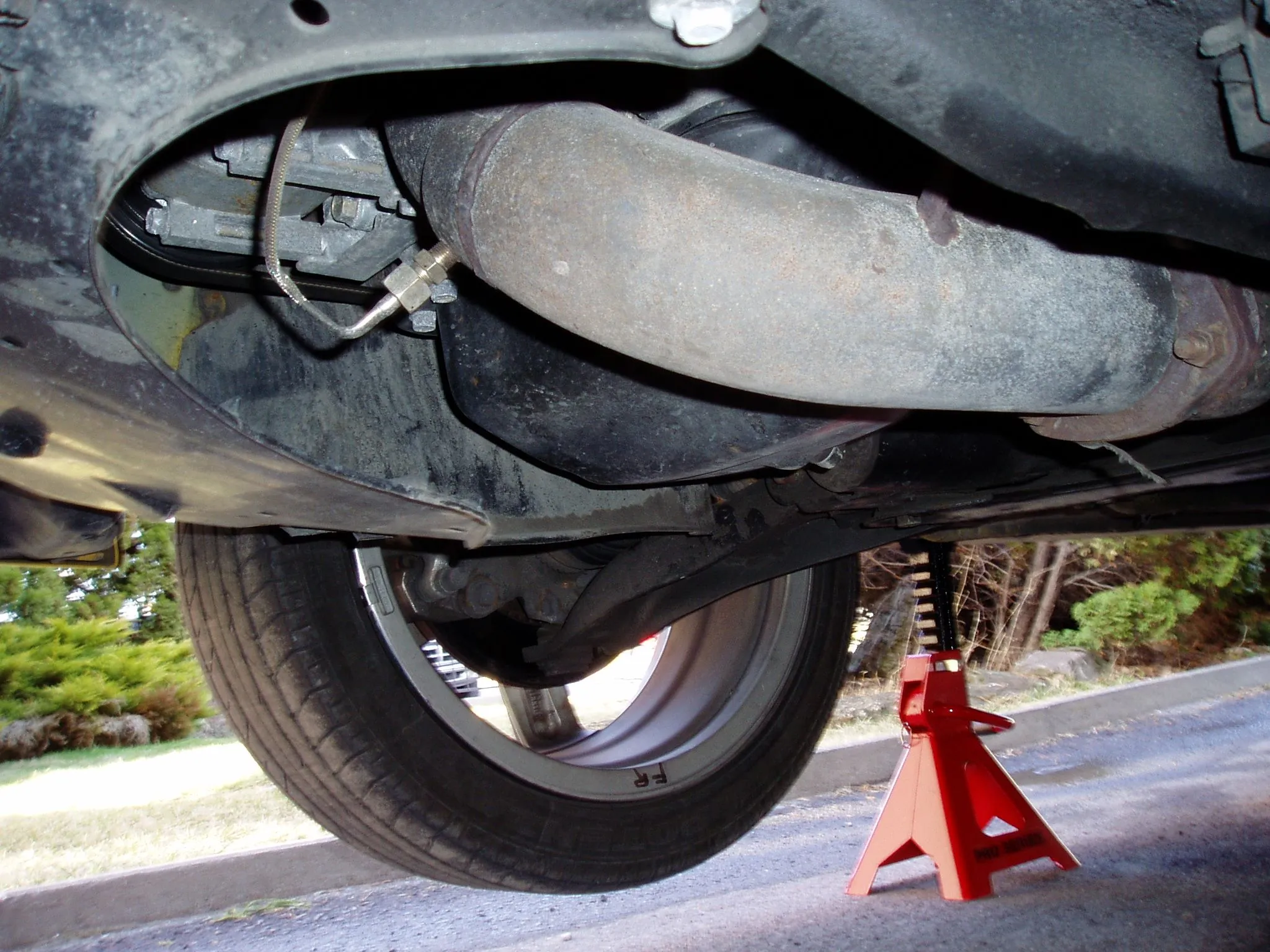

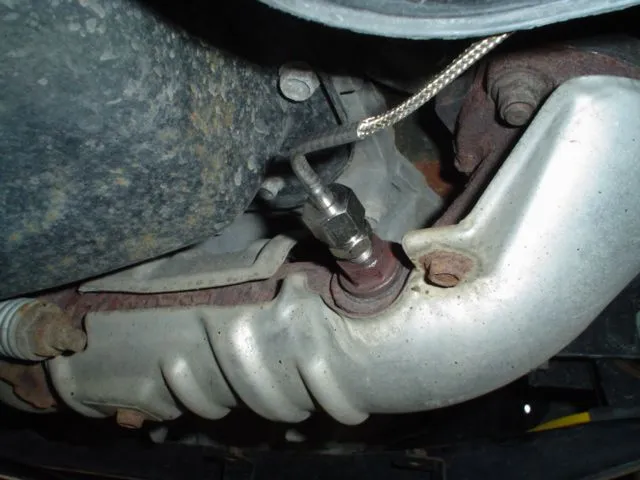

pictures
one is take on the right side, second under and finaly all my gauges is working now (cabpatch)
what do you think of my install ???

nice ... that pic of the EGT in the stock exhaust is EXACTLY what i was saying ... that's pretty much where mine is except its a different exhaust
