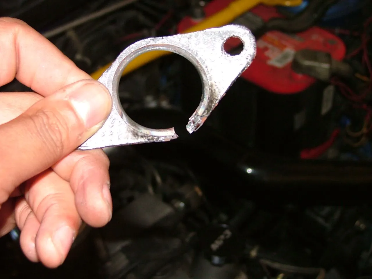

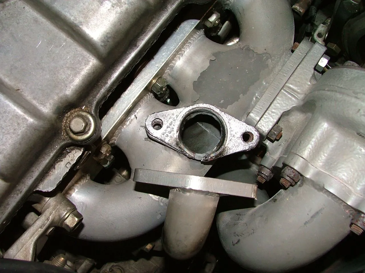

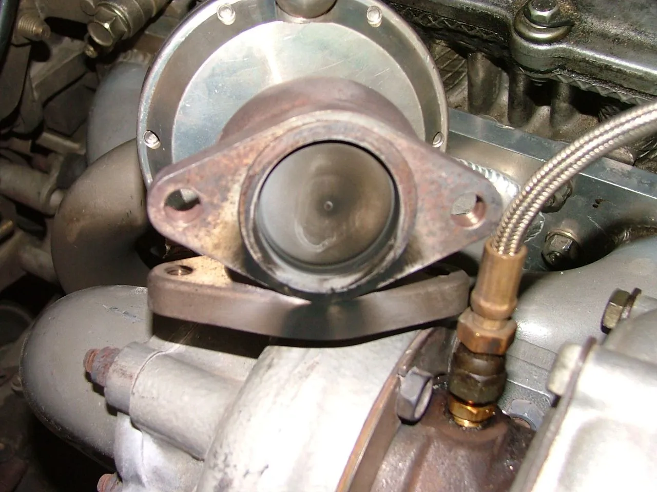

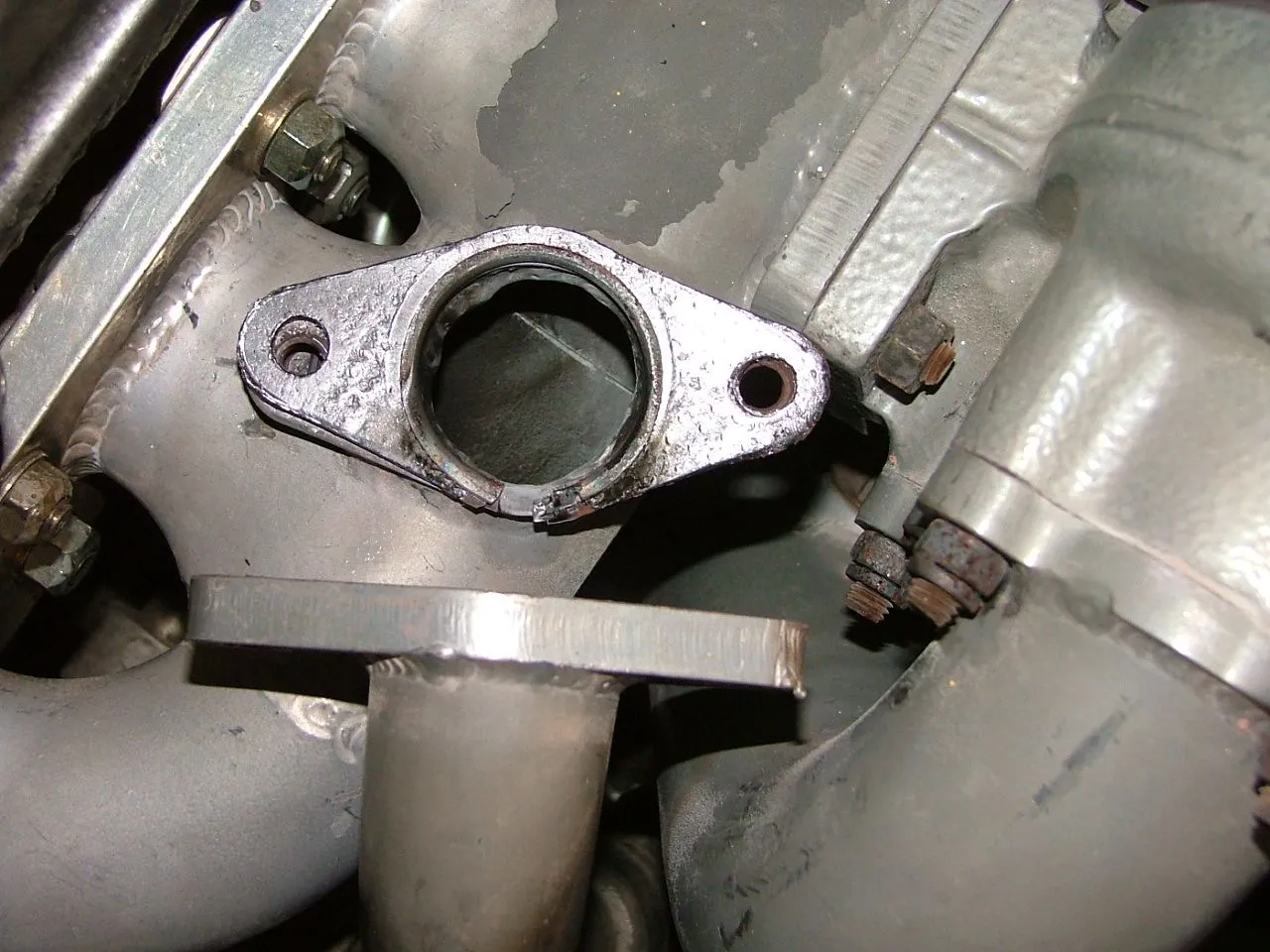

Ok Class...can YOU find my exhaust leak?
This is what can happen if you run too much boost on a log syle manifold such as this..:

Was running 14-15. The leak has been there for months, and I put this kit on in Oct, 2005, so that tells you how long the leak has been coming from there. Thought the leak was only from the exhaust manifold gasket... After that was fixed, I followed the clues that lead me to this venture.

My luck...hahahah! I know. But soon, everything will be fixed correctly. EVERYTHING!!! I think this manifold may be more restrictive than my old BEGI.
