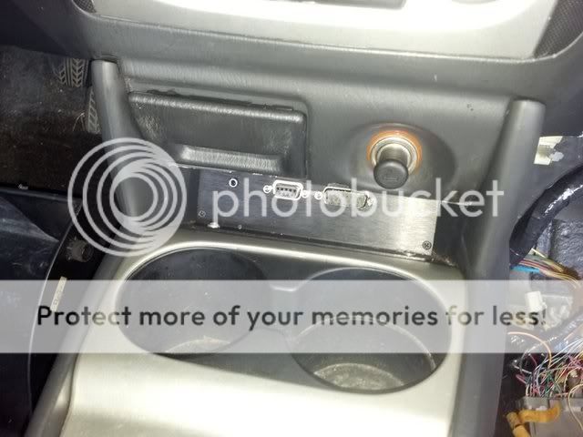

I mounted the MS in the cubby by the cup holders. I cut a notch out for the MAP vacuum line I still need to run to the engine bay but the harness reaches just fine and I can reach the serial plugs for tuning with ease.

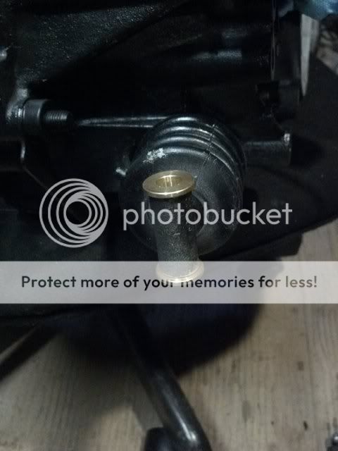

I mounted the CorkSport shifter bushings in the tranny. I'm not sure about the short shifter to install the bushings in it yet. I'll have to confirm with Shalon it is an OBX shifter and not an eBay shifter. I freaking hate those things. I had one snap in my old Civic so I've always used brand name short shifters since then.

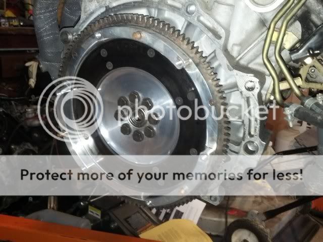

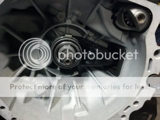

I got the Aasco flywheel bolted up (with some blue Loctite on the threads and torqued to 75.9lbs of torque as per the manual). I couldn't find my set of pressure plate bolts as I gave the to Wes when I sold him my old clutch. I'll snag them tomorrow so I can bolt up the clutch disc and pressure plate tomorrow. But I got the new bearing all greased up and installed.

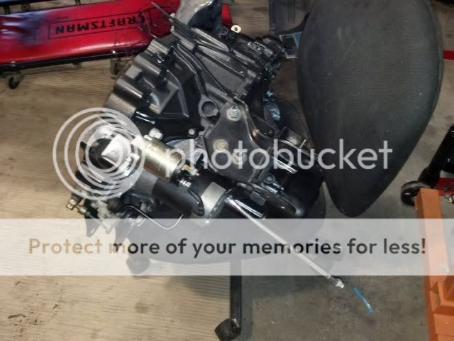

Here's the trans all painted black with the new starter and CorkSport SS clutch line.

its an OBX shifter....trust me if i didnt manage to break it yet i cant see there being any problem with it.
Awesome, thanks Corey. I'll keep it in there then. I'm sure you understand my hesitance and all, a short shifter is just something you shouldn't cheap out on and good to know she didn't. :)

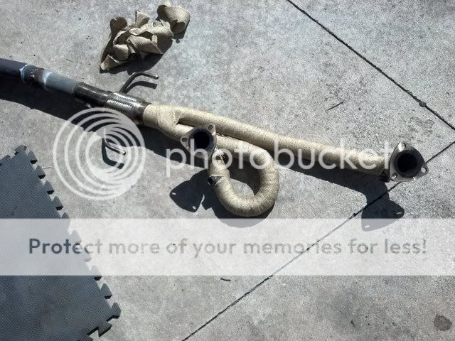

In the meantime waiting for Wes to let me know I can come over and pick up the pressure plate bolts (le sigh) so I can bolt the clutch up, trans together and put the motor in I wrapped the rest of the exhaust with header wrap Peaches gave me, thanks again, buddy! (2thumbs)

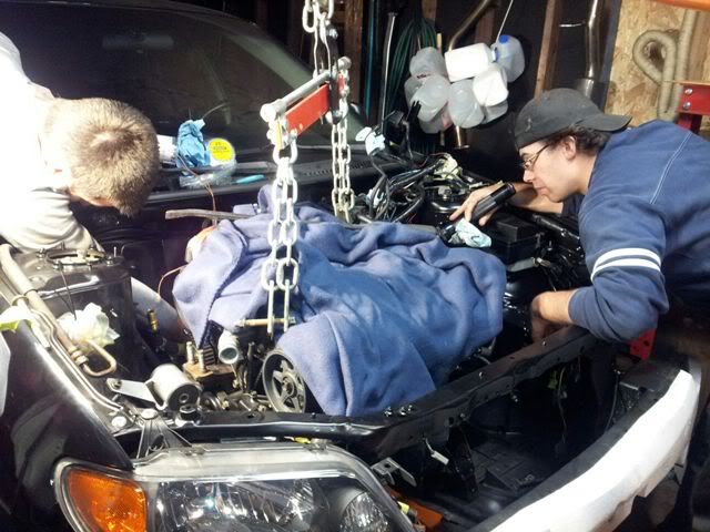

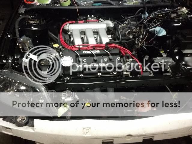

The motor is in! Granted temporarily though, just for mock up for the wiring. But now I have lots more to do and am very excited to get to work. A huge thank you once again to Ivan (fishdonotbounce) his fiance, Cara and my GF for helping out and for Wes for waking up at 3pm to my phone call. lulz

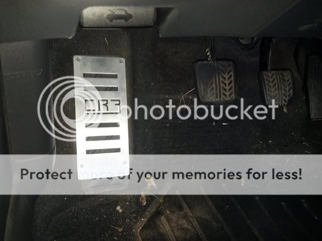

While waiting I mounted up the CR3 kickplate.

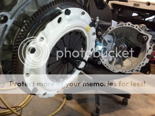

After some lunch we picked up the pressure plate bolts from Wes and mounted up the clutch (ClutchMasters Stage 3 from CR3 Motorsports, of course) to the Aasco lightweight flywheel followed by the trans. Of course, mounting the trans is always easier said than done, but we got it.

Boom! I'm pretty pumped to get to work on the wiring and getting her back on the road!
Haha! That last shot is Ivan playing "Where's Waldo".

Love the engine bay pic.
Caption should read, "we found the solution to you knock problem."
