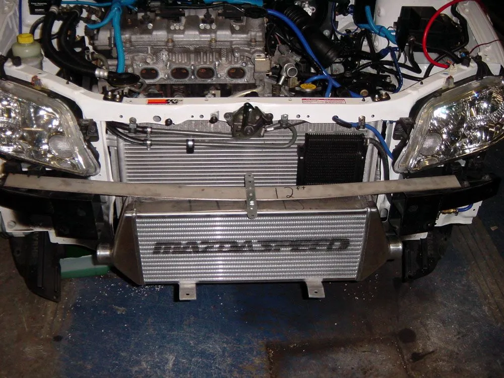

If you want a cheap solution that works but...well, doesn't look that...great. Go to an exaust company. Not like a Midas or " Name Brand " place, but a local with a bender. Get him to make some stainless parts, take some 1000 grit sand paper to them. Get em chromed and get some silcicon pipe connectors with some hose clamps. Cheap Zoom Zoom without leaks. Later
