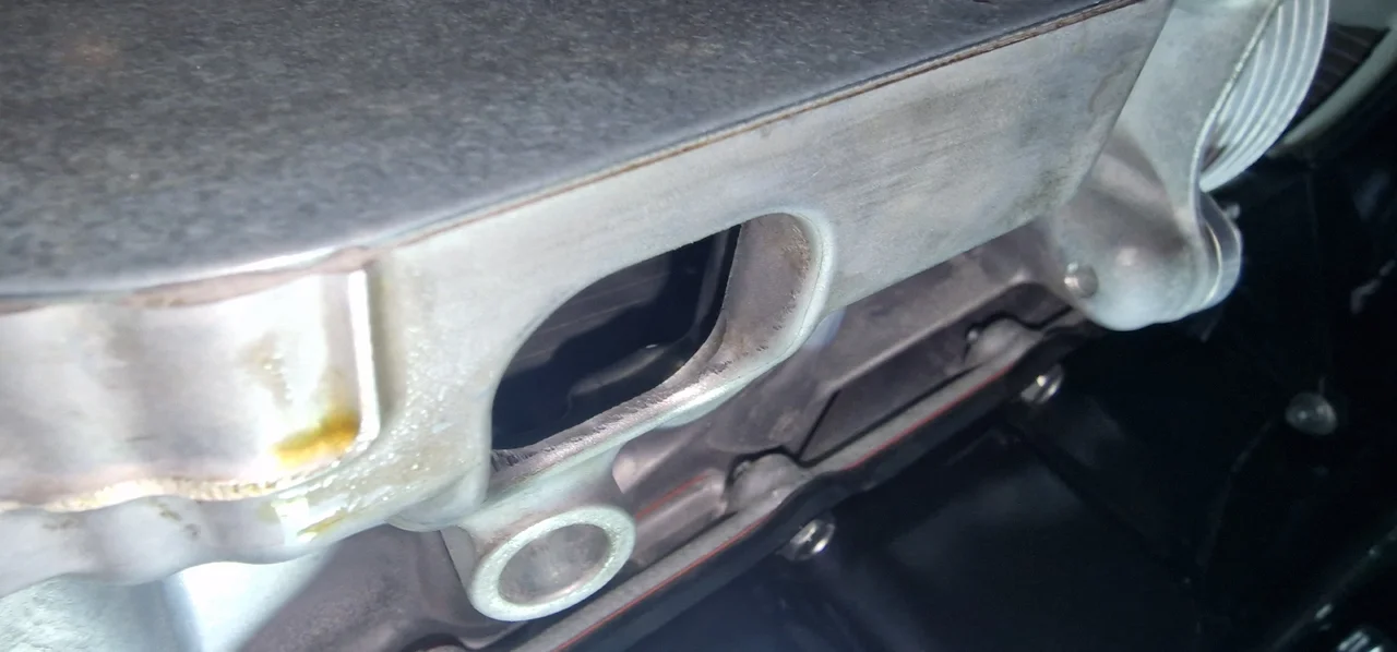

Hi, has anyone experienced this issue...A leak between the engine and auto transmission on a Mazda2 Skyactiv G 1.5L 2020? It only has 18,000 kms. Thanks!
Possibly a rear main seal. It can happen to any make, model, or brand.

It is barely over 5 years now, it is a very small leak, is it worth it to dismantle the transmission
Absolutely. It will only get worse. What was the actual purchase date? If it's within the 5 year powertrain warranty I'd get it to Mazda right away.
