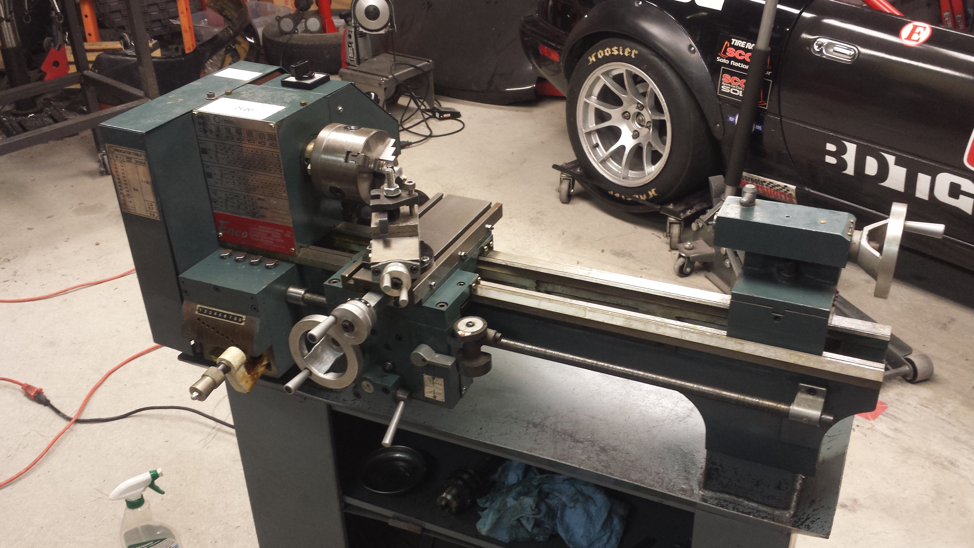

I've been shopping for a small lathe for the shop for some time now, but kinda had a deal fall in my lap for a used, neglected, Emco 8x20 lathe. A buddy had bought it at a "used tool" auction at his work many years ago, then had a kid (and inherited his grandfather's lathe that also needs work), so this one was just collecting dust.
Moderate sketch factor, but I stopped a couple times in the first few miles to cinch the straps down as it settled in place (and secure the rear door that had swung open), and it was fine the rest of the way back home.

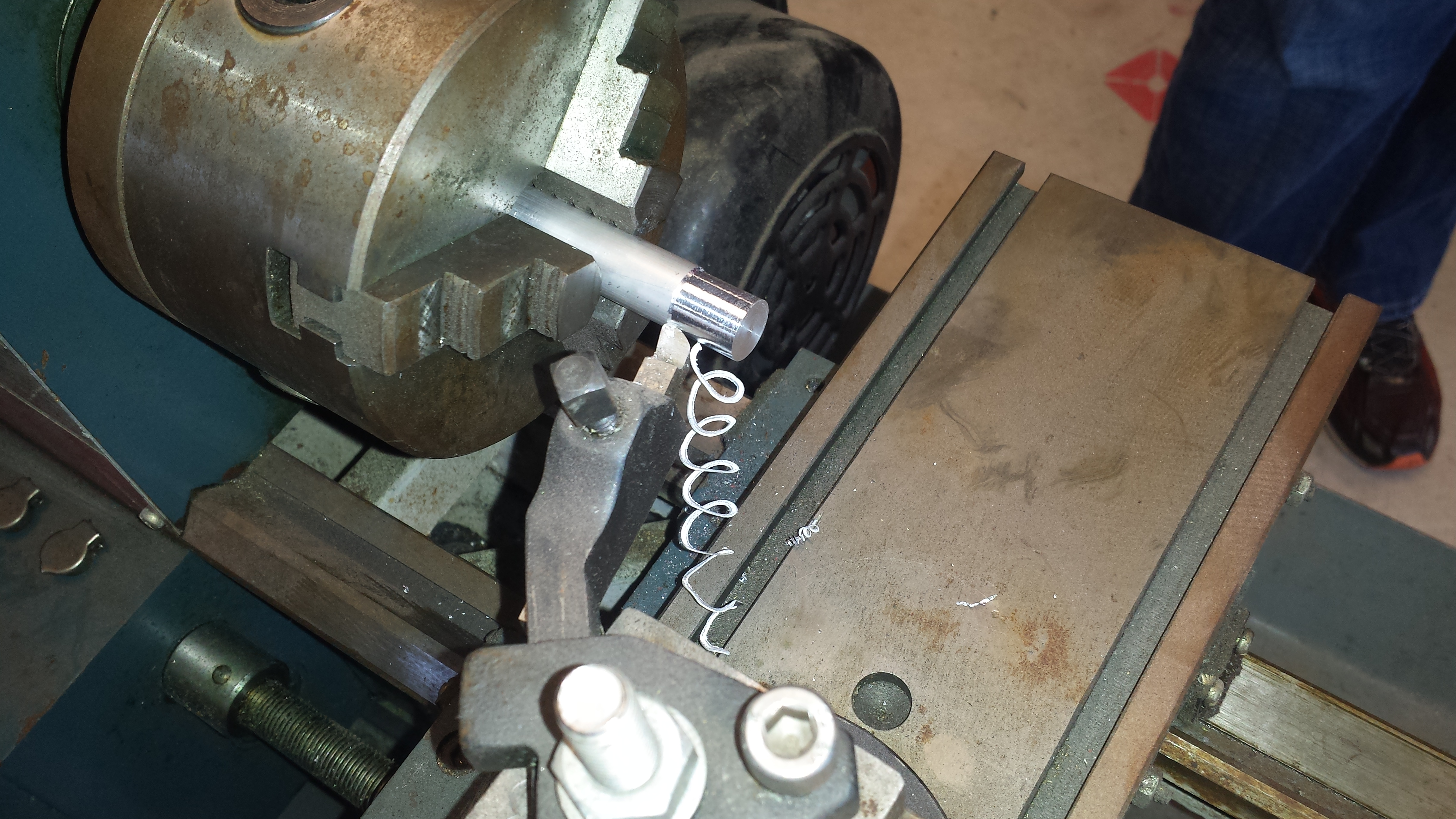

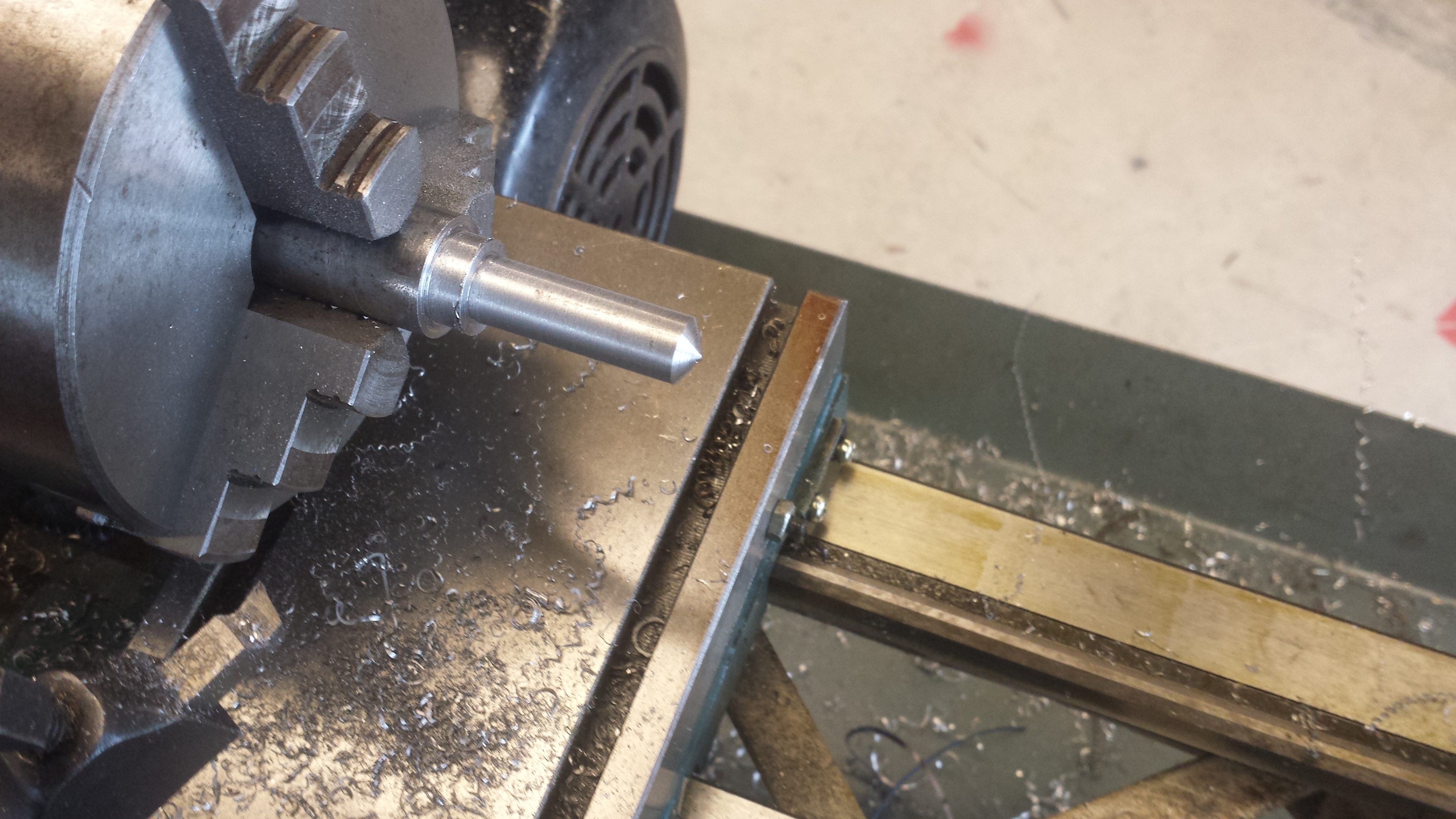

And just for fun, I turned Baby's First Chip just to say I had before the teardown started. Because boy did it need to be gone through.
With a little help from a couple friends, we got it down to my workshop. If you've ever seen where my shop is, you know how sketchy THAT was. Backed the trailer down the hill, used the winch to slowly slide it off, etc.

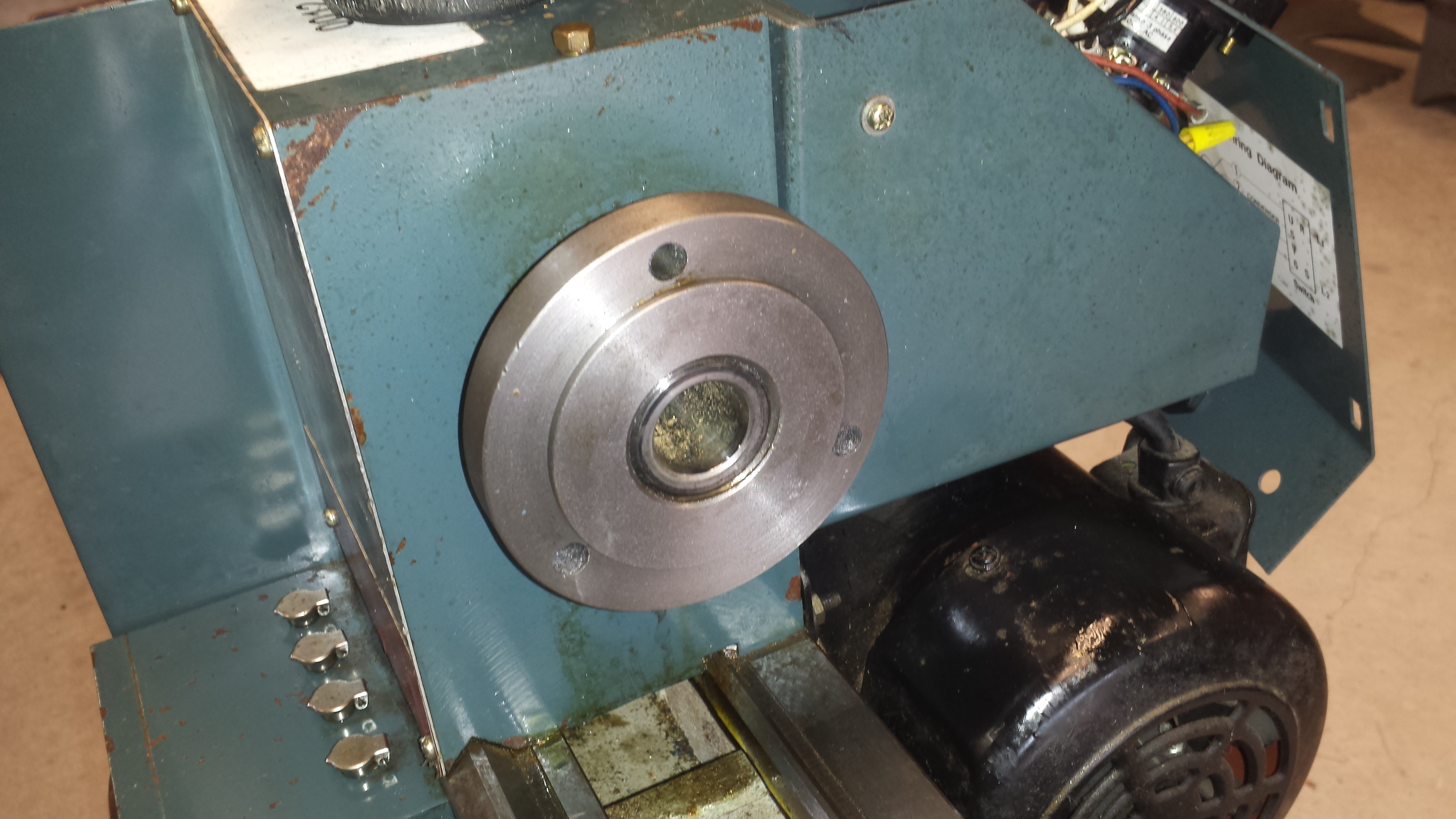

One of the first things I noticed (and was pretty worried by) was the runout on the chuck. Hopefully the entire headstock won't need to be rebuilt, because I found the most likely culprit. A bunch of swarf built up between the back of the chuck and the lathe's face plate. Hopefully tidying this up will improve that situation, or else I'm going to have to figure out what's crooked in the system. The nice thing is that the lathe can be used to true itself up if need be lol

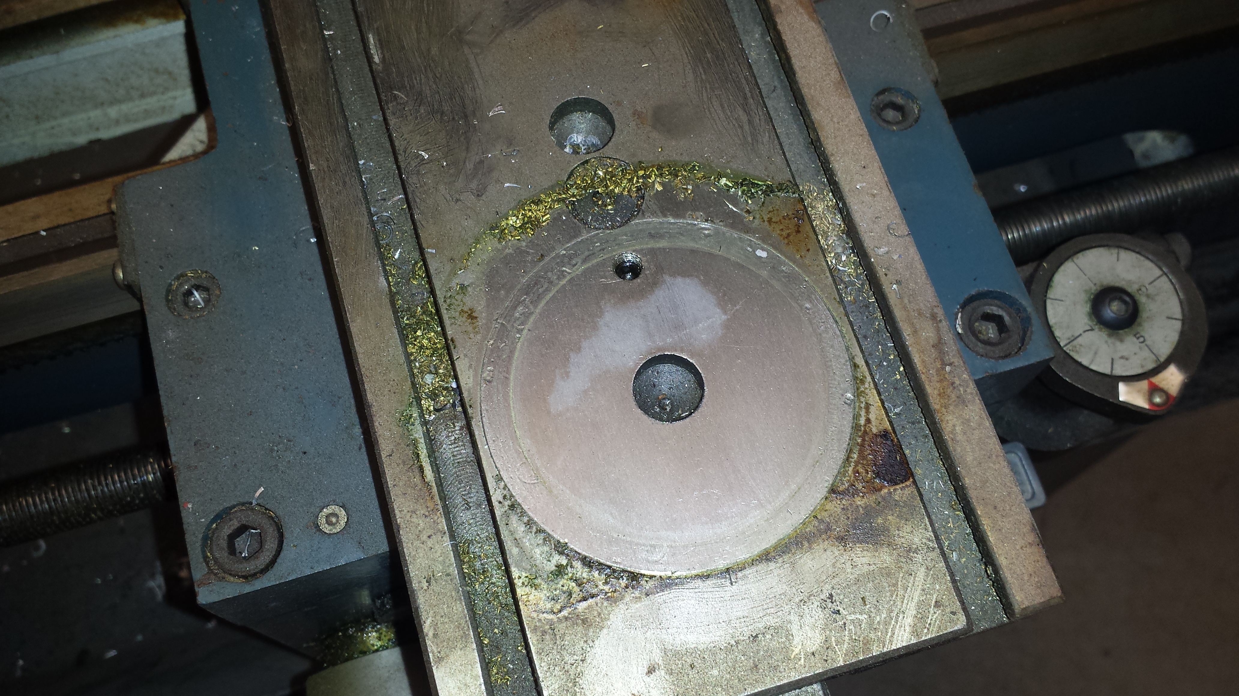

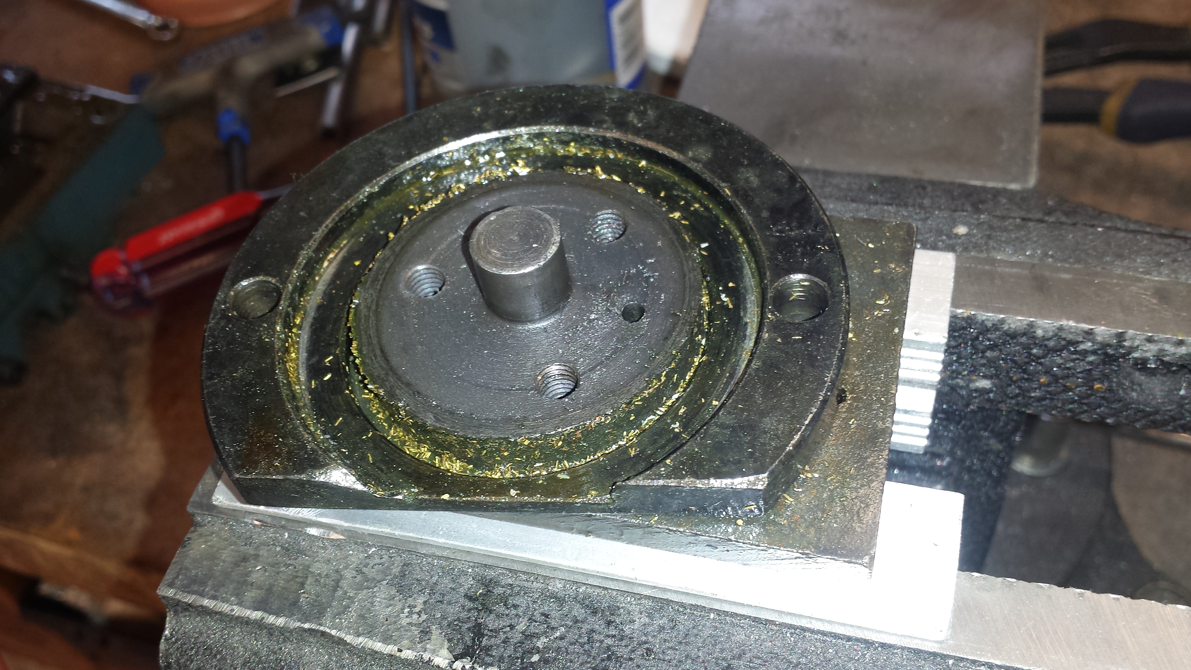

Once again, a ton of crud under the tool post. I actually couldn't find the witness mark for setting the tool post angle because it was caked in dirt and oil. It should turn much more freely now.
Got the cross slide wheel & screw out. Again, CAKED on grease everywhere I turn (unintentional lathe joke!). To be clear, this isn't grease as you think of it, just heavily applied. This is stuff that's been on there for 20 years, dried up and left a thick coating of dry crap that has to be scraped off by a fine pick in many instances.

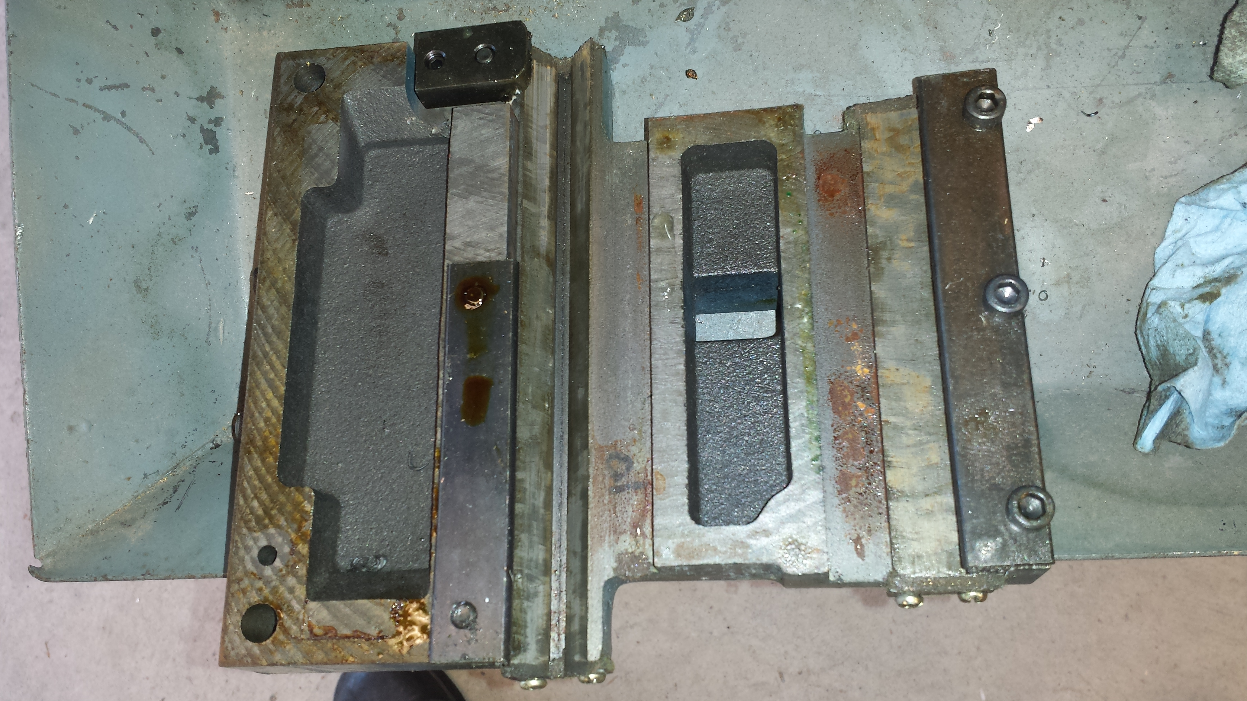

And finally, the compound comes off the ways. This is the bottom of the compound, where it would slide on the lathe bed. As you can see, some surface rust (not anywhere it actually touches the lathe ways, thankfully), and a lot of old oil & dust and grit that will need to be cleaned off.

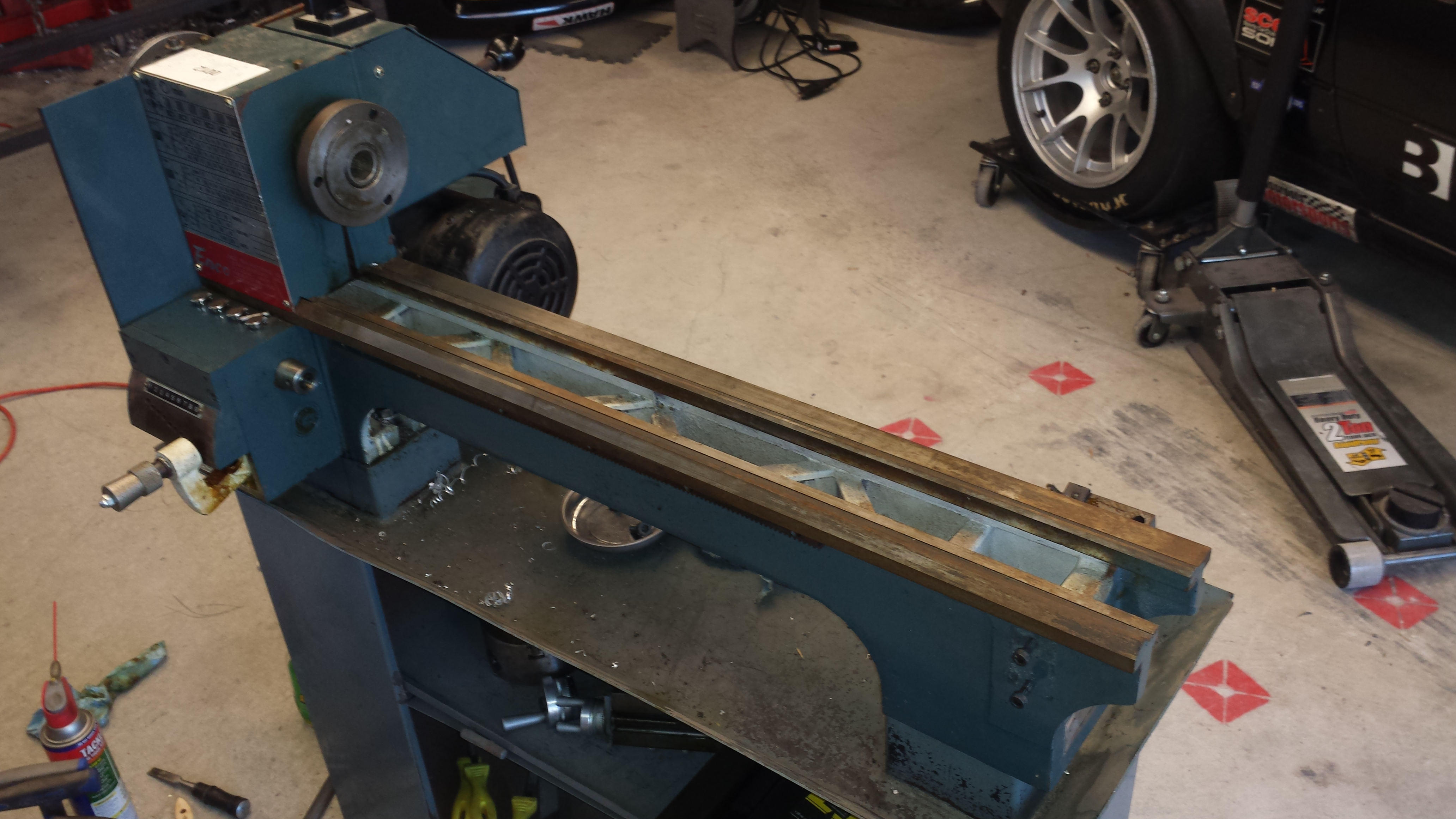

With the compound, apron and lead screw off, she's now pretty stark naked.

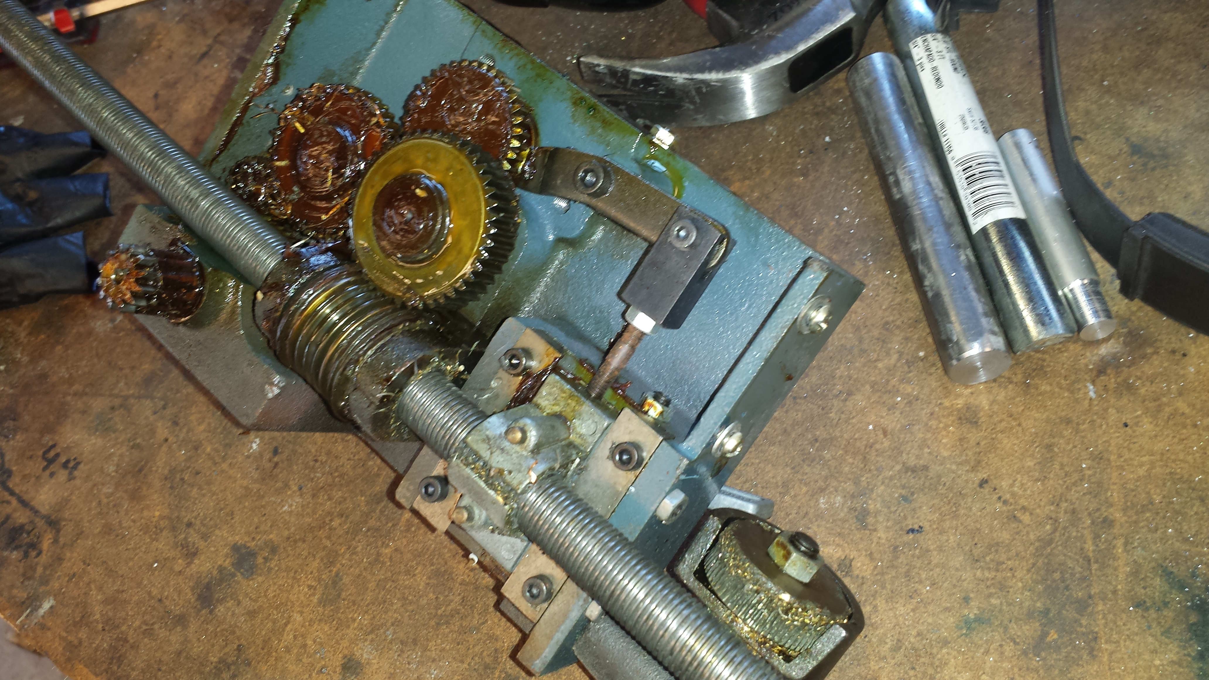

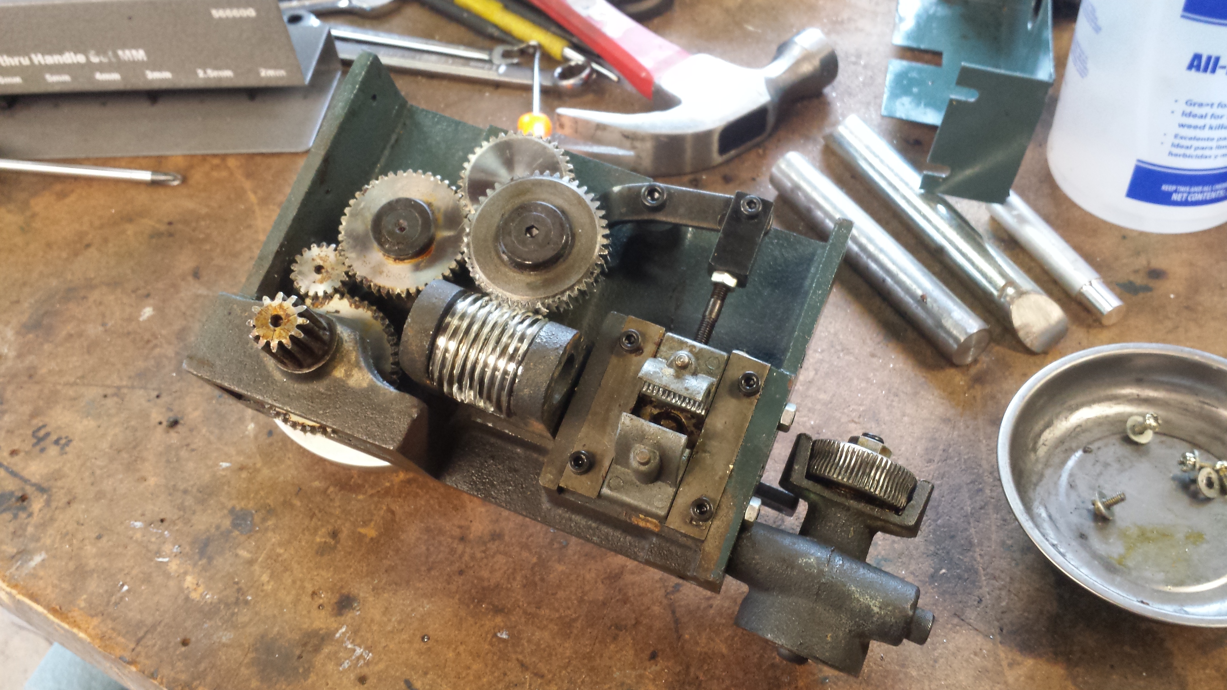

Up next was to work on the apron (ie: the gearset that uses the lead screw to run the power feed for the compound, and rides under the compound).
This is what greeted me when I took it off:
With the cover off, it's even worse. Take a moment to click the picture and zoom in on just how bad it is. The amount of crud caked in the threading half-nuts, the caked on grease (more...). After I'd run it for a while, the handle for the power feed was jammed on and couldn't be disengaged because of what ended up being a chunk of dried grease getting caught in its working. It was bad.

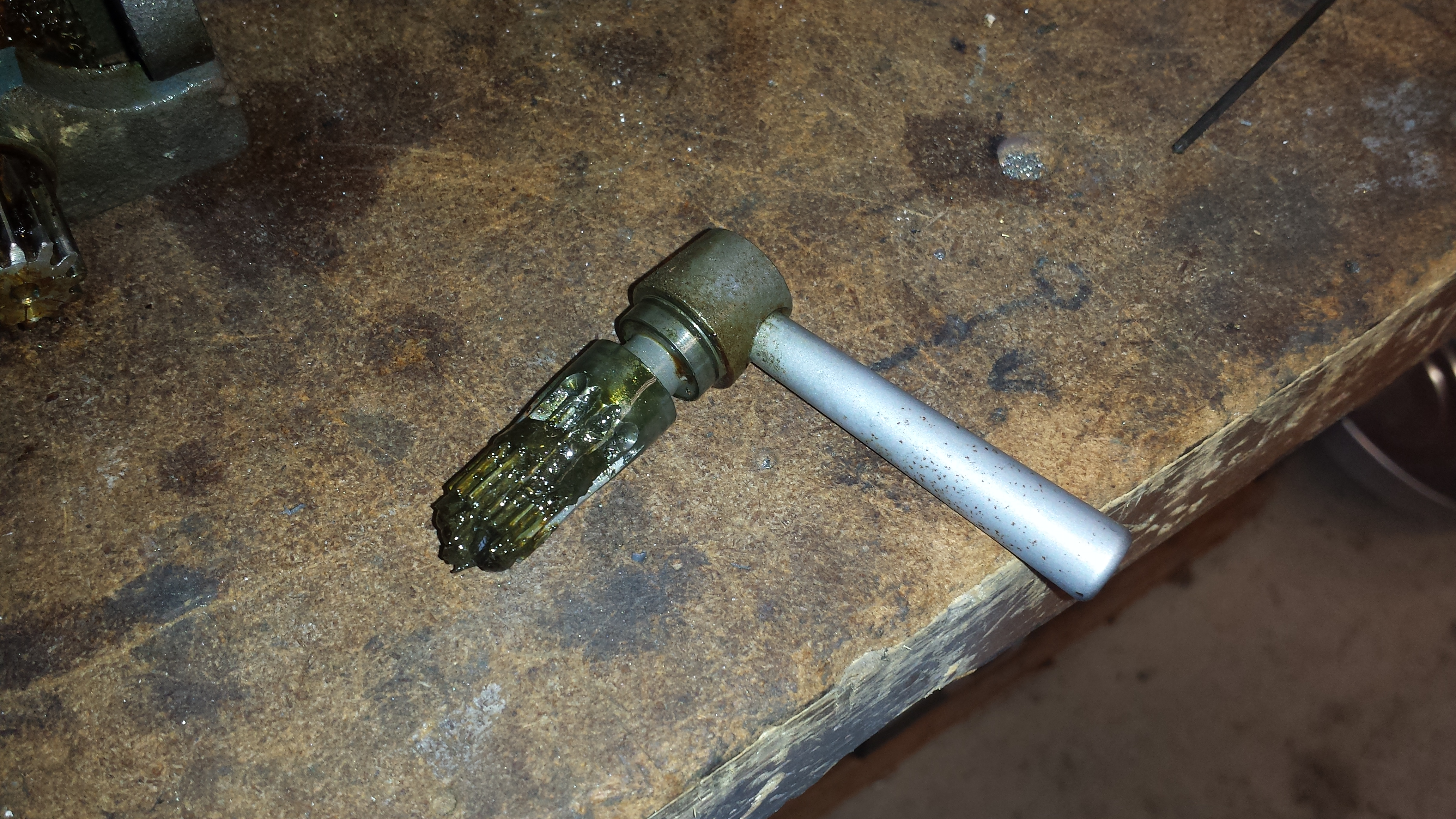

A bath in the parts washer made almost no difference in the grease on the gear train there. I ended up to have to disassemble the power feed engagement lever and gear assembly and then go through the entire gear train and the lead screw, tooth by tooth, thread by thread, with a pick to actually get the hardened gunk out of the system.
It was a ton of work, but MAN everything turns smoothly now. It's such a huge difference. I put the barest whiff of white lithium grease on it per the factory service recommendations, and then it's maintained afterwards with 140W gear oil.

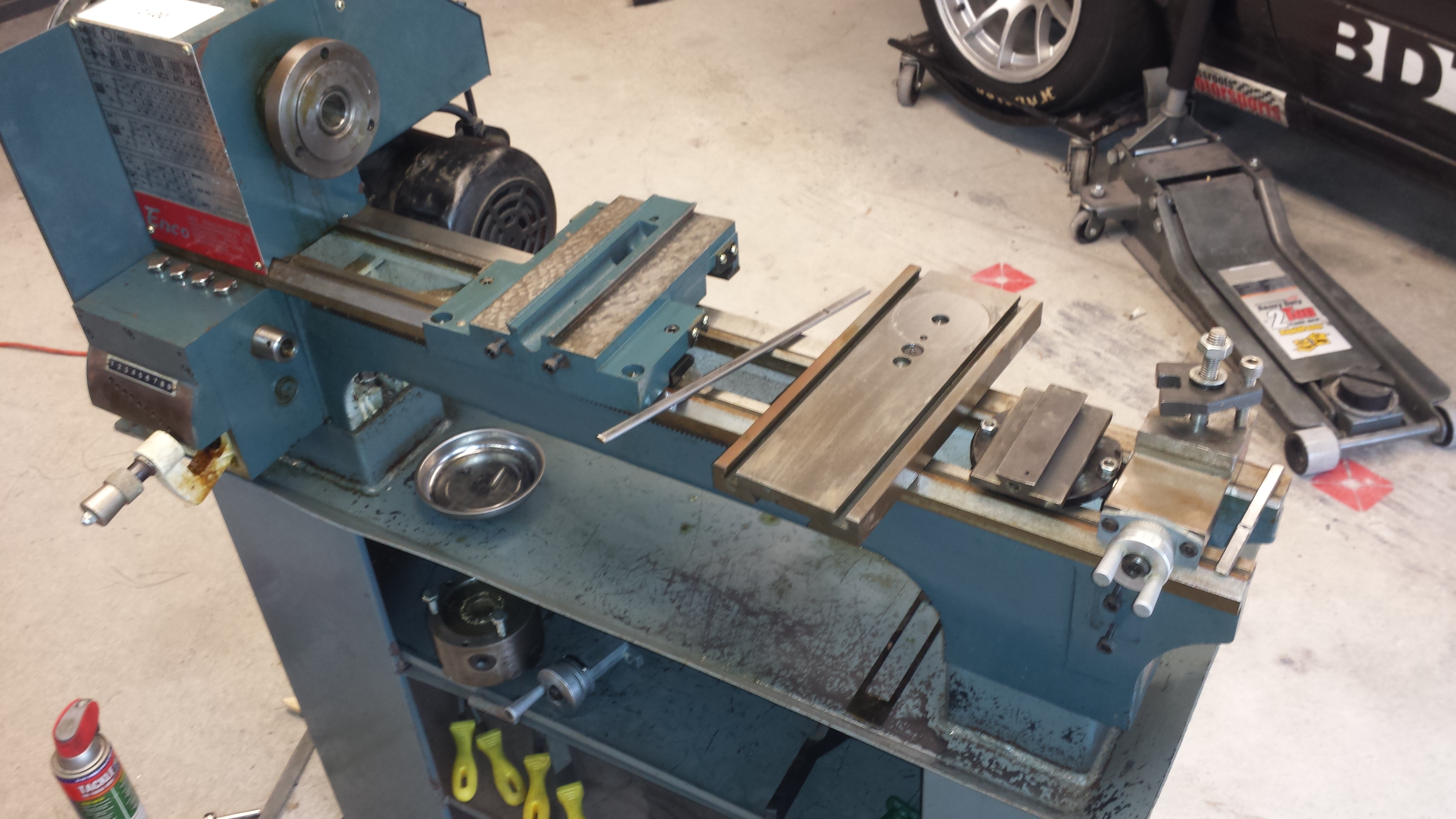

Got the first pass with mineral spirits and soft brushes done to knock the big dirt and clumps of crud & crust off. Next I'll be cleaning all of the mating surfaces with 0000 steel wool soaked in WD40 to get the ways and gibs properly cleaned up, then apply oil where necessary and reassemble.
The compound angle was really tough to set earlier. This is what I found between the angle dial that's pressed onto that arbor, and the tool post.

Before and After (in the same shot) on the ways. 0000 Steel Wool and WD40 (and some elbow grease) did the business on that crud :D

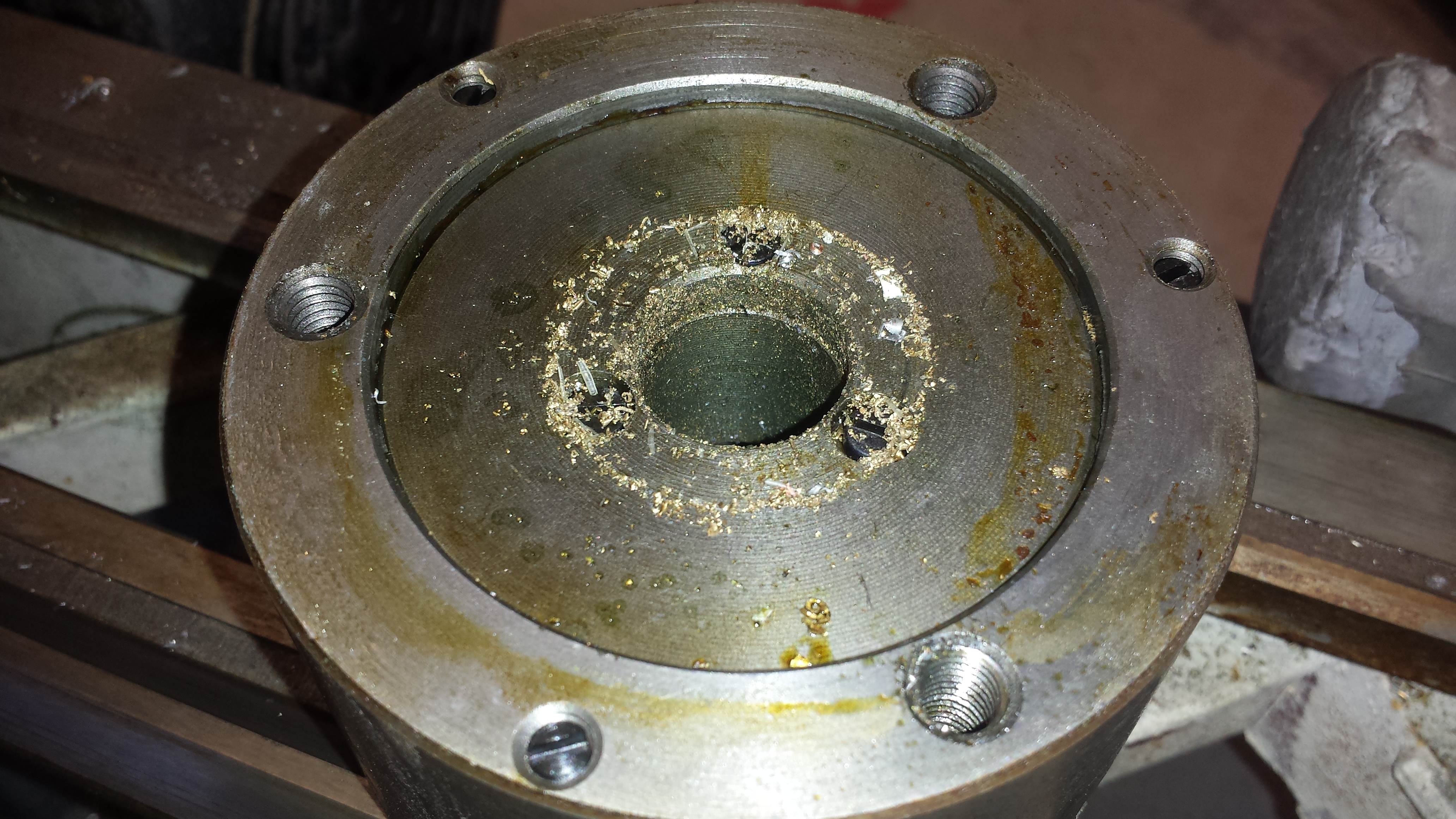

The spindle face got similar treatment:

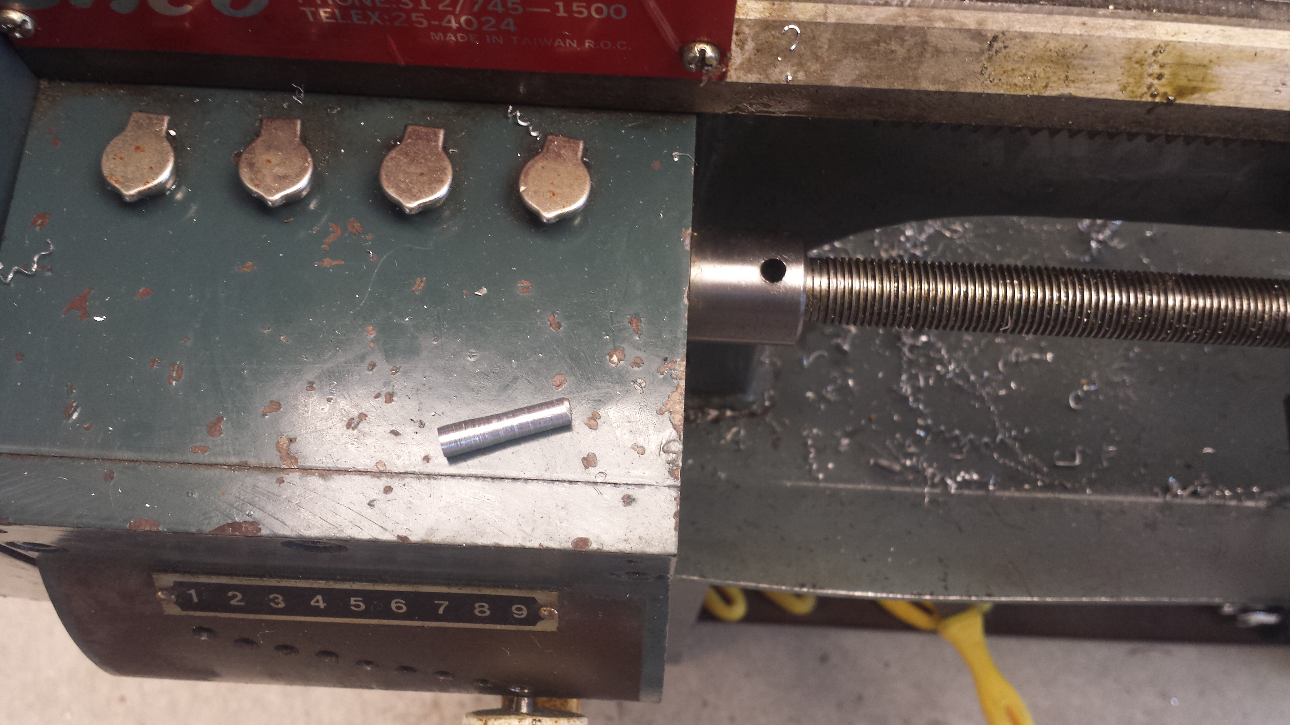

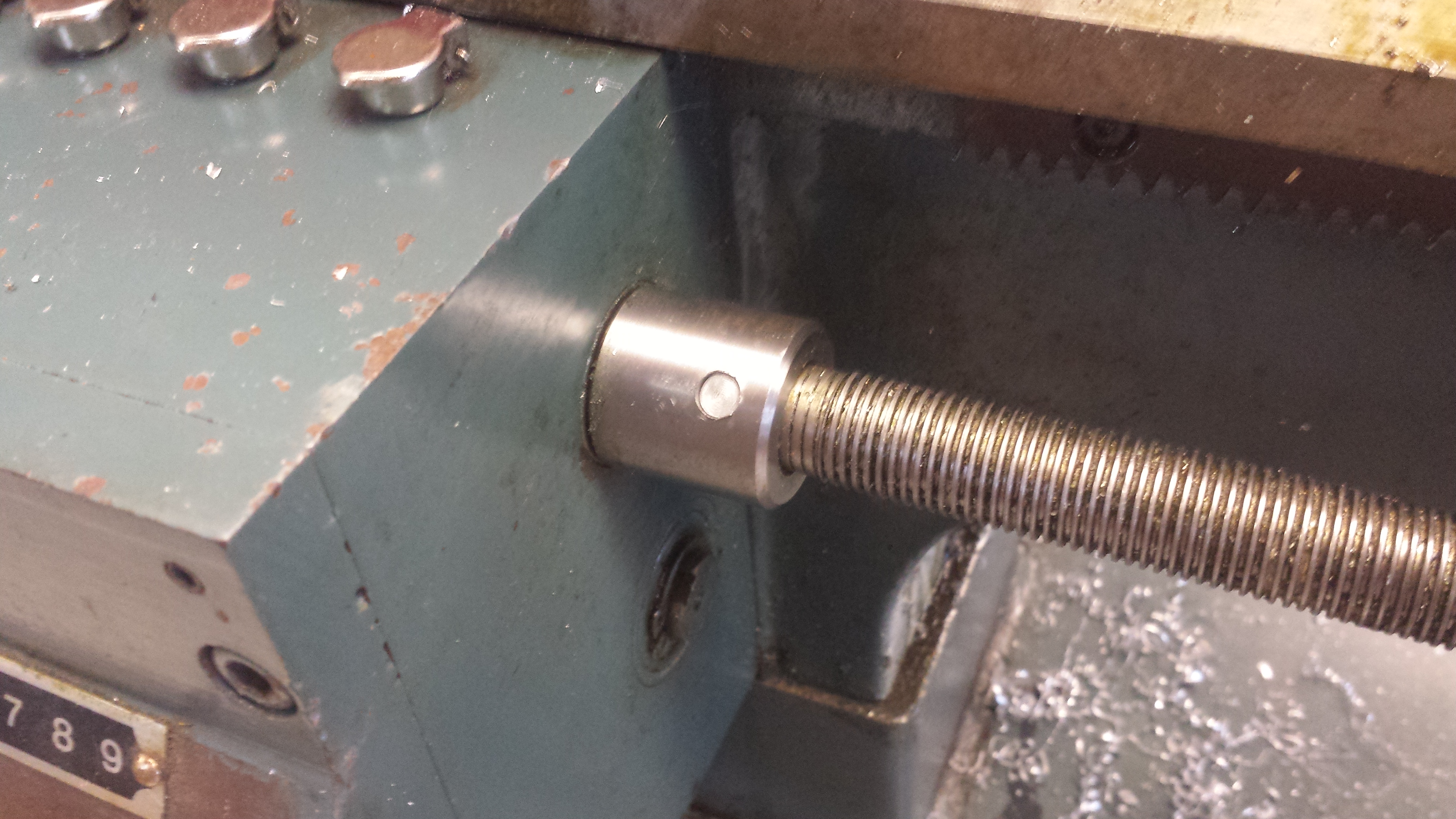

The tapered shear-pin that connects the lead-screw to the quick-change gearbox was in pretty bad shape. I had to pound it out when I disassembled the lathe, and I'm pretty sure it was a replacement and not really sized correctly.
So I made one :D

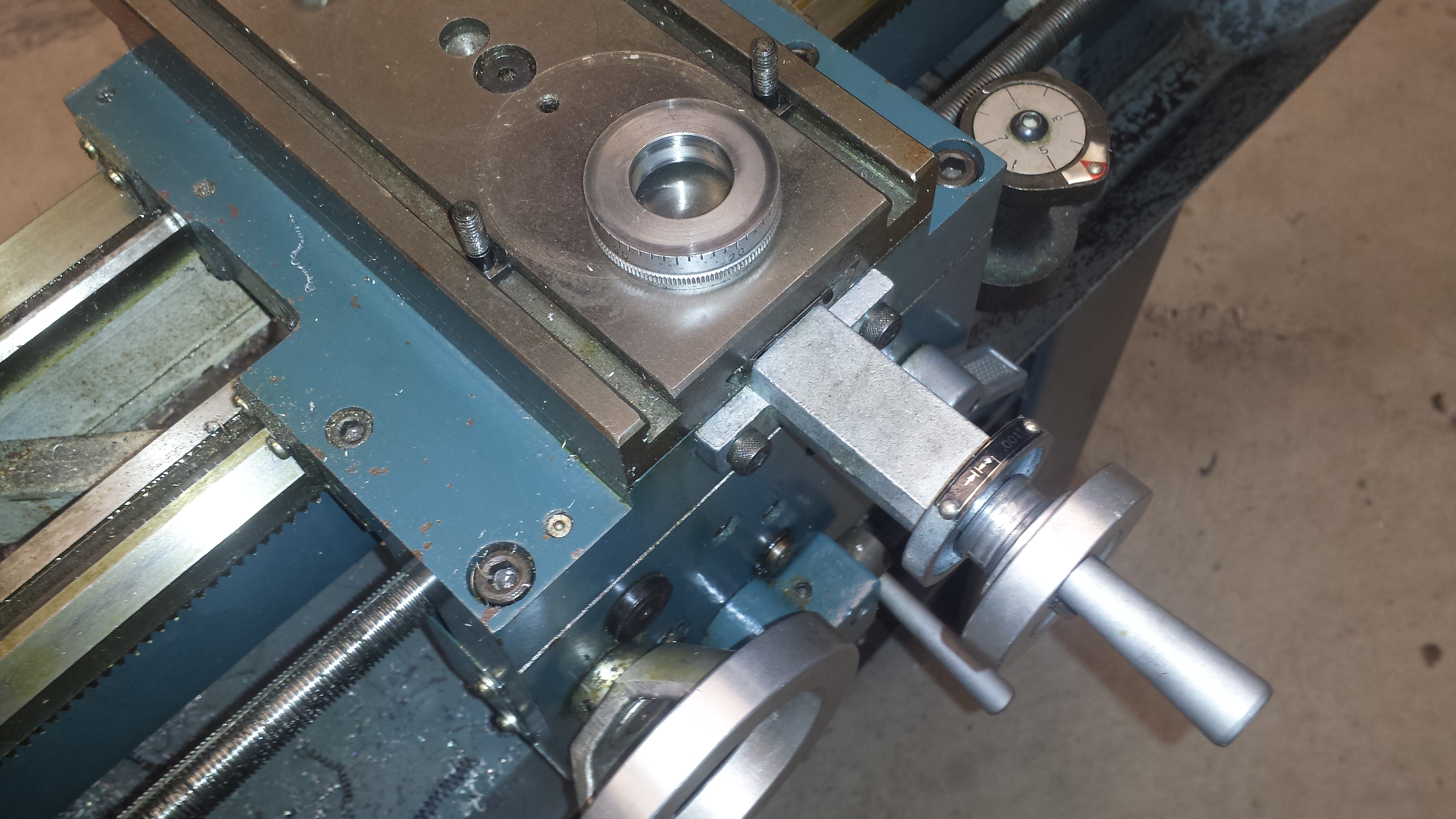

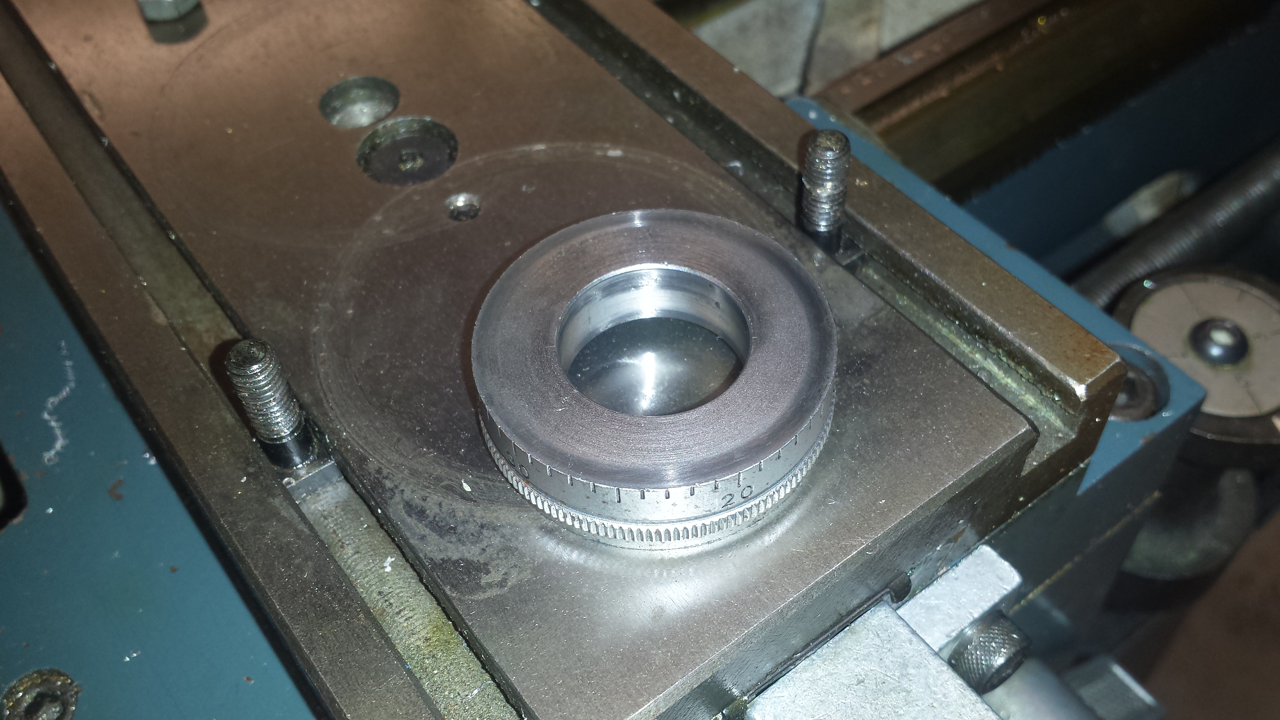

The cross-slide feed was really sticky. I thought maybe the feed screw was bent (because it's super weedy). I took it all apart and everything measured relatively straight, so I dove a little deeper and found that the graduated ring was binding up against the screw's housing at the same spot on every rotation. If I took the ring off, the handle turned perfectly smooth.
I could make it loose enough to work but then it wouldn't hold its position, or I could make it tight enough to hold its position and it would be impossible to turn through that rough spot. You can sort of see where it's interfering here, on that dark ring:
Broke out the emery cloth and a fresh can of elbow grease and spent a few minutes knocking it back just enough that it turns nice and freely now.

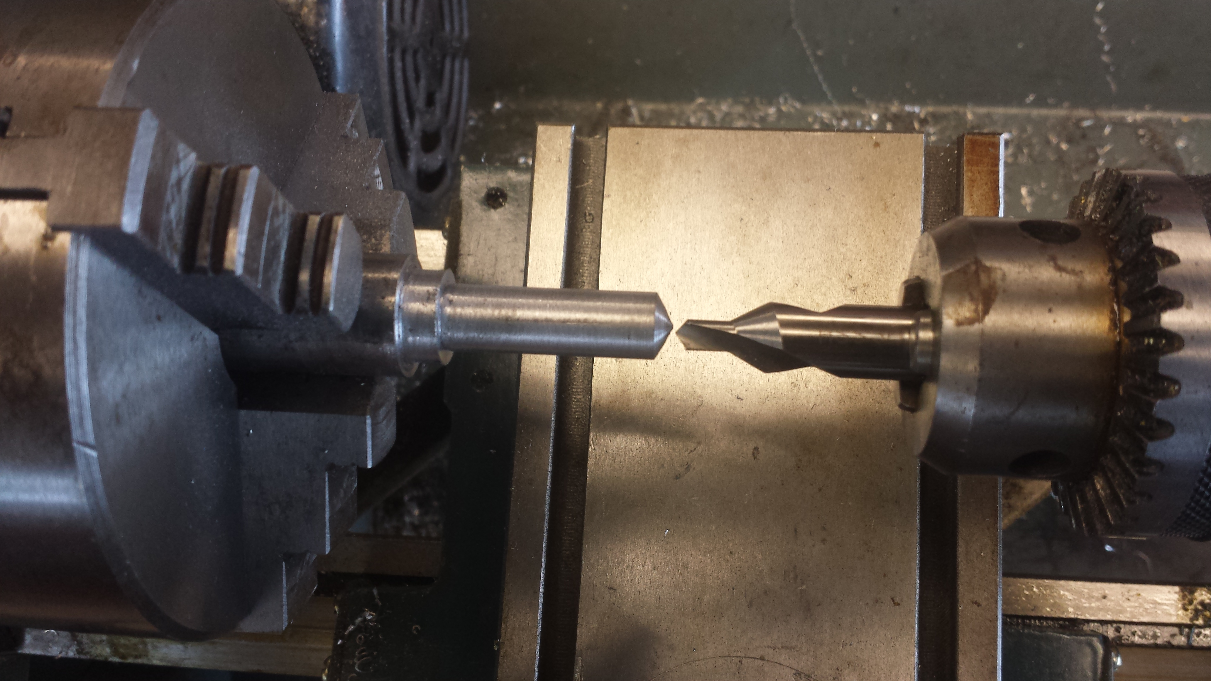

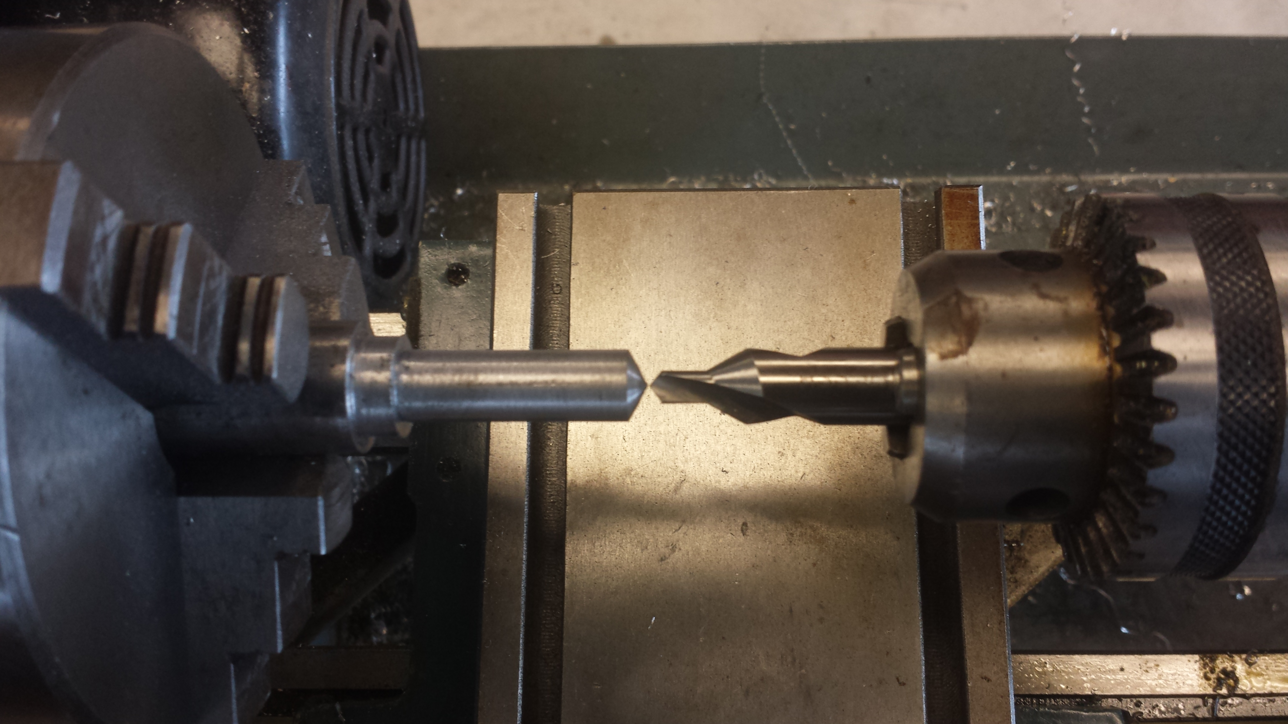

Next, I wanted to line up the tail-stock so it's properly centered with the bore of the chuck. Usually you'd use a couple of tapered centers for that, but, well, I ain't got those yet. So I turned a center from a piece of steel...
And then used a centering bit in the tail-stock (which also comes to a point) and got it trammed in. It's probably not *perfect*, but it's well within good-enough range.

1. I finally diagnosed the issue with the cross-slide knob, and it's that the shaft fits into its support collar like a prick in a sock because the collar's all wallered out. I'm thinking I may try and either buy or make a bushing for it to support it, drill it out and call it good.

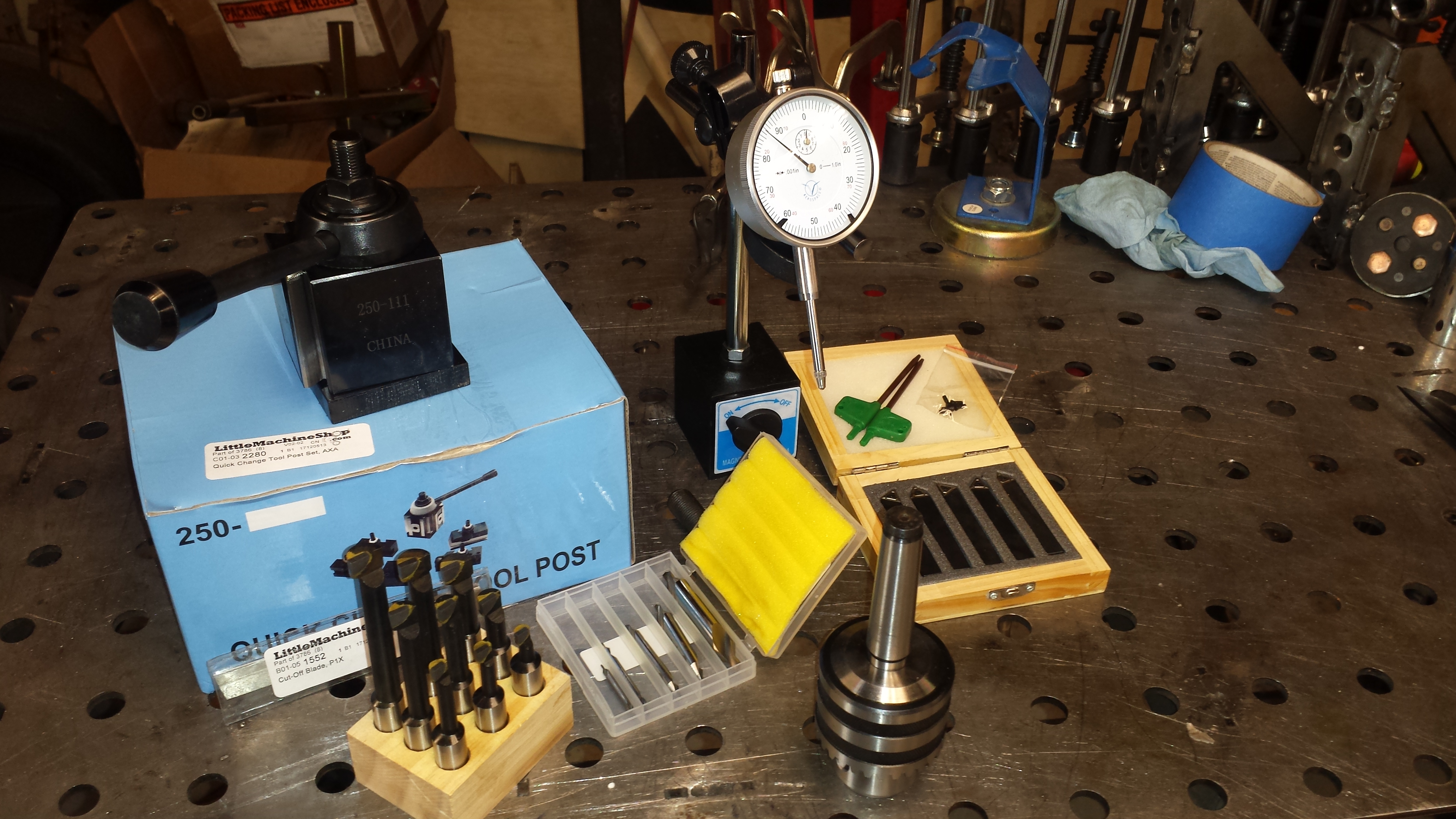

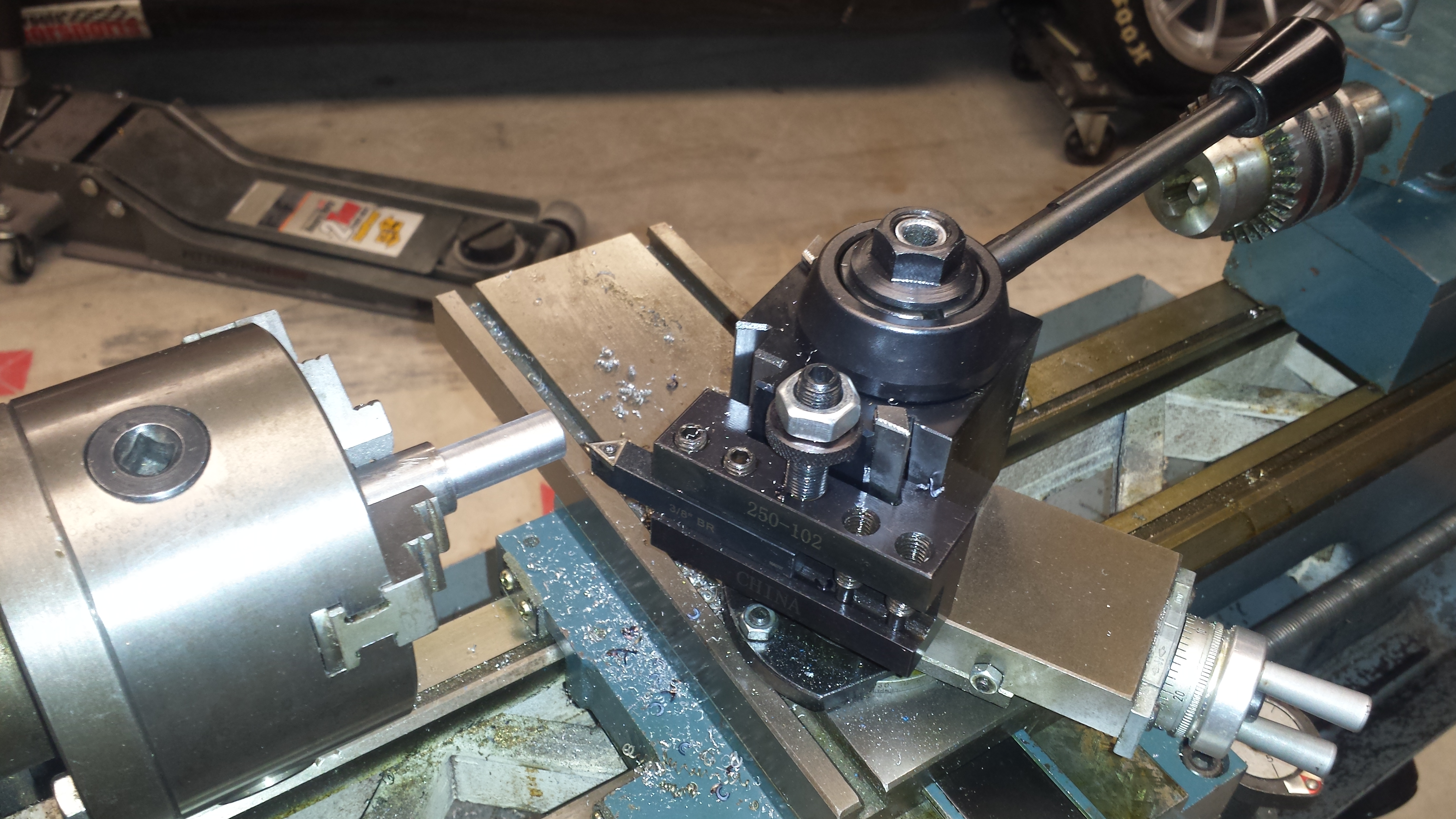

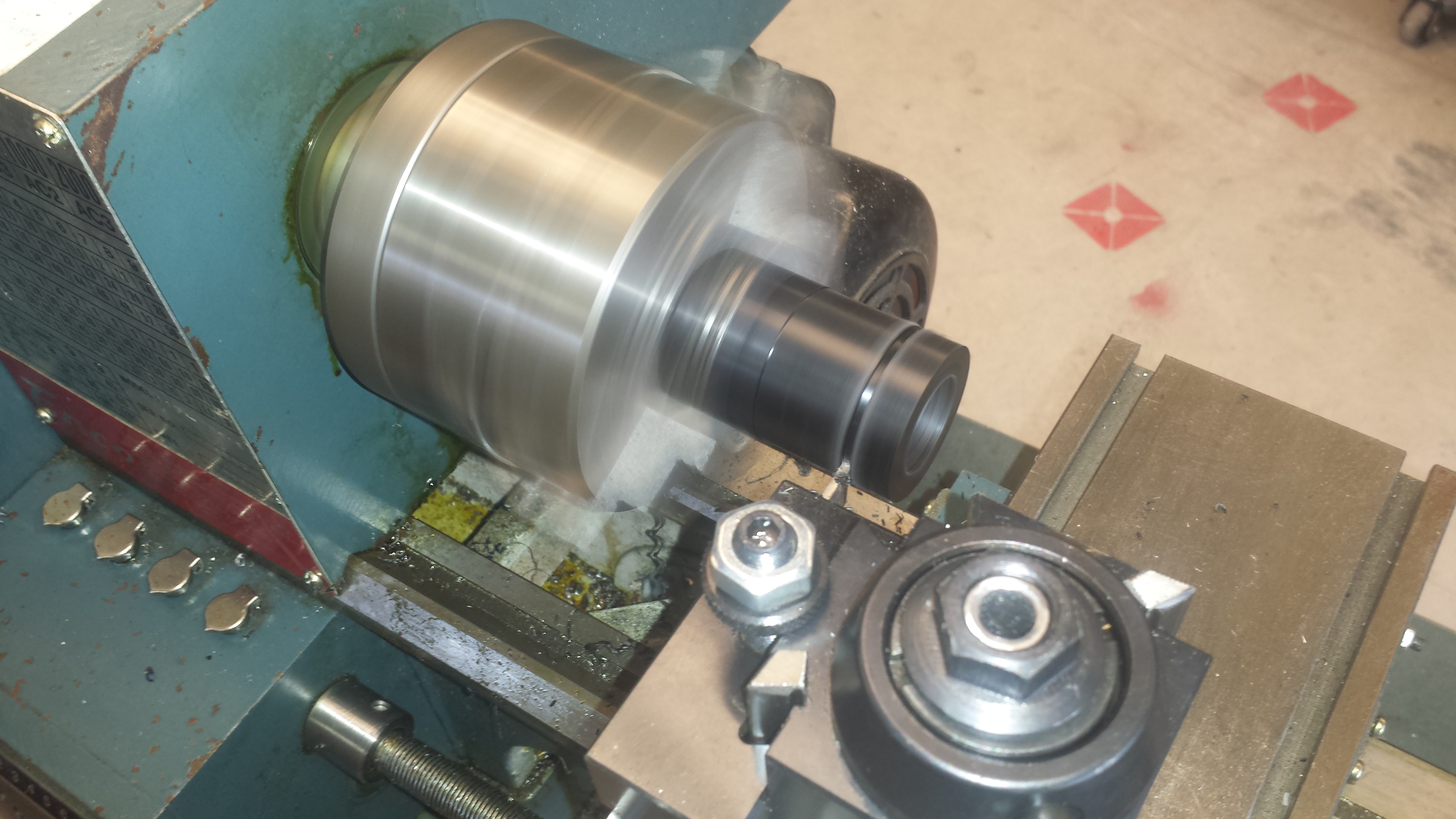

UPS finally delivered: The quick change tool post with tool holders, boring bars, carbide insert tooling (up until now I had 1 single high-speed steel tool that the lathe came with), centering bits, and a dial indicator (and a few other odds and ends). This'll be a HUGE step to making this machine productive. The only problem is that my tool-post wasn't designed to take this kit, so I've had to make an adapter that threads over it to make it work. I'm not done with that yet, but I'm SUPER stoked to have some proper tooling for it.
Took some time to get the quick change tool post set up. This is going to make life SO much easier. As with most bolt on stuff, this kit was made for similar lathes, but not this exact lathe, so it wasn't exactly a bolt on affair.
It came with an M8 internal thread - 9/16 external adapter, because the newer versions of this lathe all came with M8 tool posts from the factory. Well, mine came with an M10 tool post.
Fortunately, I have this handy-dandy lathe! So I chucked it up and drilled out the M8 internals to 11/32 (which is the standard drill size equivalent of an M10 tap-drill size), and then drilled a much shallower bore to compensate for the M10 post's longer unthreaded shank. After that, I tapped it as deep as I could go with my M10x1.5 tap. Unfortunately, that tap wasn't long enough to thread the full shank, but it was long enough for PLENTY of thread engagement, so I simply cut the top 8mm off of the stock tool post (yeah, taking a hacksaw to my tools? Not my favorite.), smoothed out the top of the post with a flap disk, and then ran the die back up the threads to clean them up.
All that done, and she fits like a glove!
And since I just cannot and will not leave well enough alone, I had to set up a few of the tools, get them aligned and make a few chips. The insert tooling is going to working with this machine A LOT easier.
I still need to make some risers & then level the thing, so I haven't really checked to make sure it's actually turning cylinders and not a taper, but I did spend some time playing with some mild steel round bar tonight. I'm genuinely pleased with the finish it's putting on the piece (never mind the chowdered bits nearest to the chuck :lol:

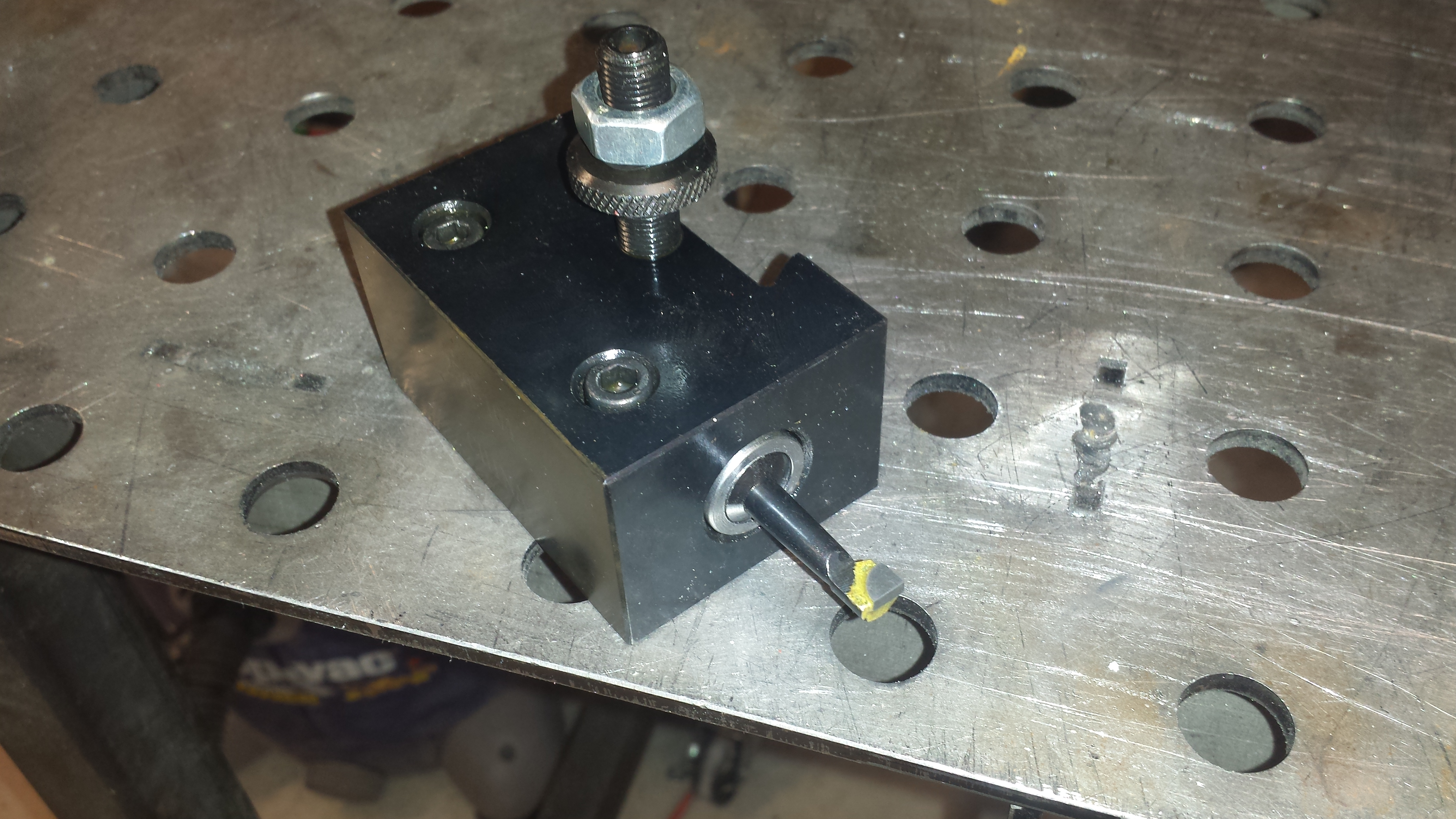

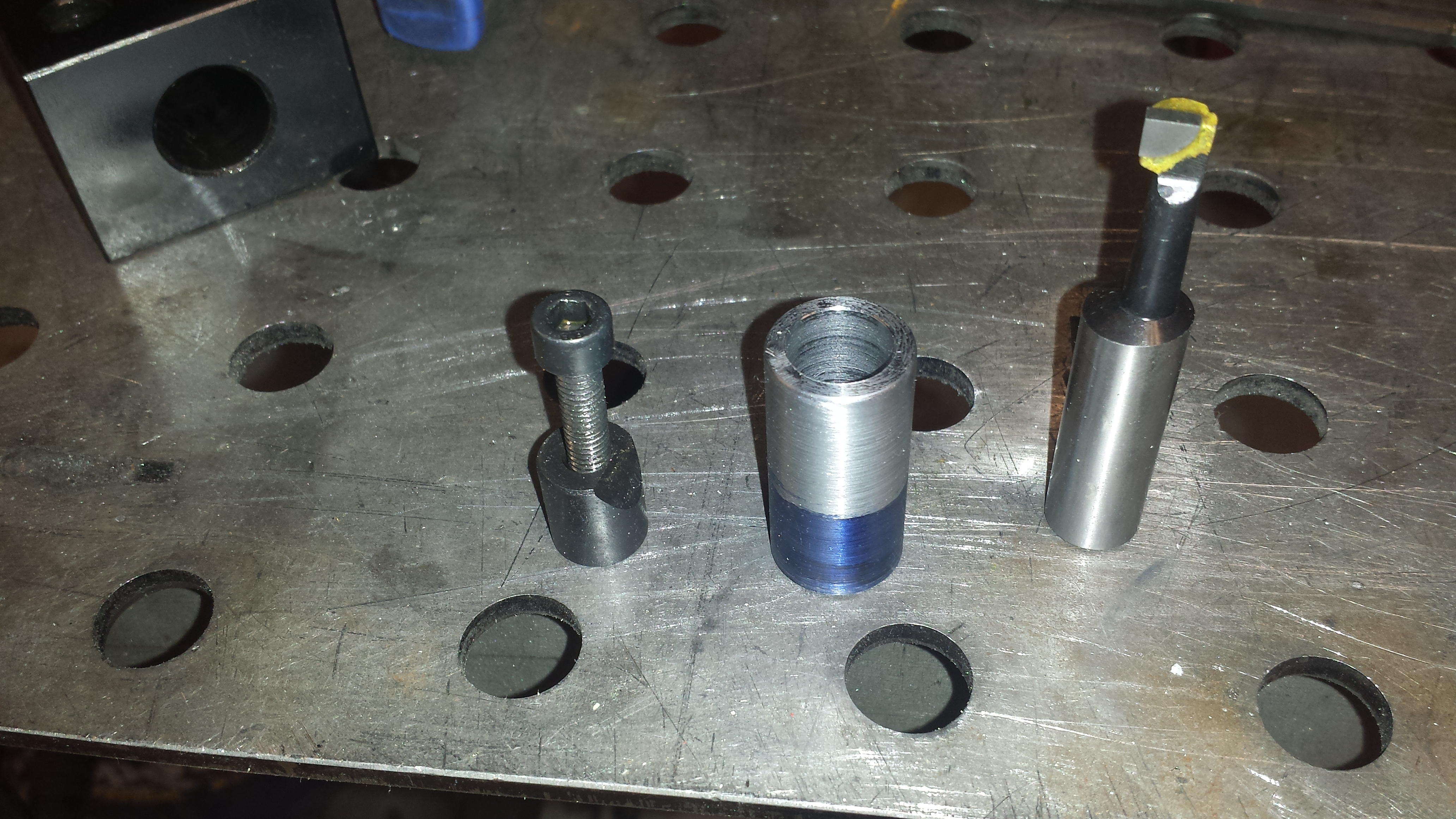

The problem: The quick-change tool post set I got came with a boring bar holder for a 5/8" (with a sleeve) or 3/4" boring bar. The tool set that came with it came with.... 1/2" round-shank boring bars. The last part is important because I can't just throw them into one of the normal tool holders as it would be held in by 2 set screws against a round surface. That sketch-factor is outside of my comfort zone.
I've got a bespoke holder on its way, but that will then tie up one of the normal tool holders. That's fine, I guess, but I'd like to use the boring bar holder I've got.
I says to myself "self... you know a guy with a lathe. He's near and dear to you. I bet he'd make you a sleeve to fit the 1/2 boring bars into a 3/4" bore!"

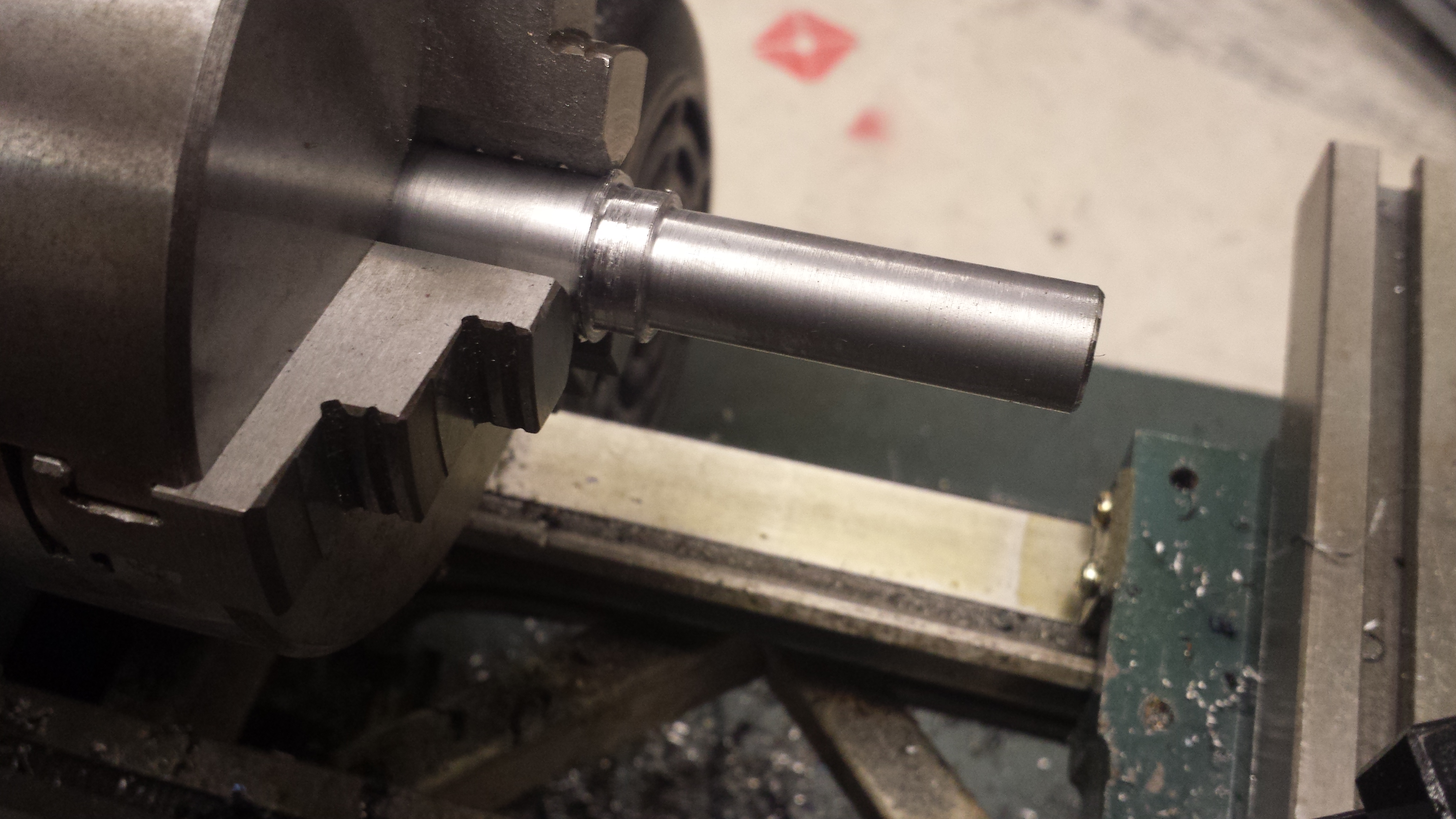

So I turned down a piece of 3/4" stock to just under 3/4" OD, then drilled it out to 1/2" ID, and broke all the edges and parted it off:
It's a decent fit, plenty good to do the job:

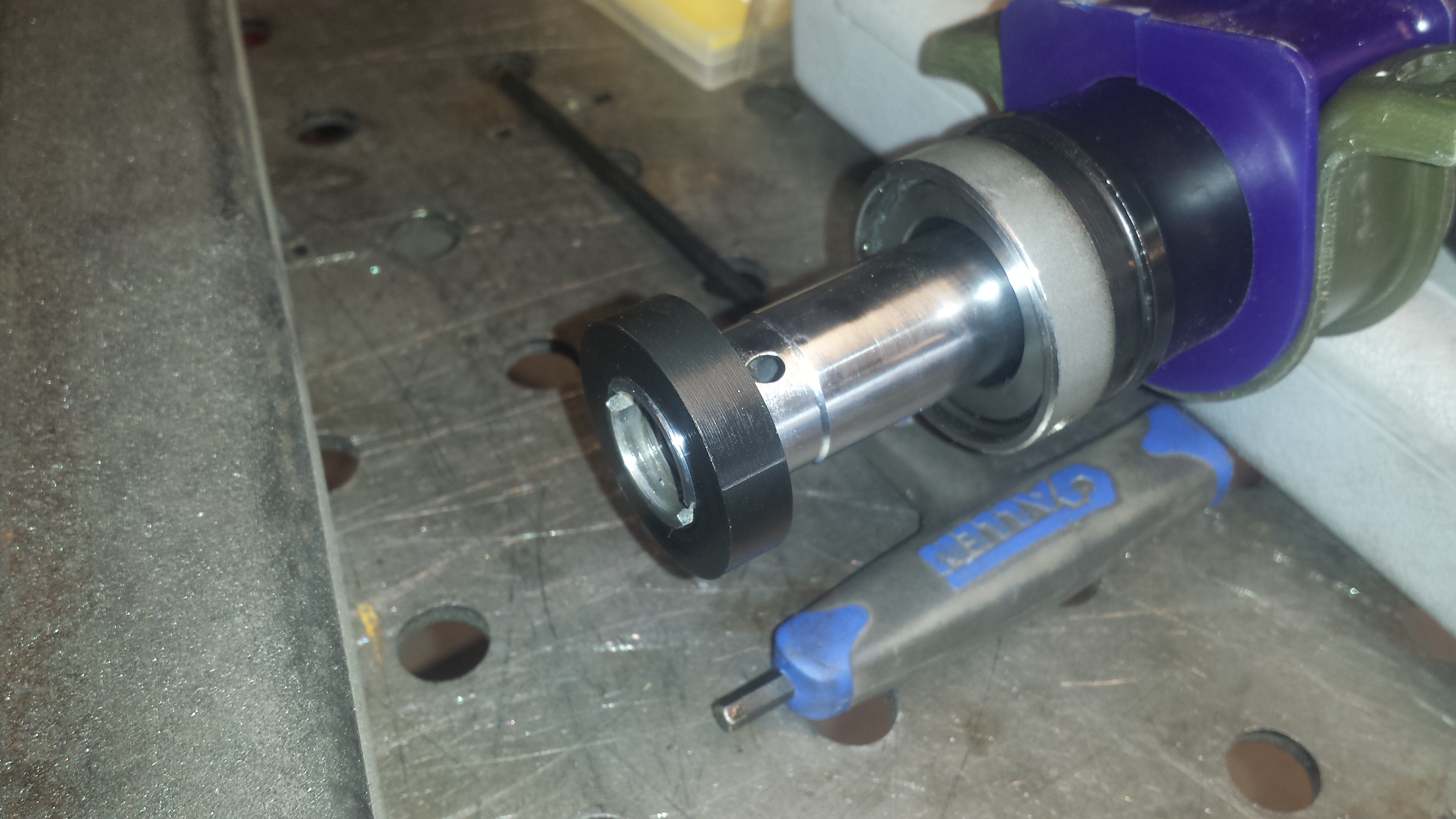

The way these tighten down is that the sleeve would have a slit cut along its length, and a hex screw pulls this thingamabobber (technical term) up and clamps everything together. The concern is that the sleeve has a 1/8" wall thickness, no matter how tight I make it, it probably won't deflect the sleeve enough to adequately hold the boring bar, which brings me back to my original problem of sub-optimal sketch factor.
After consulting with some much more experienced fabricators, the recommendation came to essentially make a collet out of it (something like this). So I got to work and cut 8 opposing slits on the bandsaw. The slits aren't perfect (...they were cut by hand on the bandsaw), but it gets plenty of bite on the shank of the tool now.

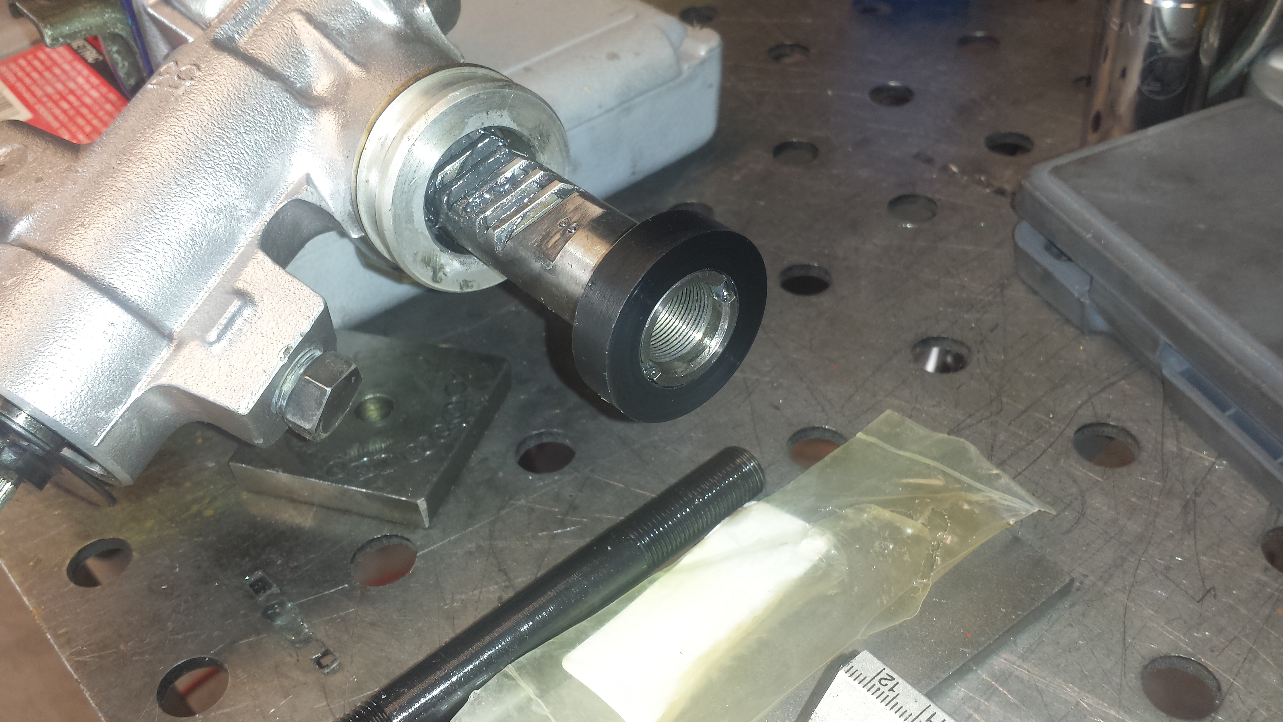

Finally made a couple of parts for the race car today :D
A pair of steering-rack stops to keep the 10" wheels and tires from ramming into rubbed the front sway bar at full lock. It's *usually* just a concern in paddock and grid, but: with the power steering and the faster rack, I really want to make sure we're not smashing hard parts together.
A nice, snug fit on the rack:

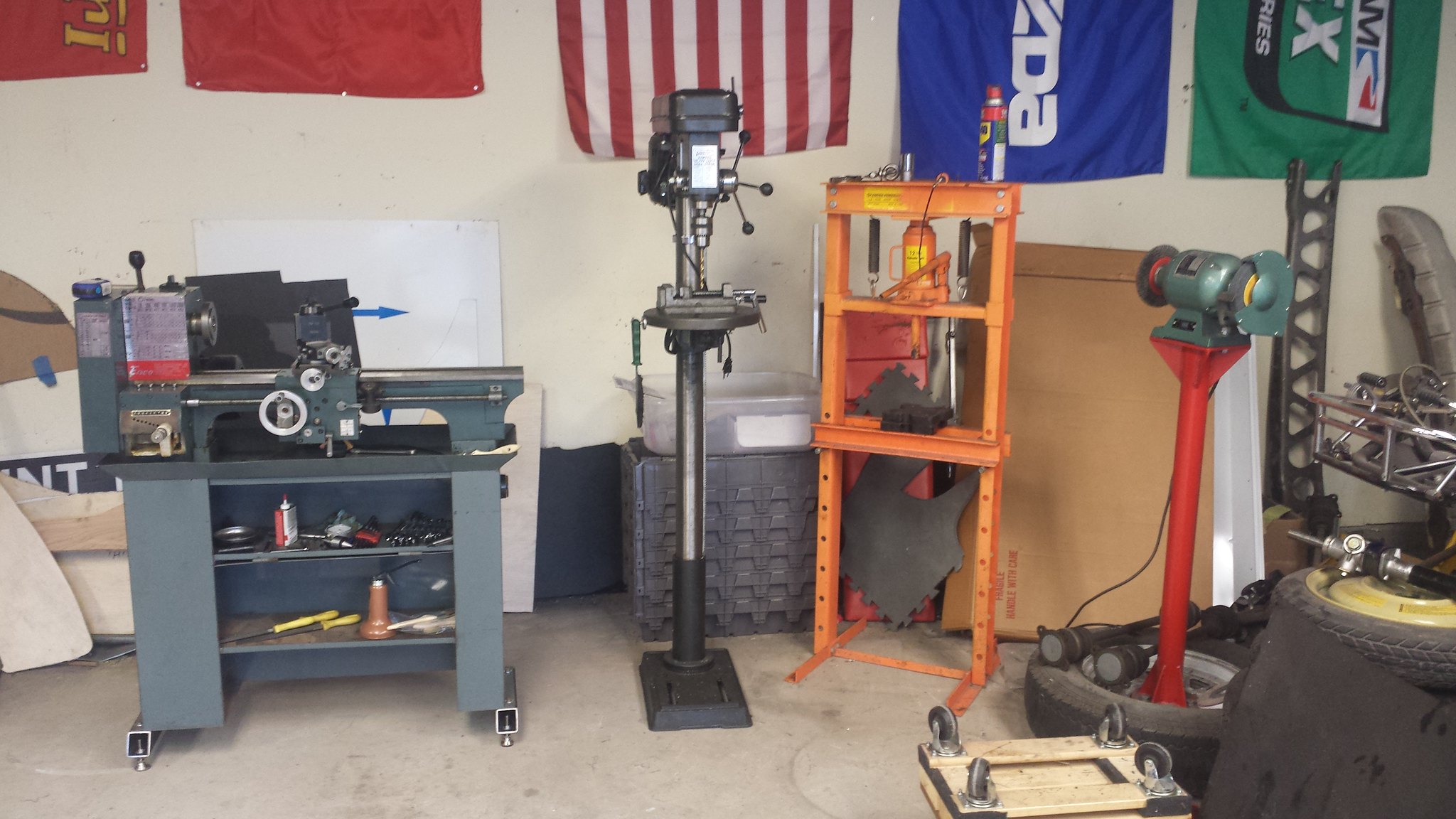

I took advantage of having my brother in town this week for Christmas to do a bit more work on this. We cleaned up the shop a bit and re-organized the messy tools area to make room for the newcomer.

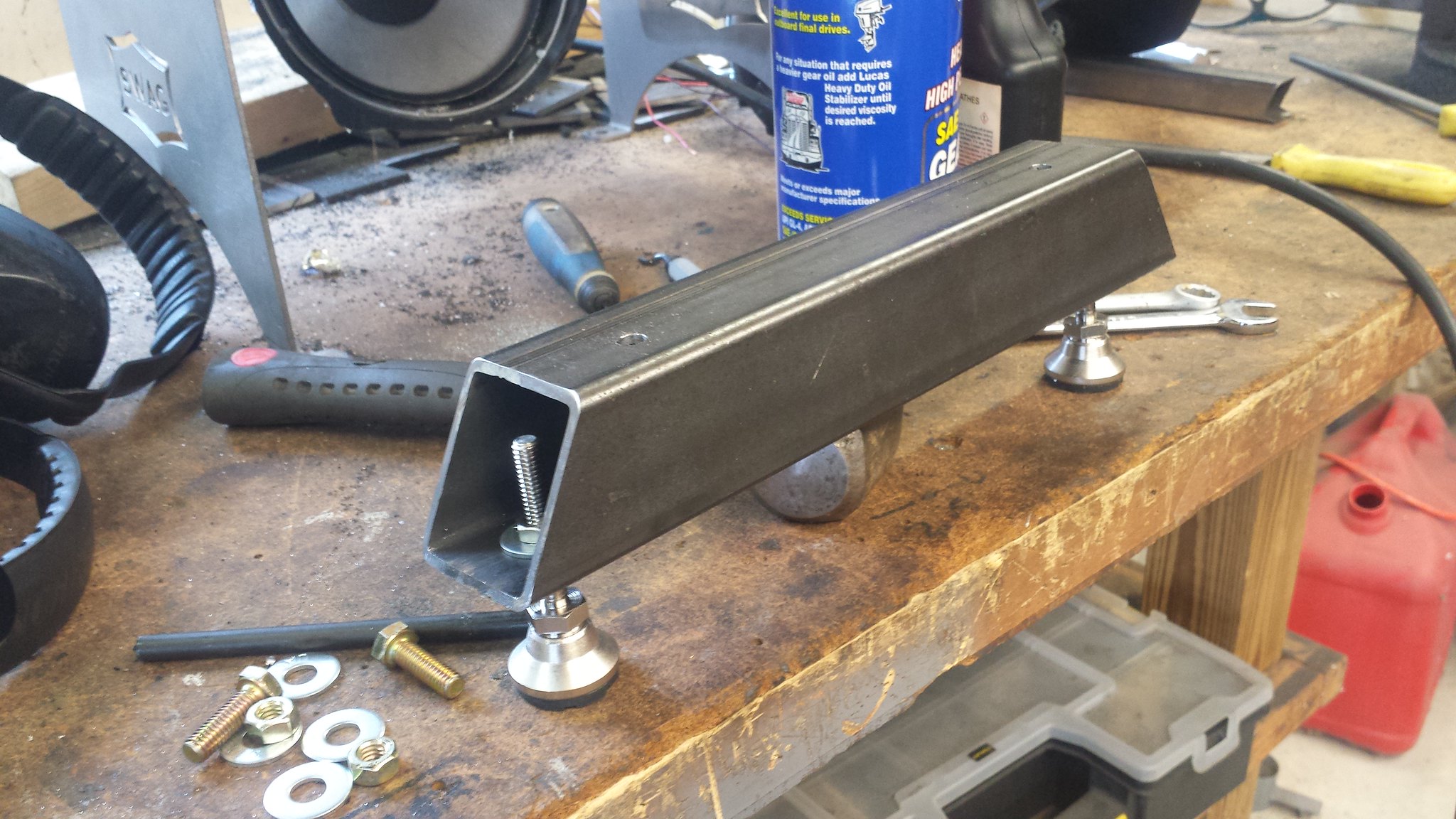

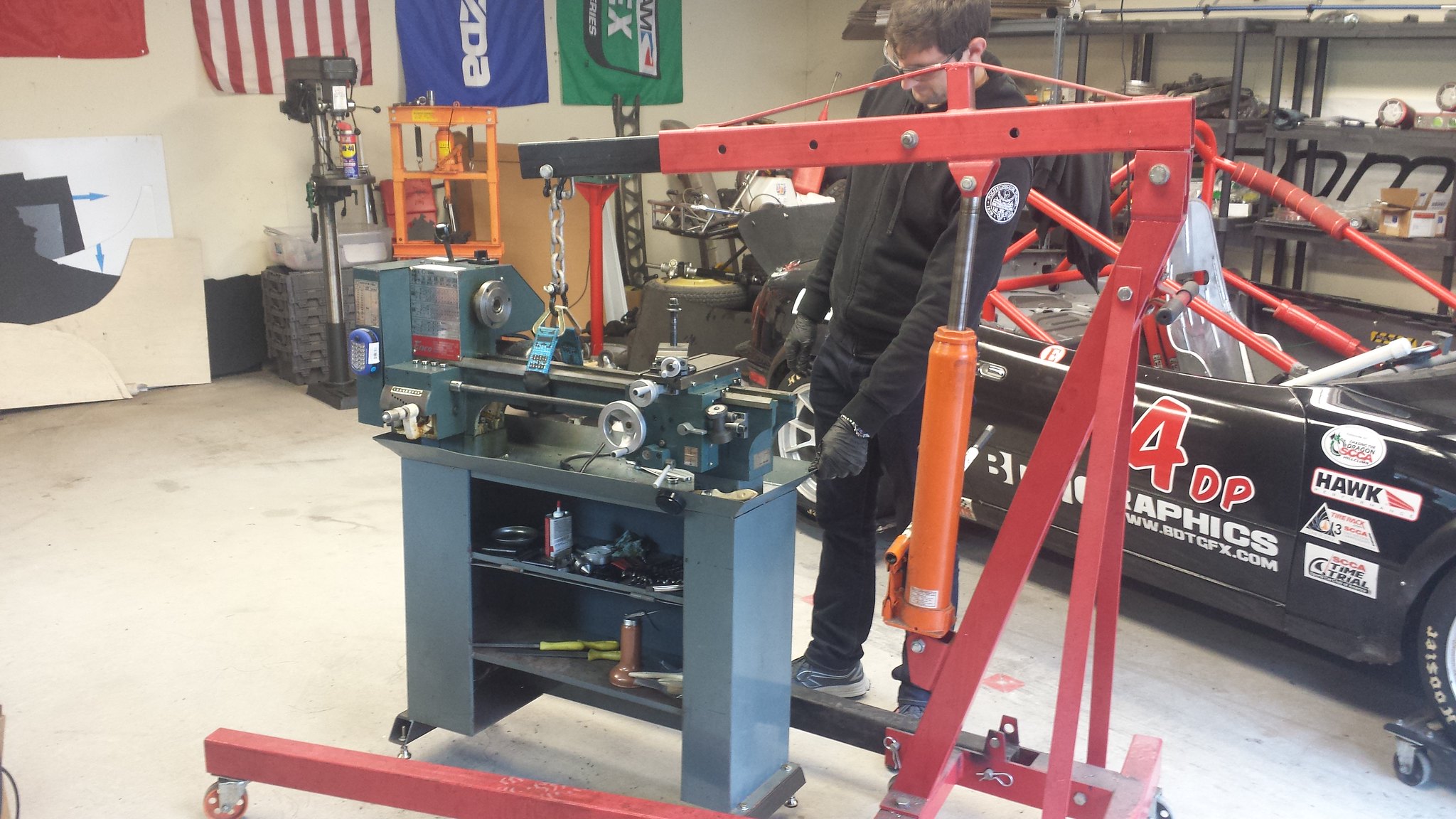

We also made a couple of risers with machine leveling feet to go under the feet on the lathe. With the feet and risers, it's about 3" taller. And with it being already top heavy, I made the feet a few inches wider than the machine's feet to give it a better footprint.
We used the engine hoist to pick up each side to measure for the feet, and managed to find a good balance point to move it across to the other side of the garage. To get it turned to be along the wall, we just used a 2x8 under the lathe bed and muscled it into position.
I'll likely build a bit of a shelf near / around it for tool & accessory storage at some point, but for now the built in cabinet / shelf will do the job.

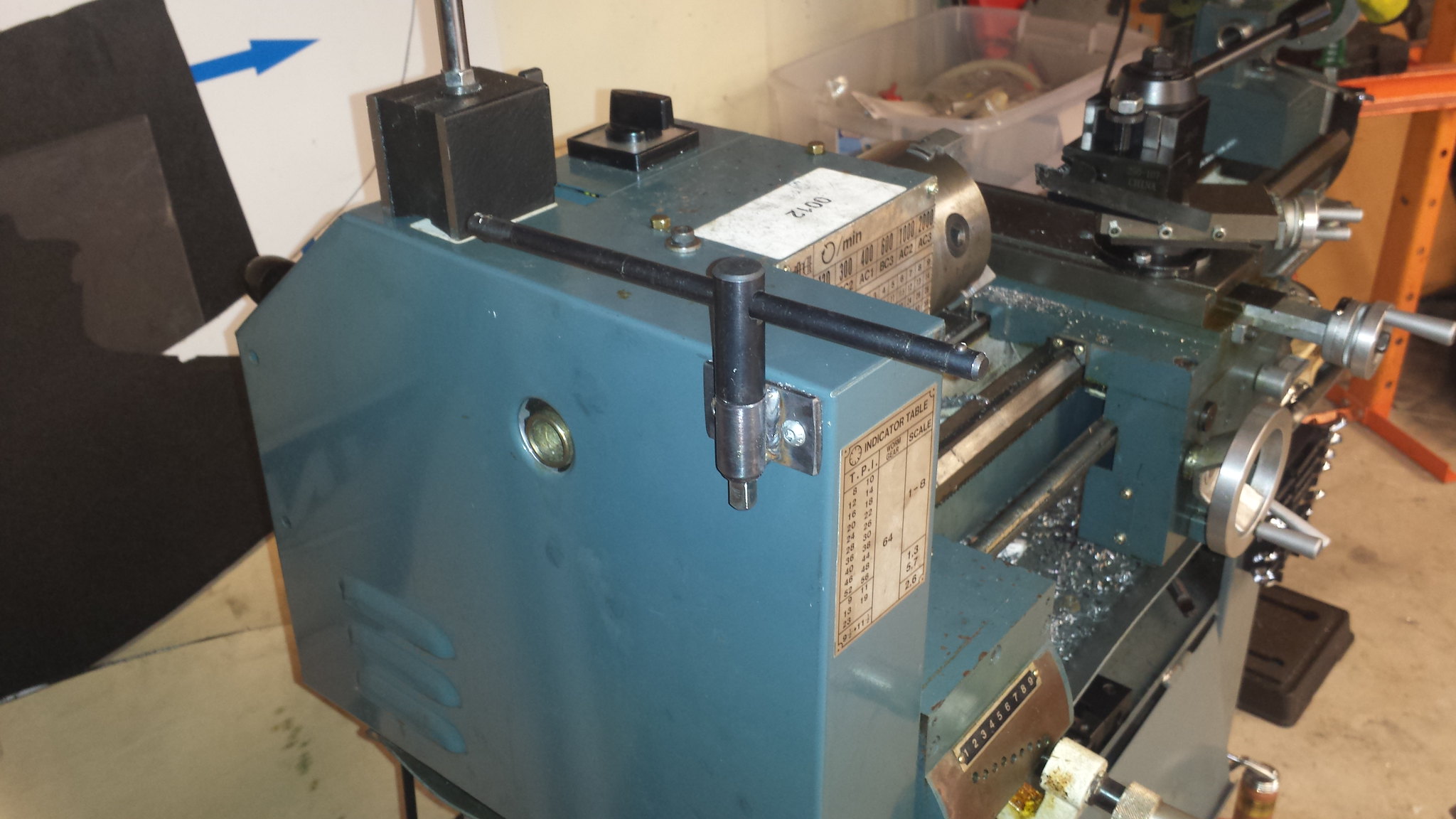

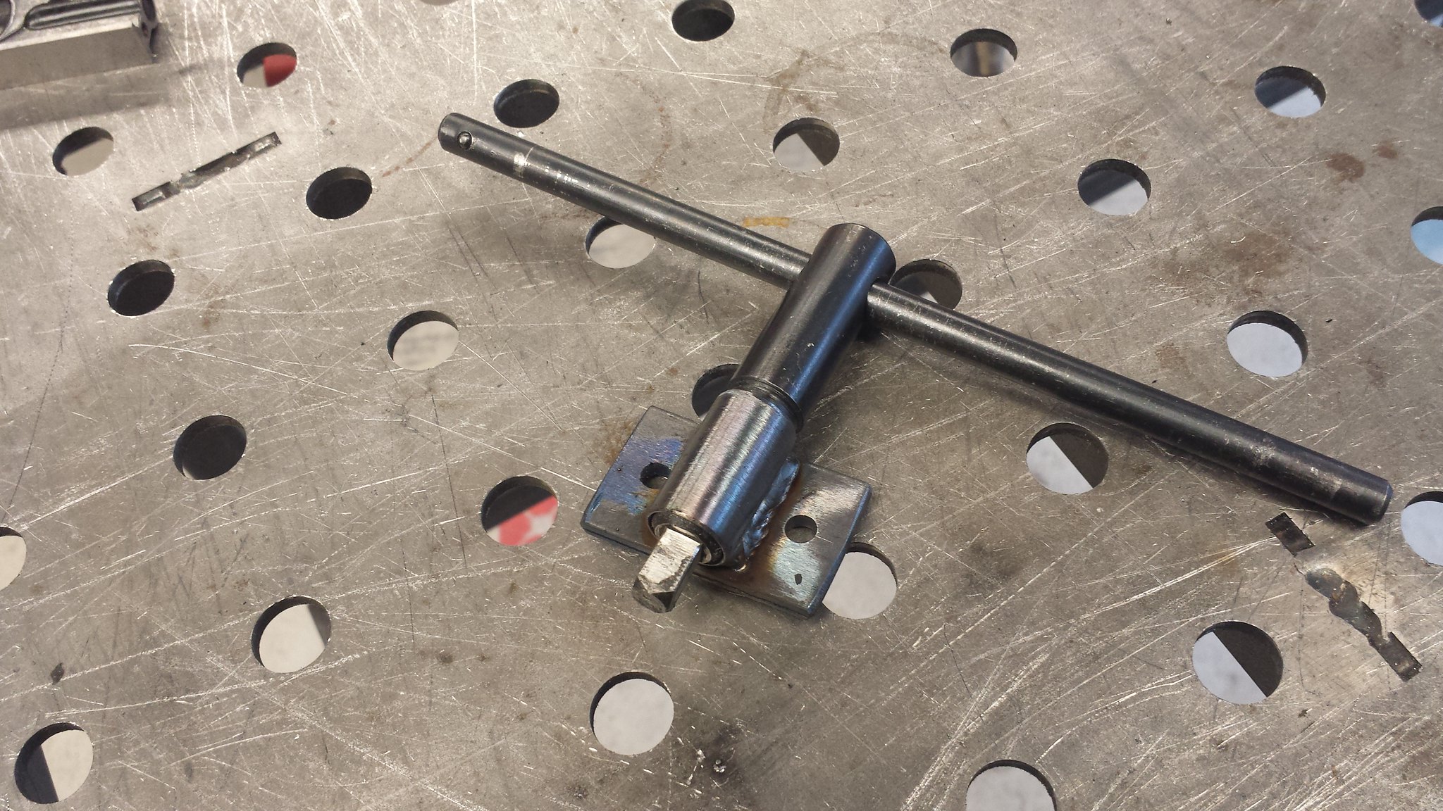

Project On Board Tool Storage begins. I got tired of CONSTANTLY fishing around for the lathe chuck key, and for the various wrenches, so now that the major work on getting the lathe running and in place is done, it's time to exorcise a few of the niggles.
The wrench set I got for the lathe has a nice little holder already, it just needed to be put somewhere more convenient, so I bolted it to 1 side of the cabinet. The missing wrench is the 12mm that basically lives on the tailstock:
The sleeve for the chuck key was turned on the lathe, then I made a bracket and glued it together. No more fishing around for the key :D
