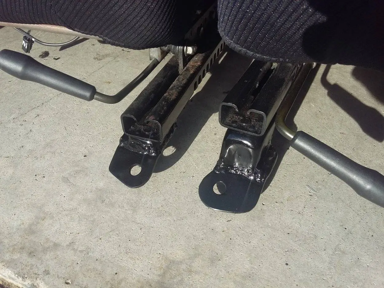

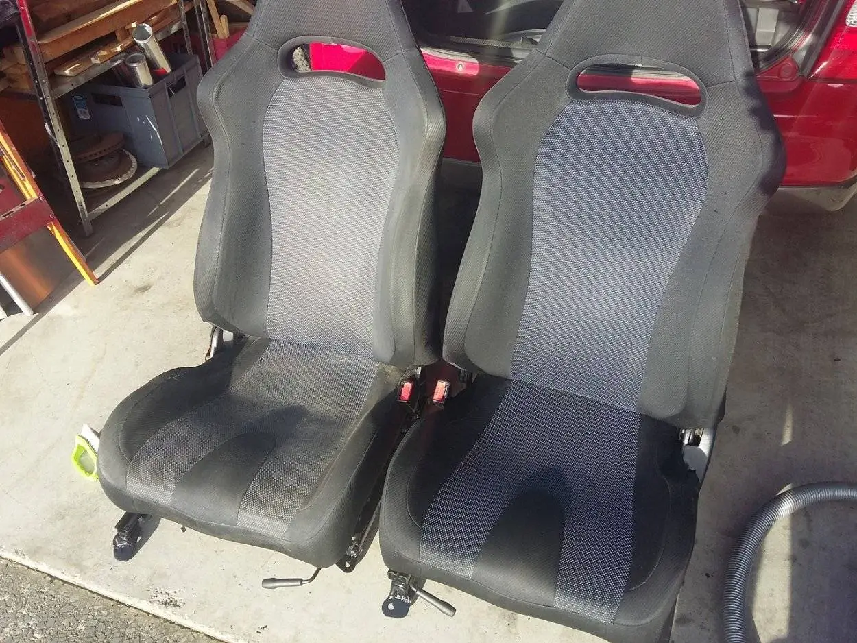

- modify the seat bases so there's more material around the bolt holes and they actually line up better. Wasn't expecting them to take the seats out and those WRX seats are a proper pain to get back in. Also need to helicoil at least one bolt hole as it's a bit stripped. I might take the chance to level out the seats while I'm there but need to run that past the certifier first.
Not a huge list and nothing really major or serious to fix. The certifier was impressed by it being a bit different and loved the rear seat panels! I've got 60 days to fix everything which should be do-able.

The inner front mounts required the most work, I cut the factory mount off and added a new plate. The outer front mount got a plate as well to cover up the giant slot from the original fitting. Rear mounts just got big washers, and shiny new hardware all round.
Funnily enough the inner mounts aren't the same side to side, the passengers side (rh) is offset further outwards by 5mms. I think that's the seat design rather than the car. :)
Also deep cleaned the seats, LH is the dirty drivers seat, RH is the cleaned passengers seat! Such a difference in colour, these things were dirty!

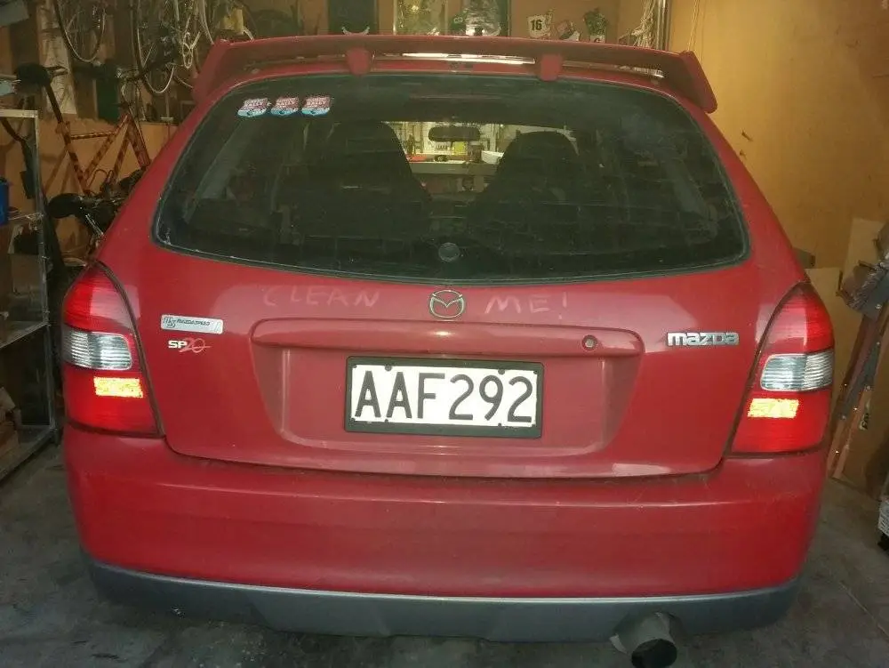

Car is now certified! Wooohoo! Waiting on some official paperwork and a final warrant of fitness check, then it's fully road legal! Replaced the o2 sensor and it's all running good now
Managed to get three familias in a row in a car park

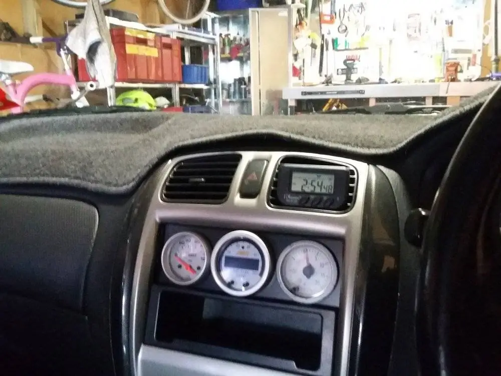

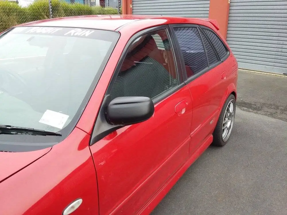

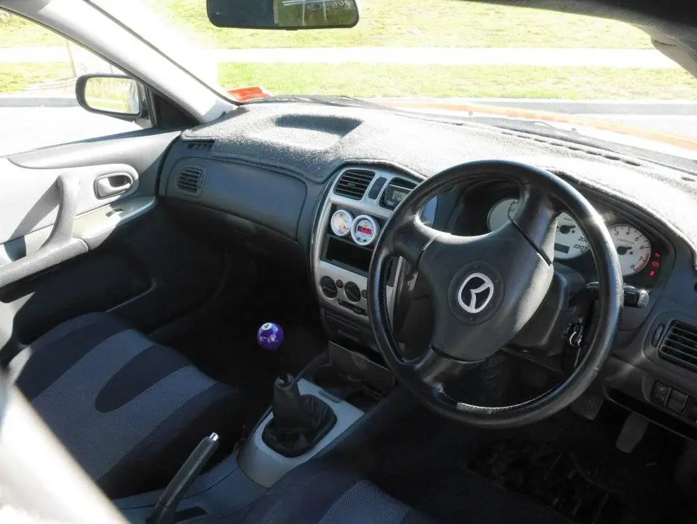

Mounted a cheap clock in the drivers air vent, used a spare vent and cut the grille out so the clock fits in nicely and at a good angle for viewing. I'd love a backlit clock for night driving so this'll probably change once I find one at the wreckers
Also wrapped the wing mirrors with some black vinyl, the paint was getting pretty manky and I've seen black mirrors on another pro5 that looked neat.
Not 100% on them yet, what do you all reckon?

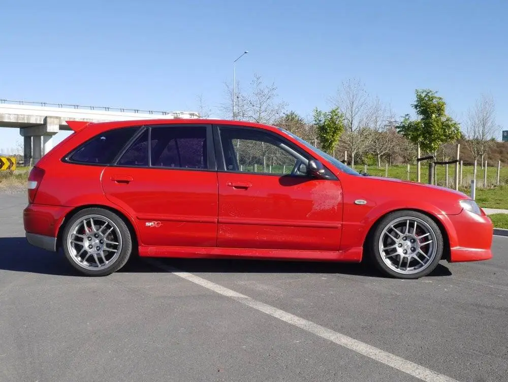

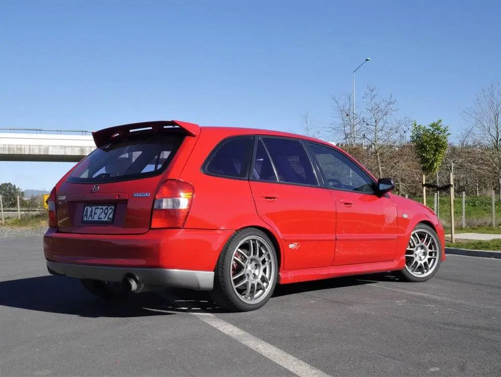

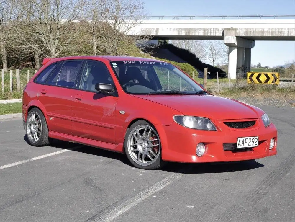

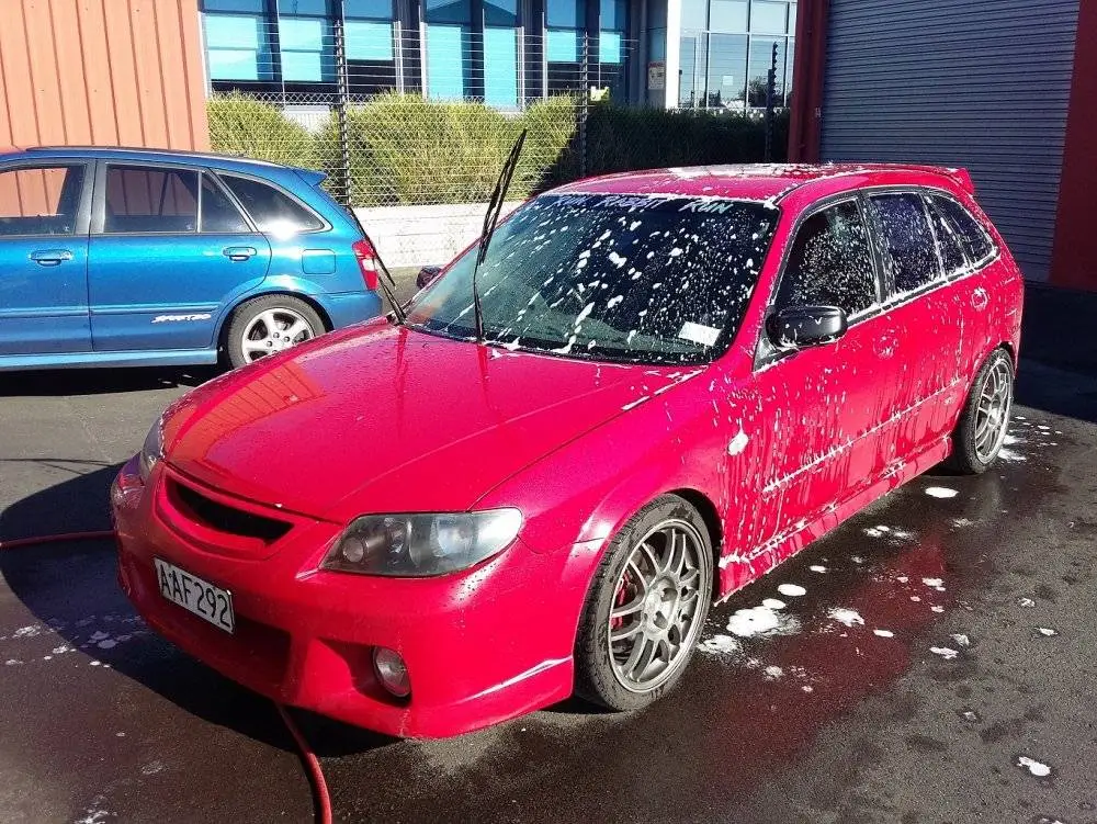

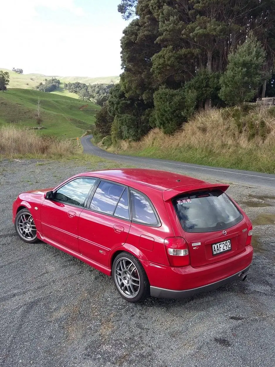

The sun is finally shining so I gave this poor thing a bath

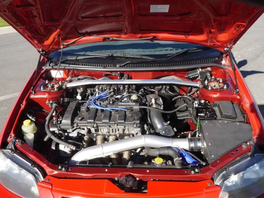

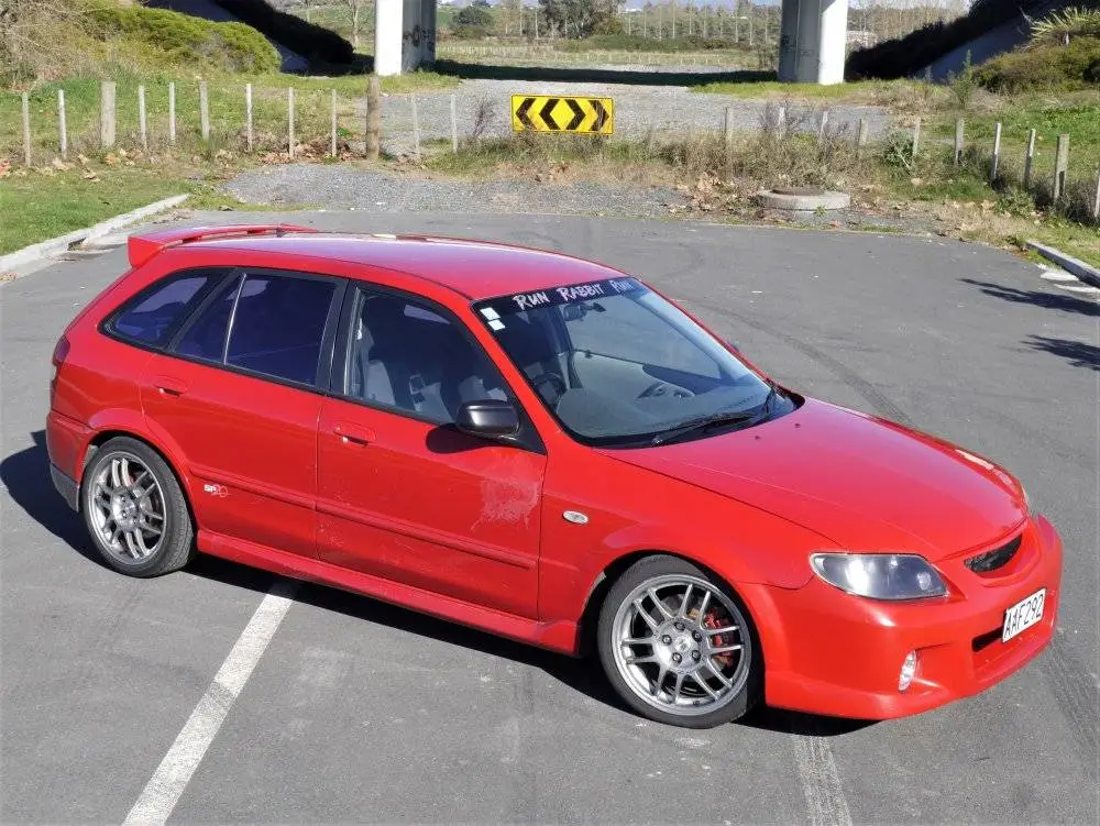

And busted out the proper camera for some nicer photos

Really enjoying the car as it sits now, but that doesn't mean it's finished!
Things I need to do:
- Install an alarm
- Get it on a dyno for a proper tune
- Replace the rear tyres
- Figure out how to cut the boost back a bit, 8-9 psi is fun but I don't really want to rebuild this motor just yet. Fun fact, FS-DE engines are harder to find than FS-ZE engines here! There's so many JDM familias and only a handful of 323s around
Things I want to do:
- Revisit the spotlight cover project, maybe fibreglass this time? (oooh, maybe carbon fibre?)
- Re trim the seats with red inserts, Type R integra style
- Modify the rear strut tower trim pieces to get rid of the seatbelt holes for that factory look
- Eventually sort this paint out, it's super rough and patchy. I'd love to do the whole car in Zeal red like the engine bay but that'd take some serious cash to do properly.
- Remove the rear window regulators for added lightness
I'm tossing up whether to swap all the doors over to manual windows and mirrors, for that WRX Type RA feeling, the base model Laser variant has manual windows and I think they'll be a straight swap over. Also want to swap the mirrors to either OEM manual versions or aero type aftermarket mirrors from a S15 / civic. Any thoughts?

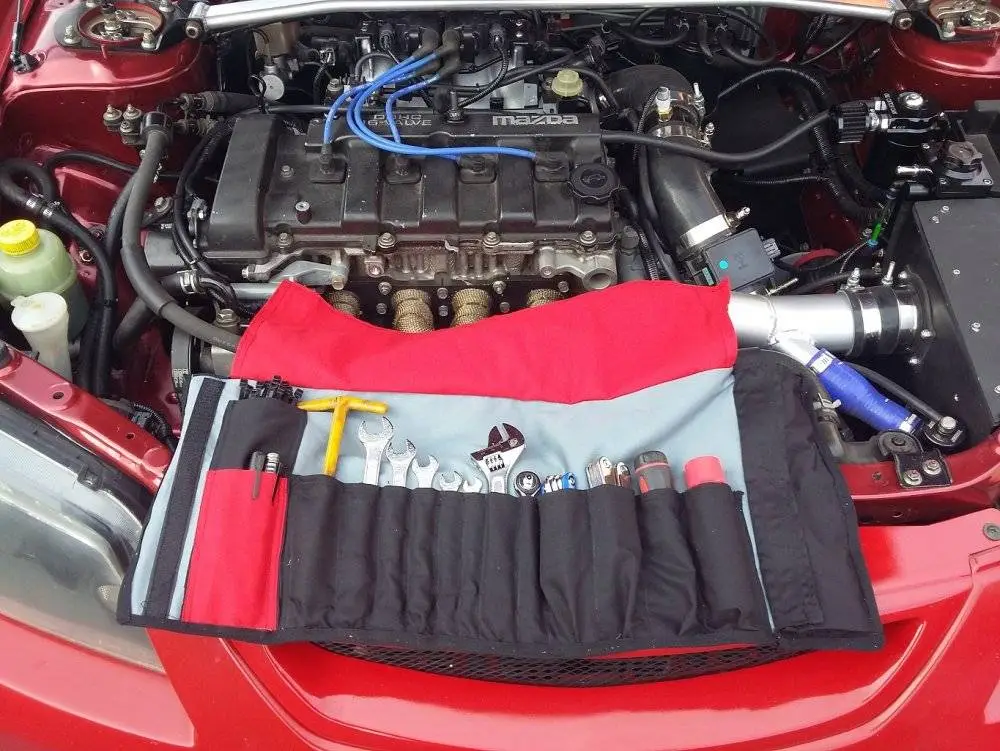

Something slightly different now;

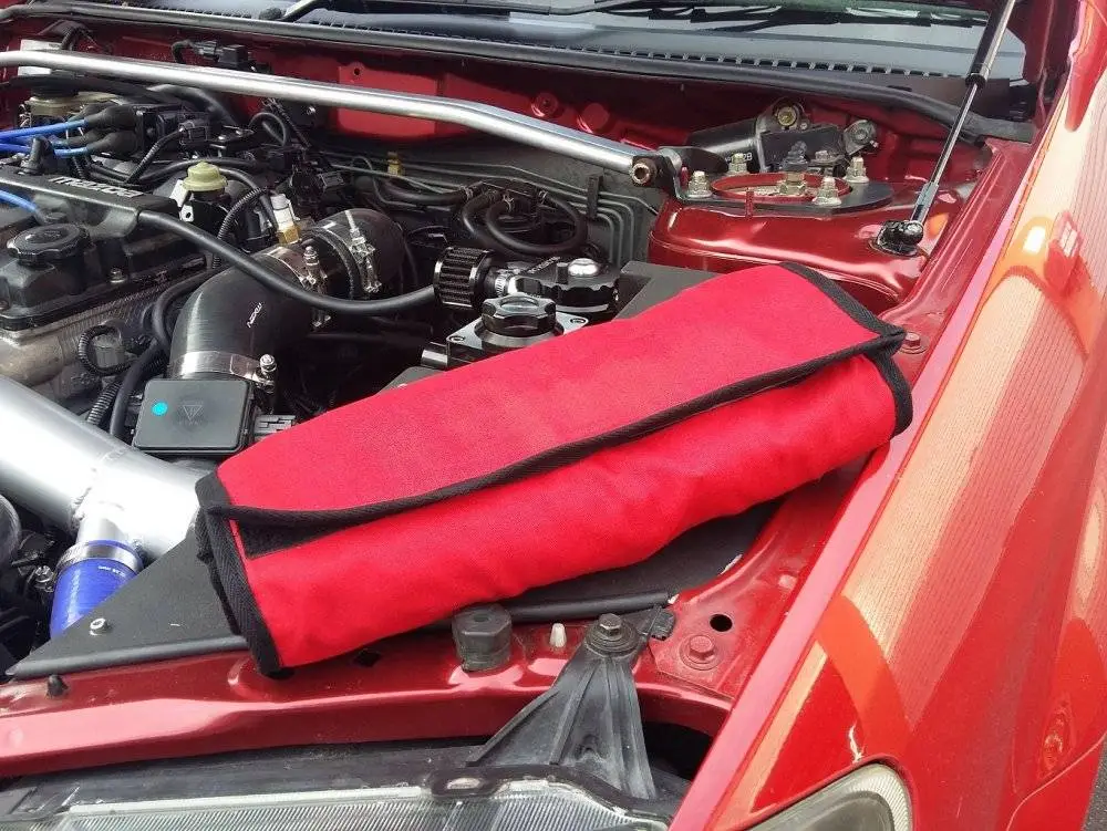

I wanted some kind of tool storage for this car, just for a small amount of tools for roadside repairs, but didn'twant to pay $50 for a off-the-shelf box or roll
So I busted out my old Singer sewing machine and made one!
If you want to improve accuracy in fabrication, try a sewing project! Working with fabrics is super tricky when you're used to wood and metal but it still requires accuracy and patience to get a nice result.
This is 70x30cm of heavy duty fabric, with a few pockets for small things and dedicated slots for a screwdriver, multi-tool and spanners, perfect!
It now lives under the rear seat cover along with a jack, brace and warning triangle, all stuff I hope I never have to use, but is there just in case.
This was a fun little side project for a few weekends, it's always good to do something different!
