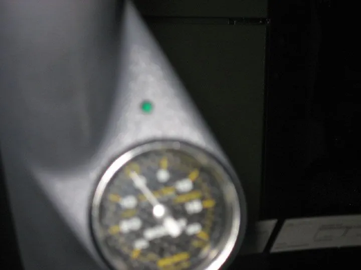

i like the green led. since the pump doesn't make any noises, its nice to have the light to let you know when the pump switches on/off and starts/stops pumping. i have mine hooked up to my microtech, set to turn on when its at least 3000rpm and 8psi, and it appears to turn on exactly where it supposed to.

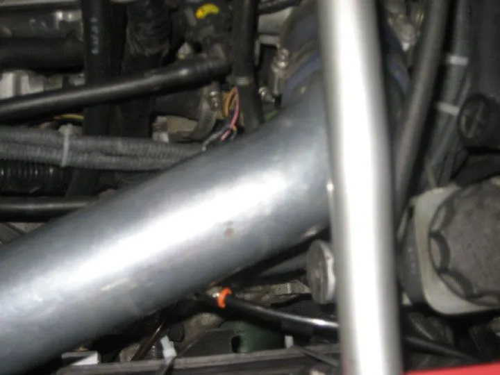

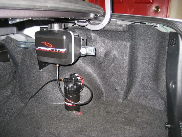

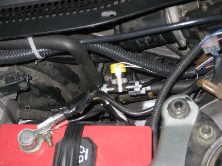

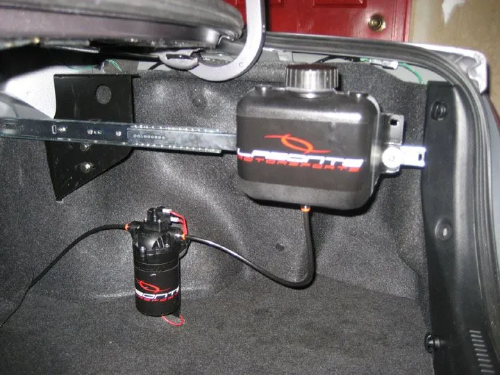

pictures of the ISG-10 system installed in mine...
Lookin' good. That solenoid is in-line with the fluid hose, correct? I can't tell from the pics. I'm just wanting to make sure.
i don't have the the Labonte Controller, im using one of my Microtech Aux-Outputs to activate the pump based on a preset rpm & map pressure.
yes between the pump and injector nozzle as instructed. its about 12-18 inches from the injector nozzle. i figured it'd be best mounted closest to the nozzle for the quickest response.
Awesome. I just wanted to make sure. That sounds perfect. I'm glad you're liking it so far. When you tune for it, it'll be that much better.
