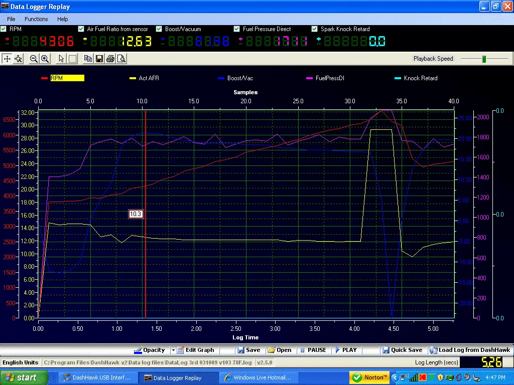

Stage1+SF 93 Octane V103 on my 09 MS3 with the Cobb SRI, and seeing KR at WOT. During this run I actual heard the pinging. Any permanent damage done? What should I do?

Could be a bad tank of gas. When I first switched over to the 93-octane maps, I made sure to run a couple of tanks first to ensure I only had 93 in the tank before I went WOT.
I am seeing a knock of 1-2 when i go WOT from 2k in 3rd and 4th gear. Should i get new plugs?
And what kind should i get? and does it effect anything else
you should not run the ap without one-step colder plugs (denso itv-22 work best) and you should not load up your car from below 3k rpm.
Alright solved, I just ordered the new plugs, i needed to install something anyways, because i was getting board.
How many miles did you have on this map when you made the logs?
Just did a 3rd gear run and everything looks fine.
Car runs like a ***** ape.

100-150 miles on the map, 1000ft elevation, 70 degrees F. I just put in the denso's tonight and reset the ecu. We'll see if it fixes it. I'm in the process of replacing the bad factory clamps all around as well.
Any update with this? Did the colder plugs help out? Please post Datalogs of new results.
