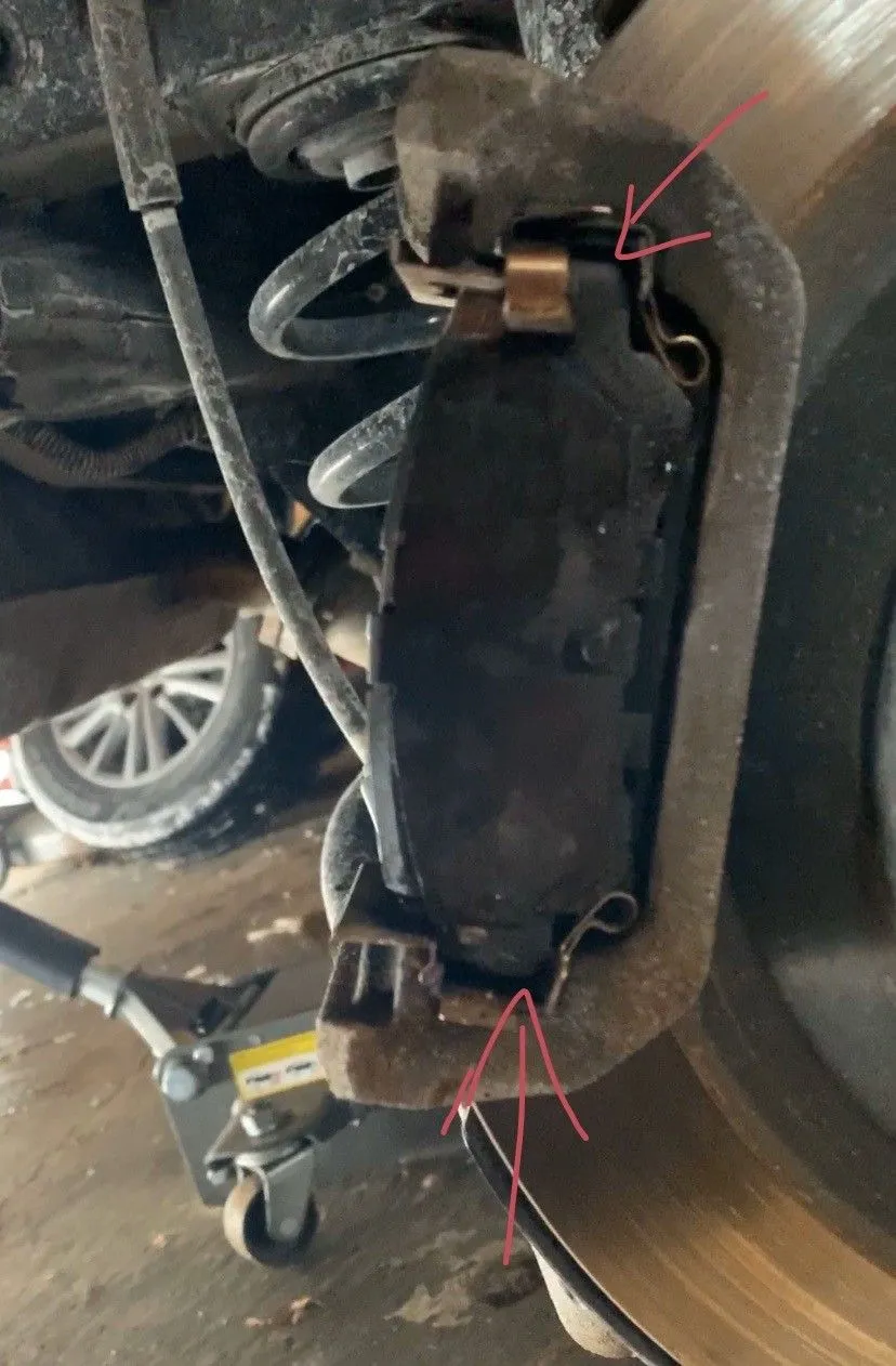

Hello all, I know its been awhile but I just wanted come back and update.
The noise was not related to the suspensions. I got sick and tired of dealing with the dealership so I took the time to investigate the problem myself. The problem was the brake pads....how? well apparently the brake pads the dealership installed into the calipers were not the correct brake pads. It does have a MAZDA stamp on the pads and it also do fit into the caliper bracket but does not seat in properly meaning it was just sitting on the pad pins. Those dark areas are open. So during braking or hard braking the pads would shift up or down and hit the bracket causing a loud thump noise....after replacing the pads not a single noise when braking.....im glad I didnt bring this back to the dealership they will probably put the same pads back in and tell me they dont see anything wrong...
I feel like I'm only getting part of the story here. Have you dealt with this particular dealership before? Or is this just a general attitude you have towards dealerships in general? The reason I ask is because you mention dealing with headaches and BS, but it isn't clear if the headaches and BS came from this dealer or not. Were the pads in the picture the original brake pads?
Thanks for the update and fix. Doubt this is a common problem when using OEM replacement parts. I have heard that there are techs that will grind the ears of a brake pad to make them fit inside the shims and bracket. But why the ends of the ears and why with OEM pads? I'm sure we will never know the story.
